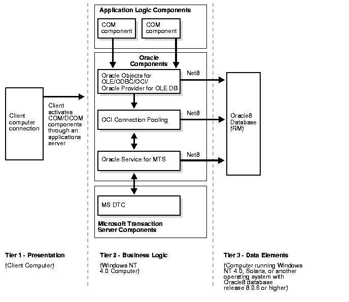

When a client computer initiates a transaction request, Microsoft Transaction Server enlists the Oracle8 database to act as a resource manager (RM) in the transaction process. The focal point of the transaction process is a component of Microsoft Transaction Server called Microsoft Distributed Transaction Coordinator (MS DTC). The figure and table below provide an overview of how these and other components perform a transaction:
See the Microsoft Transaction Server Programmer's Guide in the Microsoft Transaction Server's Help file for an explanation of how to develop application components for Microsoft Transaction Server.
Regardless of the application program interface (API) you use, OCI connection pooling is used in nearly all cases to coordinate a transaction. Review the following sections for information on how a transaction is registered and OCI connection pooling is used to coordinate your transaction:
Application components that run in the Microsoft Transaction Server environment are created as dynamic link libraries (DLLs) that are registered with Microsoft Transaction Server using the Microsoft Transaction Server Explorer graphical user interface (GUI) tool. When you register the application component, you mark it as one of the following:

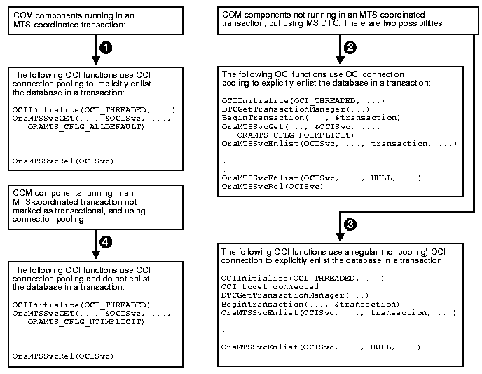

This illustration provides a high-level overview of how to use the OCI functions OraMTSSvcGet(), OraMTSSvcRel(), and OraMTSSvcEnlist().
Non-COM applications (also known as standalone applications) can also use methods 2, 3, and 4 above. However, non-COM applications cannot use the Microsoft Transaction Server Explorer GUI. Method 3 can also use OraMTSSvcEnlistEx() instead of OraMTSSvcEnlist() for better performance.
