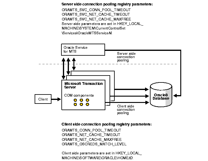

When a COM component ends a session with the Oracle8 database, the connection by default does not immediately terminate. Instead, the connection remains idle in a connection pool, where it is available for reuse by another COM component attempting a new connection to the Oracle8 database.
The idle period during which a connection can be reused reduces the resource costs associated with opening a new connection. The amount of time that the connection remains idle and available in the connection pool is determined by several registry parameter settings that you can modify on the computers on which the client Microsoft Transaction Server components and the Oracle Service for MTS are installed. The Oracle Service for MTS uses a similar connection pool. The connection pool is located in two places:
The following illustration identifies the connection pool locations and the registry parameters associated with each pool:
This table describes the client side registry parameters that you can modify to manage connection pooling:
This table describes the server side registry parameters that you can modify to manage connection pooling:
To edit the connection pool registry settings:
| For... | Log on to the computer where... |
Server side parameters |
Oracle Service for MTS is installed |
Client side parameters |
Client Microsoft Transaction Server components are installed |
C:\> REGEDT32

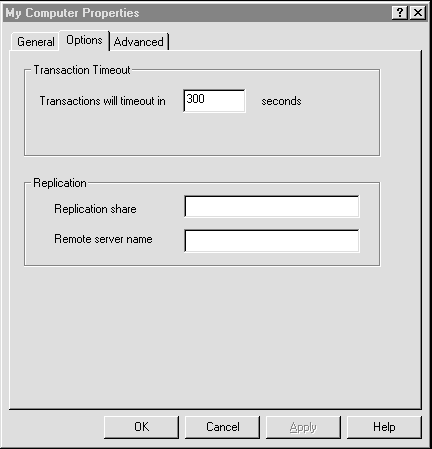

If your transaction requests are timing out before completing, it may be because the transaction timeout parameter is set too low. Increase the transaction timeout parameter to ensure that your transactions have sufficient time to complete.
To increase the transaction timeout parameter:
The Microsoft Management Console appears.
A menu appears with several options.
The My Computer Properties dialog box appears.
The transaction timeout value is increased. For most environments, 60 seconds may be sufficient. However, if your transaction is competing with numerous concurrent transactions, this value may be too low.
