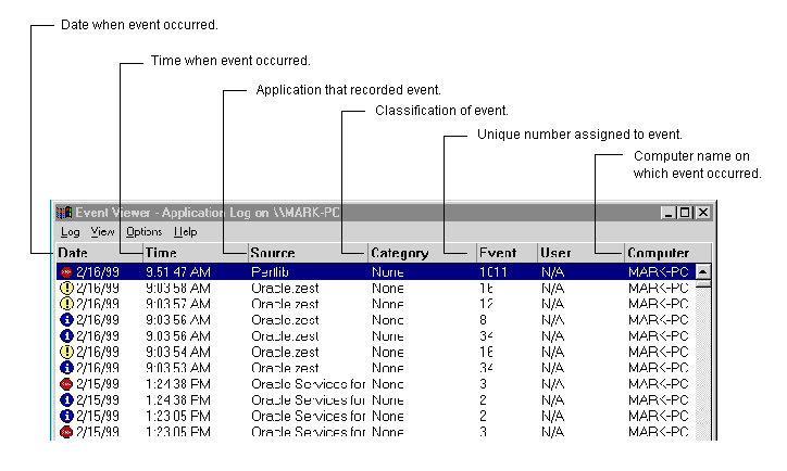

Oracle Service for MTS problems and other significant occurrences are recorded as events. These events are recorded in an application event log. View and manage these recorded events in the Event Viewer. The types of events displayed include:
To access the Event Viewer:
The Event Viewer window appears.
The Application view displays the following information:
The icons beside each event determine the type of event:
The Oracle Service for MTS events display with a source of Oracle Service for MTS. Oracle Service for MTS consists of the following event IDs:

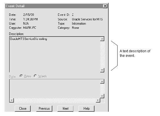

To use the Event Viewer:
The Event Detail dialog box appears with more information about the selected event:

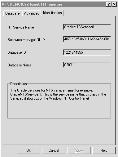

The Oracle Manager for MTS Services snap-in includes an Identification tab in the Oracle Service for MTS Properties dialog box that enables you to view information that can be useful when debugging problems with Oracle Support Services. Note that none of the information in the Identification tab can be changed.
To view configuration information:

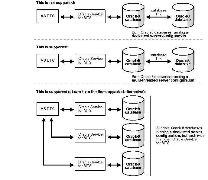

Question: How do I design an application when I have multiple Oracle8 databases?
Oracle Service for MTS does not support the use of database links between Oracle8 databases running in dedicated server configurations. As alternatives, the Oracle Service for MTS supports using database links in a multi-threaded server environment or providing each Oracle8 database with its own Oracle Service for MTS in a dedicated server environment. This figure illustrates these alternatives:
