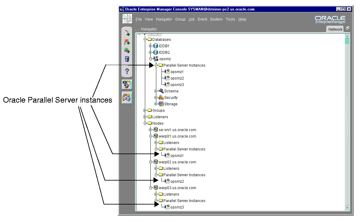

Displaying Oracle Parallel Server Objects in the Navigator Window
From the Navigator window, you can view and manage both single- and multiple-instance databases. The information available for Oracle Parallel Servers is the same as for single-instance databases.
The Navigator displays all the network objects and their relationships to other objects including a direct view of objects such as user-defined groups, nodes, listeners, servers, databases, and database objects.
From the Navigator window, Oracle Parallel Servers are located in the Databases folder which contains entries for single-instance and Oracle Parallel Server databases. Each Oracle Parallel Server folder contains the instances and sub-folders for schema, security and file storage.
If you did not set preferred credentials for the database, as described in "Task 4: Specify Preferred Credentials for Nodes and Oracle Parallel Server Database", the Database Connect Information dialog prompts you to enter database connect information.
An Oracle Parallel Server database's subfolders behave just as they do for single-instance databases. By right-clicking the mouse on these objects, property sheets can be accessed to inspect and modify properties of these objects just as for single-instance databases. For example, right-clicking on the Redo Log Groups folder and choosing Create can add a new redo log group.
The Oracle Parallel Server database and each discovered Oracle Parallel Server node contains a Parallel Server Instances folder that you can expand to display the instances belonging to the database or node.

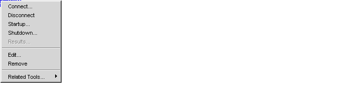

Using the Right-Mouse Menu
Right-clicking on a Oracle Parallel Server database displays the Oracle Parallel Server right-mouse menu:
This menu contains entries for the following functions:
Option  Description
Connect
Connects to the database. In the Database Connect Information dialog box, enter the database user name, password and privileges. If you want to perform a startup or shutdown, you must specify a user with SYSDBA privileges.
Disconnect
Terminates a connection to the database
Startup
Starts the database
See Also: "Starting an Oracle Parallel Server Database"
Shutdown
Shuts down the database
See Also: "Shutting Down an Oracle Parallel Server Database"
Results
Displays startup and shutdown results
See Also: "Viewing the Parallel Server Operation Results".
Edit
Allows inspection of the state of the Oracle Parallel Server, including which instances are active.
See Also: "Viewing Oracle Parallel Server Status"
Remove
Deletes the database object and its related services. This should only be performed if it is no longer necessary to monitor or manage a database from Oracle Enterprise Manager.
Related Tools
Contains access to other tools which have been enabled for Oracle Parallel Server

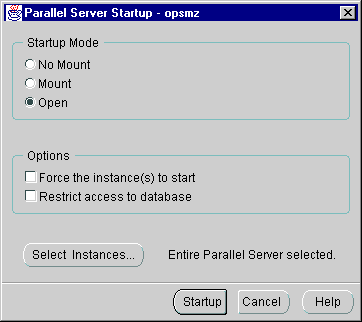

    The Parallel Server Startup dialog box appears.
  4. Select the startup type:
    Option   Description
    No Mount
    Does not mount the database upon instance startup
    Mount
    Mounts a database but does not open it
    Open
    (default) Opens the database
    Force the instance(s) to start
    Shuts down the currently running Oracle instances with the SHUTDOWN mode, ABORT, before restarting them. If the instances are running and FORCE is not specified, an error results.
    Warning: You should not use the FORCE mode under normal circumstances. Use the FORCE mode only while debugging and under abnormal circumstances.
    Restrict access to the database
    Makes the started instances accessible only to users with the RESTRICTED SESSION system privilege. Users already connected are not affected.

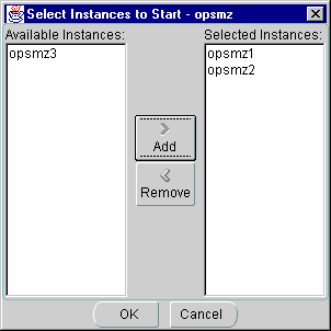

  5. If you want to start up all instances, click Startup. If you want to start up only selected instances, follow these steps:
    1. Select Instances.
      The Select Instances to Start dialog box appears:
    2. Select the instances to start up in the Available list, then click Add.
    3. Click OK to close the Select Instances to Start dialog box.
    4. Click Startup from the Parallel Server Startup dialog box.

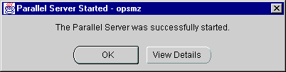

    The Parallel Server Startup Results dialog box displays the progress of the startup operation, as described in "Viewing the Parallel Server Operation Results".
    If the instances were started successfully, the Parallel Server Started message box appears with a successful message:
    Click OK in the Parallel Server Started message to acknowledge the message, then click Close in the Parallel Server Startup Results.
    If the startup fails, the Parallel Server Started message box appears with a failure message. Click View Details to view more information in the Parallel Server Startup Results dialog box about why the startup failed, then click Close.

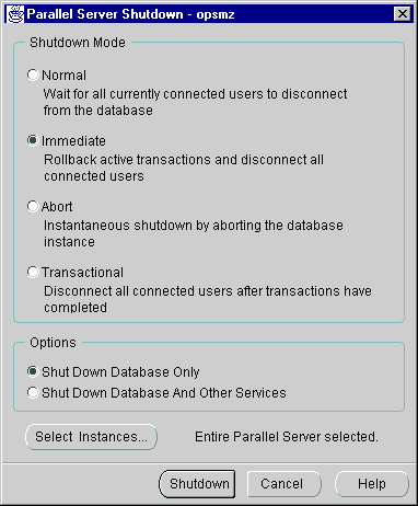

    The Parallel Server Shutdown dialog box appears.
  4. Select the shutdown type:
    Option   Description
    Normal
    Waits for the currently connected users to disconnect from the database, prohibits further connects, and closes and dismounts the database before shutting down the instance. Instance recovery is not required on next startup.
    Immediate
    (default) Does not wait for current calls to complete, prohibits further connects, and closes and dismounts the database.The instance is immediately shut down. Connected users are not required to disconnect and instance recovery is not required on next startup.
    Abort
    Proceeds with the fastest possible shutdown. Connected users are not required to disconnect. The database is not closed or dismounted, but the instances are shut down. Instance recovery is required on next startup.
    Warning: You must use this option if a background process terminates abnormally.
    Transactional
    Waits for transaction to complete before shutting down
    Shutdown Database Only
    (default) Shuts down the database only. The services required for an instance, such as the listener, remain up and available.
    Shutdown Database And Other Services
    Shuts down the database and associated services, such as the listener
  5. To shut down all instances, click Shutdown.

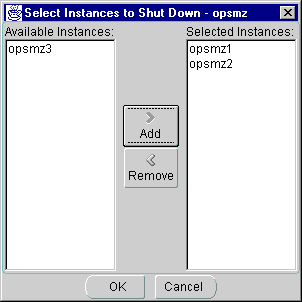

    To shut down only selected instances, follow these additional steps:
      The Select Instances to Stop dialog box appears:
    2. Select the instances to stop in the Available list, then click Add.
    3. Click OK to close the Select Instances to Stop dialog box.
    4. Click Shutdown from the Parallel Server Shutdown dialog box.

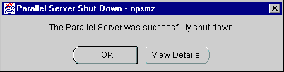

    If the instances were shut down successfully, the Parallel Server Stopped message box appears with a successful message.:
    Click OK in the Parallel Server Stopped message to acknowledge the message, then click Close in the Parallel Server Shutdown Results.

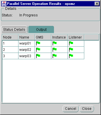

Status Details Tab
This tab is not available for Windows NT Oracle Parallel Servers, because OPSCTL on Windows NT does not generate status details.
While a startup or shutdown operation is running against an Oracle Parallel Server, the Status Details tab progress display is shown and updated dynamically as the operation progresses.
A successful startup operation for a three-node cluster looks like the following in the Status Details tab:
The services managed by Oracle Parallel Server Management vary by operating system and by version. The Oracle Parallel Server being managed in this example is release 8.0.5, so the GMS (Group Membership Service) is being started. In release 8.1, the GMS is built into the RDBMS kernel, so only the instance and listener columns display.
A successful shutdown operation for a three-node cluster looks like the following in the Status Details tab:
The following are the possible states that each component may experience:
State  Description
Up (green flag)
The component is running.
Down (red flag)
The component is not running.
In Progress (timer)
Oracle Enterprise Manager cannot determine the state of the component. This state occurs typically when the component startup or shutdown operation has not completed.
Component does not exist on this node (blank background)
The component was not configured on the node.
Not all components (listener, instance) are required on every node.

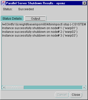

Output Tab
The Output tab displays the commands executed by the Oracle Parallel Server node and any associated error messages in textual format.
A successful startup for a three-node cluster looks like the following in the Output tab:
A successful shutdown operation for a three-node cluster looks like the following in the Output tab:

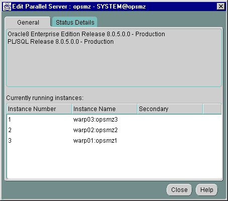

The Edit Parallel Server dialog box displays status information about the Oracle Parallel Server database, such as instances available in the Oracle Parallel Server and status of Oracle Parallel Server components.
Because this dialog box requires a connection to an Oracle Parallel Server, this dialog box will not appear if the Oracle Parallel Server is down.
To view status information about an Oracle Parallel Server database:
  1. In the Navigator window, expand Databases > database_name.
  2. Right-click on an Oracle Parallel Server database under the Databases folder in the Navigator window.
    A menu appears with options for the database.
  3. Choose Edit from the menu.
    The Edit Parallel Server dialog box appears.
The operation results are presented in two views:
General Tab
The Status tab displays information about the currently running instances by querying V$ACTIVE_INSTANCES table. Oracle Enterprise Manager makes a connection to the Oracle Parallel Server; therefore, this tab will not appear if the Oracle Parallel Server is down.
Column Name  Description
Instance Number
Identifies the instance number
Instance Name
The name specified for the instance and the node it is running on. This name has the following format: node:instance_name.
Secondary
Indicates if the node is an secondary instance in a primary and secondary instance configuration

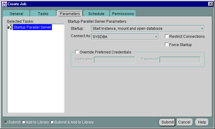

Creating a Job for a Parallel Server or Parallel Server Instance
The job scheduling system provides a highly reliable and flexible mechanism for DBAs to schedule and automate repetitive jobs on both the Oracle Parallel Server database and Oracle Parallel Server instances.
The Console contains a full-featured scheduling tool that allows DBAs to develop a customized schedule. This provides DBAs with actual "lights out" management capability so the DBAs can focus on other tasks. A rich selection of jobs is provided for Oracle Parallel Servers.

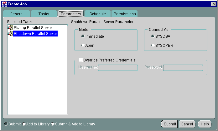

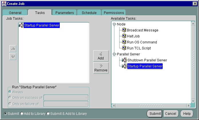

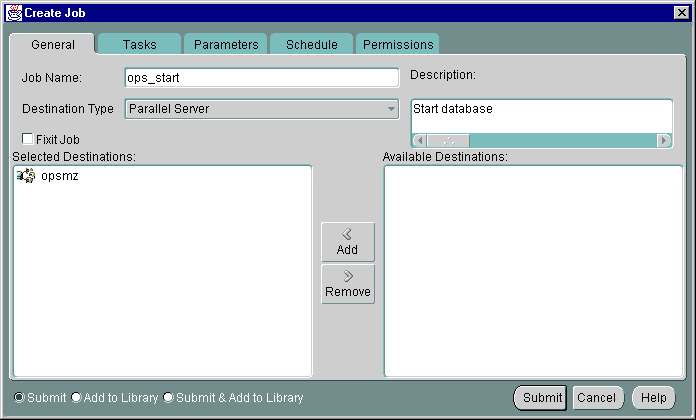

You can create a job with an Oracle Parallel Server database or an Oracle Parallel Server instance as the destination. To create a new job, follow these steps:
  1. Choose Job > Create Job.
  2. Complete the tabs of the Create Job property sheet.
  3. When you are satisfied with your job settings, click the Submit button to submit the job to Oracle Intelligent Agent. The job appears in the Active Jobs window.
  4. Click the Save button to save the job. The job appears in the Job Library window. You can modify or submit a saved job at a later time.
    Note: :
    There is usually a slight delay between submitting the job and notification by Oracle Intelligent Agent.
Specifying Job Details
From the Create Job property sheet, you can specify the details of a new job. The Create Job property sheet contains these tabs:
Tab  Description
General
Specify the job name, description, destination type, and destination.
Tasks
Choose the task(s) that you want the job to perform.
Parameters
Set the run-time parameters for the tasks. The parameters that appear on this tab depend on which task(s) you chose on the Task list box.
Schedule
Schedule the time and frequency you want Oracle Enterprise Manager to run the job.
Permissions
Specify the administrator to perform the job.
The following tabs contain Oracle Parallel Server-specific options:
General Tab
From the General tab, specify the:
The General tab contains these options:
Parameter  Description
Job Name
Enter the name of the new job.
Description
Enter a description of the job.
Destination Type
Select a destination type from the drop-down list box. You can select from the following options: parallel server, parallel server instance, database, listener, or node.
Available Destinations
The destinations are determined by your selection of the Destination Type. The destinations include parallel servers, parallel server instances, databases, listeners, and nodes.
Click the destinations of the job in the Available Destinations list, then click Add to move the destination to the Selected Destinations list. To remove a destination from a job, click the destination in the Selected Destinations list, then click Remove.
Fixit Job
Select this check box if you want to use this job as the fixit job for an event occurrence. The job cannot be scheduled.
Tasks Tab
From the Tasks tab, choose the task(s) that you want the job to perform. The list of tasks that appear is different depending on whether you select an Oracle Parallel Server or an Oracle Parallel Server instance as your Destination Type from the General tab.
Move the tasks between the Available Tasks and Selected Tasks lists with the Add and Remove buttons.
Tasks for Parallel Server Destinations
If your Destination Type is a Parallel Server, you can select from these tasks:
Tasks for Parallel Server Instance Destinations
If your Destination Type is a Parallel Server Instance, you can select from these tasks:
Parameters Tab
From the Parameters tab, you can specify parameter settings for the job tasks you selected on the Tasks tab. The parameters that display vary according to the job task. Parameters for Oracle Parallel Server startup and shutdown tasks are described below.
See Also:
Oracle Enterprise Manager Administrator's Guide for a description of parameters to set for instance tasks
Parallel Server Startup Task
When you select the Startup Parallel Server task on the Tasks tab, the following display appears:
Complete the parameters on the tab and click the Submit button to run the Oracle Parallel Server startup task.
The Parameters tab for Startup contains these options:
Parameters  Description
Startup
Select the startup modes for the job from the drop-down list box.
Connect As
Specify the role.
Only Normal is allowed for Oracle7. For Oracle8i, SYSOPER and SYSDBA roles allow you the maximum database administration privileges. You require SYSDBA or SYSOPER privileges to run job tasks such as shutdown or startup on the database.
See Also: Oracle8i Administrator's Guide for more information about SYSOPER and SYSDBA roles
If you attempt to connect as SYSDBA and do not have SYSDBA privileges, an error message states that an invalid user name or password was entered.
Override Preferred Credentials
You can use the preferred credentials that have been set up for the database, or you can enter another database user name and password.
Parameters for the Parallel Server Shutdown Task
When you select the Shutdown Parallel Server task on the Tasks tab, the following display appears.
Complete the parameter entries on the tab and click the Submit button to run the Oracle Parallel Server shutdown task.
The Parameters tab for Shutdown contains these options:
Mode
Click the Immediate button (default) or the Abort button.
Connect As
Click the SYSDBA button (default) or the SYSOPER button.
You can use the preferred credentials that have been set up for the database, or you can use another database user name and password.
