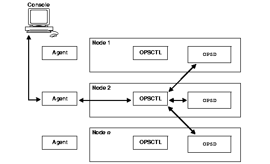

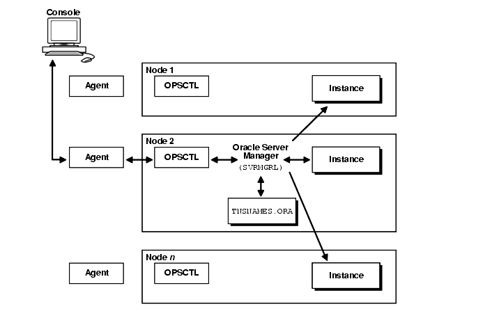

OPS Control (OPSCTL)
OPSCTL serves as a single point of control between Oracle Intelligent Agent and the nodes
Only one node's Oracle Intelligent Agent is used to communicate to OPSCTL. OPSCTL on that node then communicates to the other nodes through Net8.
OPSCTL is installed on the nodes.
OPS Communication Daemon (OPSD)
OPSD receives requests from OPSCTL to execute administrative job tasks, such as startup or shutdown. The command is executed locally on each node, and the results are sent back to OPSCTL.
OPSD is installed on the nodes. OPSD is only implemented on UNIX operating systems.
On UNIX, Oracle Intelligent Agent invokes OPSCTL to executes jobs. OPSD then receives requests from OPSCTL, as shown in Figure 6-1:
Figure 6-1 OPSCTL Architecture for UNIX
On Windows NT, Oracle Intelligent Agent invokes OPSCTL to executes jobs. OPSCTL then sends requests to Oracle Server Manager. Oracle Server Manager uses information from configured tnsnames.ora files on the nodes to connect to a listener which sends the OPSCTL requested action to the instance. Therefore, it is essential to have the tnsnames.ora file configured on all nodes in the cluster.
Figure 6-2 shows how OPSCTL operates between the agent and the nodes on Windows NT:

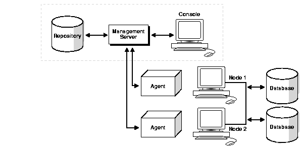

Environment 1: Console, Management Server and Repository on Same Machine
The Console, with the aid of the Management Server, remotely manages the databases for both nodes. The Console and the Management Server are running on a Windows NT or Solaris machine with an Oracle8i database installed that is only used as a repository. Oracle Intelligent Agent does not need to be running.
The nodes share an Oracle8i database. The repository is not created in this database, and Oracle Intelligent Agent is running on both nodes.
Figure 6-3 Console, Management Server and Repository on the Same Machine

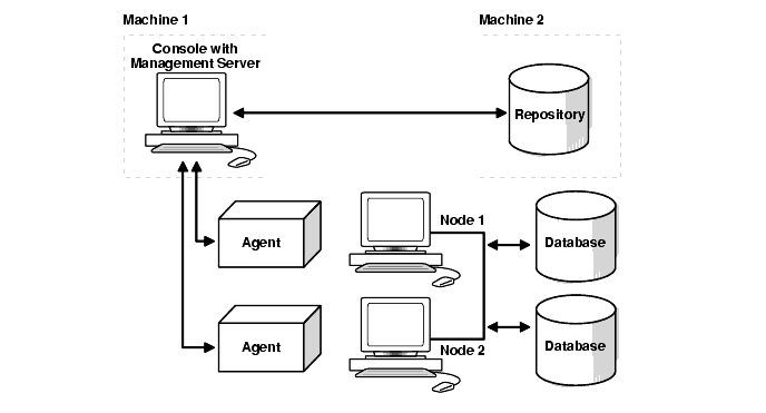

Environment 2: Console, Management Server and Repository on Separate Machines
The Repository is on a separate Windows NT or Solaris machine with an Oracle8i database installed that is only being used as a repository. Oracle Intelligent Agent does not need to be running.
The Management Server remotely manages the databases for the Console on a Windows NT machine. The Console is running on a Windows NT, Windows 95 or Windows 98 machine.
The nodes run an Oracle8i database. The repository is not created in this database, and Oracle Intelligent Agent is running on both nodes.
Figure 6-4 Console, Management Server and Repository on the Separate Machines

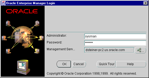

To start the Enterprise Manager Console:
  1. At an operating system prompt, enter:
    oemapp console
    The command string is case-sensitive and you must enter it with lowercase characters.
    On Windows NT, you can also choose Start > Programs > Oracle - HOME_NAME > Oracle Enterprise Management > Oracle Enterprise Manager Console.
  2. If you are logging in to the Console for the first time, after the first login dialog appears, enter the default credentials for the super administrator account:
    Administrator = sysman
    Password = oem_temp
  3. Select a Management Server that is configured with the repository you want to access from the Management Server list.

    A Security Warning dialog appears in which you can change your password.
  4. Enter a password and confirm it.
    The new password you enter is the password you use to log in to the Console for subsequent logins.
    Passwords must have no more than 8 characters.
    The Console appears with the Discovery Wizard:
    The first time you start the Console, you must log in as the super administrator. After other administrator accounts have been created using the super administrator account, you can log in as an administrator.

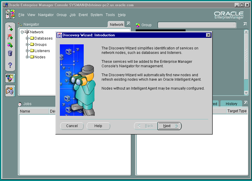

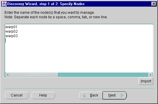

Task 3: Discover Nodes
After the Console has been started, discover network services, such as databases, listeners, and nodes, to populate the Navigator tree.
To discover services:

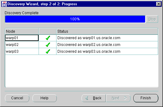

  1. Click Next in the Discovery Wizard: Introduction page.
    The Specify Nodes page appears:

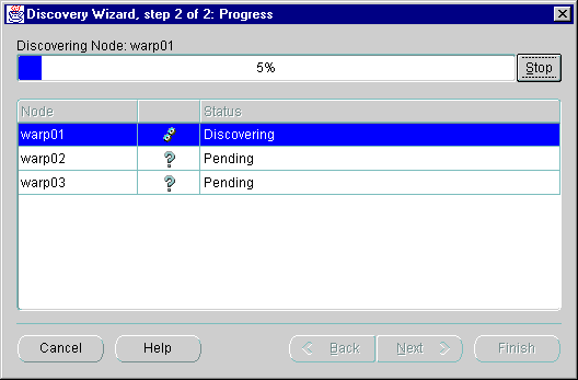

  2. Enter the host names of Oracle Parallel Server nodes.

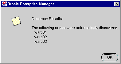

    The Progress page appears with the discovery status:
    Successful discovery results in the following:
  3. Click Finish.
    The following confirmation dialog box appears:
    An unsuccessful discovery is usually the result of the Oracle Intelligent Agent not being started on the node. See "Resolving Service Discovery Failures".
  4. Click OK to acknowledge the status dialog.

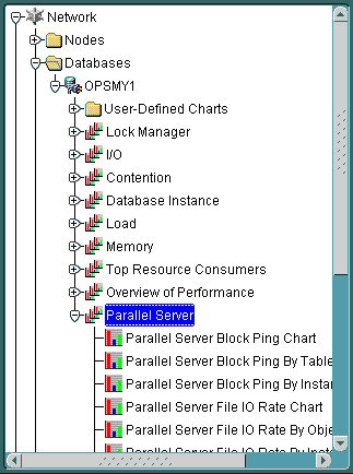

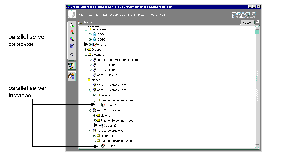

    When an Oracle Parallel Server instance is discovered, a new folder named Parallel Server Instances is created for the node it belongs to.
    By expanding and contracting the folders in the Navigator window, you can see the object discovered.
    The following graphic shows an Oracle Parallel Server database named opsmz with instance opsmz1 on host warp01.us.oracle.com, instance opsmz2 on host warp02.us.oracle.com, and instance opsmz3 on host warp03.us.oracle.com:

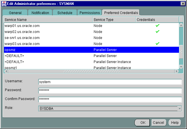

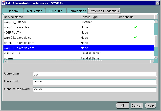

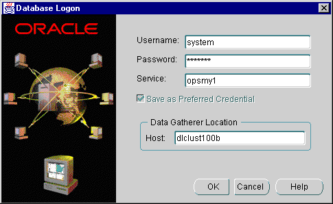

Task 4: Specify Preferred Credentials for Nodes and Oracle Parallel Server Database
You must configure the Oracle Enterprise Manager with preferred user credentials so you can perform certain functions. Oracle Enterprise Manager uses these credentials when establishing connections to Oracle Parallel Server, such as when the Oracle Parallel Server is expanded in the Console's navigator. Startup and shutdown operations also use the credentials.
The credentials you configure must identify a valid DBA user with SYSDBA or SYSOPER privileges for the Oracle Parallel Server database on the target node. This enables you to expand the Oracle Parallel Server database folder in the Navigator window and to perform connection and job execution operations. If you do not identify a valid database user, Oracle Enterprise Manager prompts you for this information each time you attempt to connect to the database.

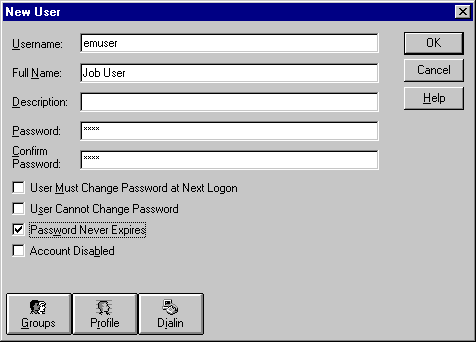

On Windows NT, you must create a Windows NT user account using the next procedure. To create a user account on each node of the cluster:

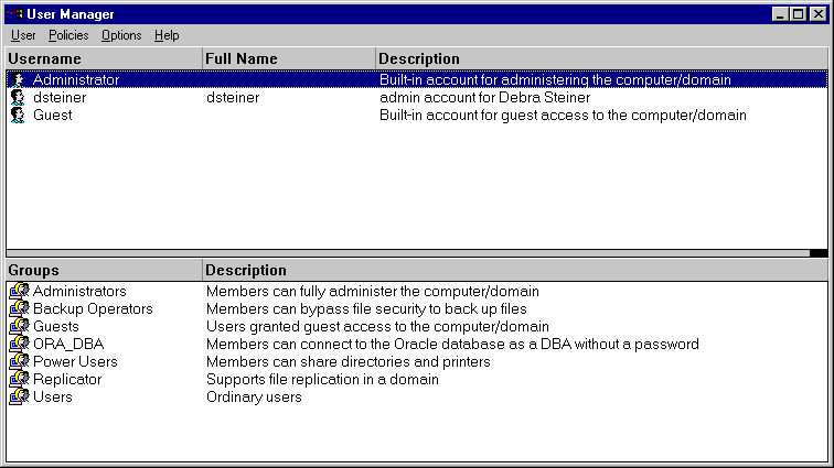

  1. Choose Start > Programs > Administrative Tools (Common) > User Manager:
    The User Manager window appears:
  2. Choose User > New User.
    The New User dialog box appears:
  3. Enter the appropriate information in the dialog box:
    1. Enter a user name that is up to eight characters in length.
    2. Optionally, enter a full name and description for the user.
    3. Enter and confirm a password that is up to eight characters in length.
    4. Make sure the "User Must Change Password at Next Logon" check box is not checked and "Password Never Expires" check box is checked.

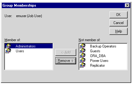

    5. Click Groups to make the user a member of the Administrator's group.
      The Group Memberships dialog box appears:
    6. Double-click the Administrators icon from the window on the right to move it to the Member of list box.
    7. Click OK to close the Group Memberships dialog box and return to the New User dialog box.
  4. Click OK in the New User dialog box.
    The user is added and the User Manager window re-appears.

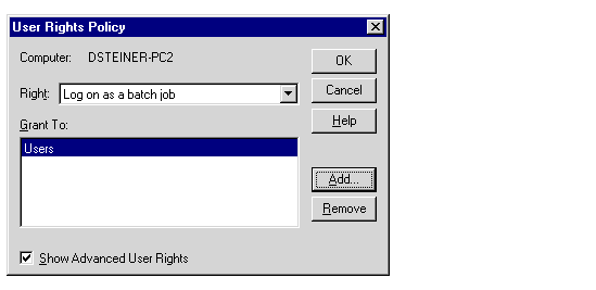

  5. Select the newly-created user, then choose Policies > User Rights.
    The User Rights Policy dialog box appears:
  6. Click the Show Advanced User Rights check box, then select Log on as a batch job from the Right drop-down list box.
  7. Select the user name from the Grant To list box.

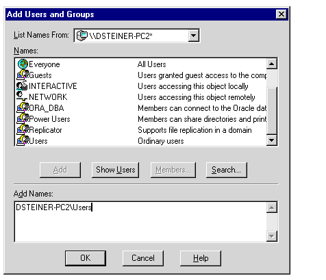

    If the user is not listed, create it. To do this:

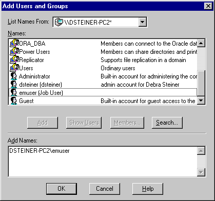

    1. Click Add.
      The Add Users and Groups dialog box appears:
    2. Select the name of your local host machine from the List Names From drop-down list box.
    3. Click the Show Users button.
    4. Select the user from the Names list box, then click Add:
      The new user name appears in the Add Names list box.
    5. Click OK.
      The user appears in the Grant To list box in the User Rights Policy dialog box.
  8. Click OK in the User Rights Policy dialog box in the User. Control returns to the User Manager window.
  9. Choose User > Exit.

Set User Credentials in the Console
You must set user credentials for the database and each node.
To set credentials:
  1. Choose System > Preferences.
    The Edit User Preferences dialog box appears.
  2. Click the Preferred Credentials tab to enter credentials for various service types:
  3. Click on a node (identified by the Node service type) and enter the operating system user name and password.
  4. Perform Step 3 for each node in the cluster.
  5. Click on the Oracle Parallel Server database (identified by the Parallel Server service type):
  6. Enter a DBA user name and password that has SYSDBA or SYSOPER privileges for the target database, such as SYSTEM/MANAGER, and select SYSDBA or SYSOPER from the Role list.
    Important:
    The SYSDBA or SYSOPER privilege is required for the Oracle Parallel Server database and instance startup and shutdown.
  7. If you plan to use the Oracle Performance Manager application, click on an instance (identified by the Parallel Server Instance service type), enter a user name and password that can connect to the instance, select NORMAL role from the drop-down menu.
  8. Click OK.

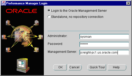

  1. Start Oracle Performance Manager in one of two ways:
    • Standalone
      oemapp pm
      On Windows NT, you can also choose Start > Programs > Oracle - HOME_NAME > Oracle Diagnostics Pack > Performance Manager.
      The Performance Manager Login dialog box appears:
      Select whether to log on to the Management Server or to log on in standalone mode. If "Login to Oracle Management Server" is chosen, additionally enter the Oracle Enterprise Manager administrator user name, password and location of the Management Server.
    • Started from Console
      Choose Oracle Performance Manager in the Diagnostics Pack toolbar or choose Tools > Diagnostics Pack and click Oracle Performance Manager.
      When you start Oracle Performance Manager from the Console, the Oracle Enterprise Manager repository log on credentials are automatically passed to Oracle Performance Manager. This provides you with access to all repository-based information. Also, if a service is selected in the Console Navigator window when Oracle Performance Manager is started, Oracle Performance Manager connects to the database.
  2. Click OK to start Oracle Performance Manager.

Task 2: Accessing Oracle Parallel Server Charts
You can access Oracle Parallel Server charts from the Parallel Server Instance folder or from the Databases folder.
Parallel Server Instances Folder
If the log in occurred from the Console or the "Login to the Oracle Management Server" option was selected in the Performance Manager Login dialog box, you can expand the Parallel Server Instances folder to display the instances from which the list of available charts may be obtained:.
Once you expand the Parallel Server Instances folder, expand User Defined Charts > Parallel Server.
If you did not specify credentials for the instances, as described in "Task 4: Specify Preferred Credentials for Nodes and Oracle Parallel Server Database", the Parallel Server Instances Logon dialog appears when you attempt to expand an instance:
Enter a database user and password. The Oracle Database Gatherer location is automatically specified.
Databases Folder
If the log in occurred in standalone mode or if you selected the "Standalone, no repository connection" option in the Performance Manager Login dialog box you can access the Oracle Parallel Server charts from the Databases folder:
  1. Click the Databases folder.
  2. Choose File > Add New Service.
    The Database Logon dialog prompts you for the required Oracle database credentials:
  3. Enter the required information, including a database user name and password, a net service name in the Service field, and the location of the Oracle Data Gatherer. The Oracle Data Gatherer should be installed and running on one of the nodes in the cluster.
  4. Expand Databases > User Defined Charts > Parallel Server.
