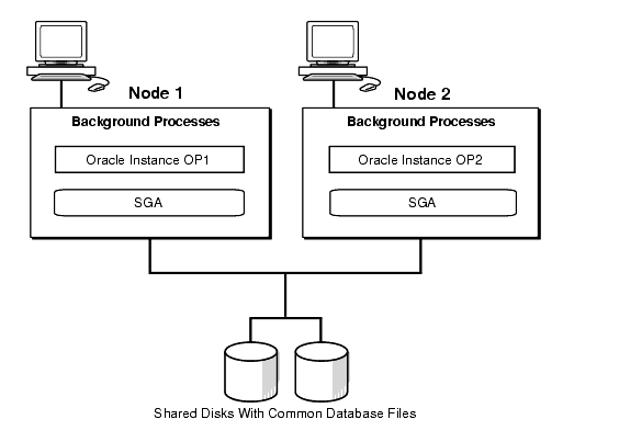

Each instance has its own set of redo log files. Although instances use their own redo log files, the redo log fields must exist on the raw devices. This way, each node can perform recovery on behalf of another node.
Figure 1-1 shows the relationship between two Oracle instances and the shared disks on which the data files are stored:
Figure 1-1 Oracle Parallel Server Instance and Shared Data File Architecture

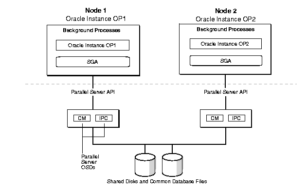

These components provide key services required for proper operation of Oracle Parallel Server and are used by various clients, such as Integrated Distributed Lock Manager.
Figure 1-2 illustrates the Operating System Dependent components in a cluster with two nodes:
Figure 1-2 Operating System Dependent Components

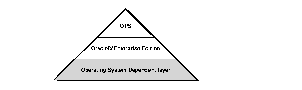

Installation Overview
Oracle Parallel Server software installation requires the following components:
Similar to building blocks, the components must be installed in the following order:
  1. Install the Operating System Dependent layer, as prescribed by your vendor.
  2. Install Oracle8i Enterprise Edition and Oracle Parallel Server from the Oracle8i Enterprise Edition CD-ROM.
    If you intend to build an Oracle Parallel Server database during installation, follow the raw device creation guidelines in Chapter 2. Raw device creation is necessary because Oracle Database Configuration Assistant, which is launched during installation, expects the devices to be established.
