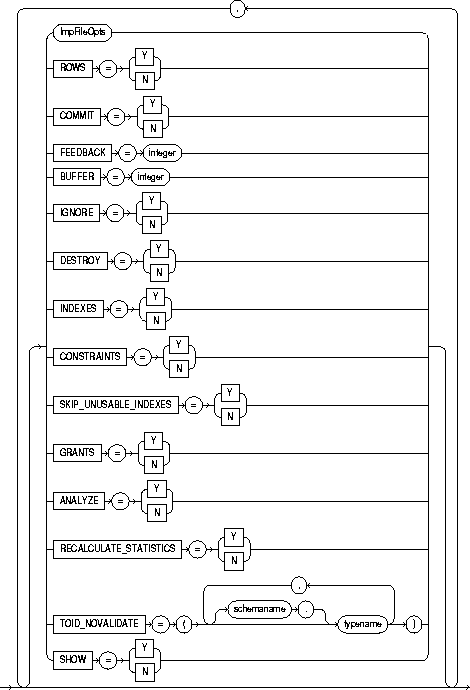

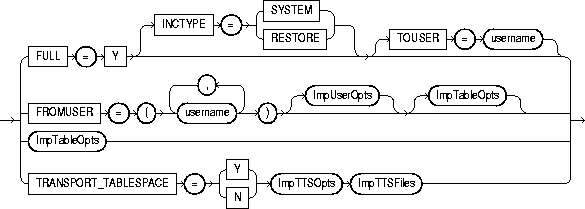

The following diagrams show the syntax for the parameters that you can specify in the parameter file or on the command line.
The following sections describe parameter functionality and default values.

Default: N
Setting this parameter to Y will cause database optimizer statistics to generate when the exported data is imported. See Oracle8i Concepts for information about the optimizer and the statistics it uses. See also the Export parameter STATISTICS, the Import parameter ANALYZE, and Importing Statistics.

Default: Y
Specifies whether or not to import the rows of table data.
Default: N
When SHOW=Y, the contents of the export file are listed to the display and not imported. The SQL statements contained in the export are displayed in the order in which Import will execute them.
The SHOW parameter can be used only with the FULL=Y, FROMUSER, TOUSER, or TABLES parameters.
Default: N
Specifies whether or not Import skips building indexes that were set to the Index Unusable state (by either system or user). Refer to the ALTER SESSION statement in the Oracle8i SQL Reference manual for details. Other indexes (not previously set Index Unusable) continue to be updated as rows are inserted.
This parameter allows you to postpone index maintenance on selected index partitions until after row data has been inserted. You then have the responsibility to rebuild the affected index partitions after the Import.
You can use the INDEXFILE parameter in conjunction with INDEXES=N to provide the SQL scripts for re-creating the index. Without this parameter, row insertions that attempt to update unusable indexes will fail.

Default: none
When you import a table that references a type, but a type of that name already exists in the database, Import attempts to verify that the preexisting type is, in fact, the type used by the table (rather than a different type that just happens to have the same name).
To do this, Import compares the type's unique identifier (TOID) with the identifier stored in the export file. Import will not import the table rows if the TOIDs do not match.
In some situations, you may not want this validation to occur on specified types (for example, if the types were created by a cartridge installation). You can use the TOID_NOVALIDATE parameter to specify types to exclude from TOID comparison.
The syntax is as follows:
toid_novalidate=([schemaname.]typename [, ...])
For example:
imp scott/tiger table=foo toid_novalidate=bar imp scott/tiger table=foo toid_novalidate=(fred.type0,sally.type2,type3)
If you do not specify a schemaname for the type, it defaults to the schema of the importing user. For example, in the first preceding example, the type "bar" defaults to "scott.bar".
The output of a typical import with excluded types would contain entries similar to the following:
[...] . importing IMP3's objects into IMP3 . . skipping TOID validation on type IMP2.TOIDTYP0 . . importing table "TOIDTAB3" [...]
Note: When you inhibit validation of the type identifier, it is your responsibility to ensure that the attribute list of the imported type matches the attribute list of the existing type. If these attribute lists do not match, results are unpredictable.
Default: none
Specifies a list of usernames whose schemas will be targets for import. The
IMP_FULL_DATABASE role is required to use this parameter. To import to a different schema than the one that originally contained the object, specify TOUSER. For example:
imp system/manager FROMUSER=scott TOUSER=joe TABLES=emp
If multiple schemas are specified, the schema names are paired. The following example imports SCOTT's objects into JOE's schema, and FRED's objects into TED's schema:
imp system/manager FROMUSER=scott,fred TOUSER=joe,ted
Note: If the FROMUSER list is longer than the TOUSER list, the remaining schemas will be imported into either the FROMUSER schema, or into the importer's schema, based on normal defaulting rules. You can use the following syntax to ensure that any extra objects go into the TOUSER schema:
imp system/manager FROMUSER=scott,adams TOUSER=ted,ted
Note that user Ted is listed twice.
Default: N
When specified as Y, instructs Import to import transportable tablespace metadata from an export file.
See Transportable Tablespaces for more information.
Default: none
When TRANSPORT_TABLESPACE is specified as Y, use this parameter to list the users who own the data in the transportable tablespace set.
