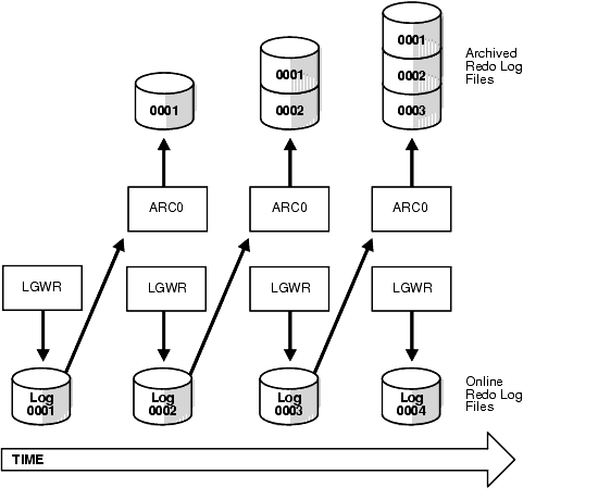

Running a Database in ARCHIVELOG Mode
When you run a database in ARCHIVELOG mode, you enable the archiving of the online redo log. The database control file indicates that a group of filled online redo log files cannot be used by LGWR until the group is archived. A filled group is immediately available for archiving after a redo log switch occurs.
The archiving of filled groups has these advantages:

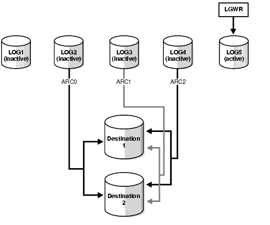

Decide how you plan to archive filled groups of the online redo log. You can configure an instance to archive filled online redo log files automatically, or you can archive manually. For convenience and efficiency, automatic archiving is usually best. Figure 7-2 illustrate how the process archiving the filled groups (ARC0 in this illustration) generates the database's online redo log.
Figure 7-2 Online Redo Log File Use in ARCHIVELOG Mode
If all databases in a distributed database operate in ARCHIVELOG mode, you can perform coordinated distributed database recovery. If any database in a distributed database uses NOARCHIVELOG mode, however, recovery of a global distributed database (to make all databases consistent) is limited by the last full backup of any database operating in NOARCHIVELOG mode.

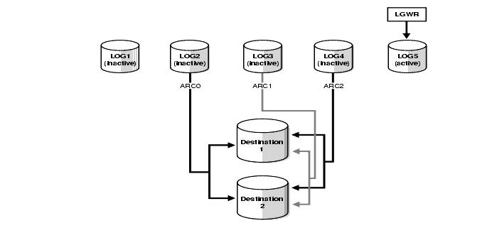

To transmit files successfully to a standby database, either ARCn or a server process must do the following:
Each ARCn process creates a corresponding RFS for each standby destination. For example, if three ARCn processes are archiving to two standby databases, then Oracle establishes six RFS connections.
You can transmit archived logs through a network to a remote location by using Net8. Indicate a remote archival by specifying a Net8 service name as an attribute of the destination. Oracle then translates the service name, which you set by means of the SERVICE_NAME parameter, through the tnsnames.ora file to a connect descriptor. The descriptor contains the information necessary for connecting to the remote database. Note that the service name must have an associated database SID, so that Oracle correctly updates the log history of the control file for the standby database.
The RFS process, which runs on the destination node, acts as a network server to the ARCn client. Essentially, ARCn pushes information to RFS, which transmits it to the standby database.
The RFS process, which is required when archiving to a remote destination, is responsible for the following tasks:

Specifying Multiple ARCn Processes
Specify up to ten ARCn processes for each database instance. Enable the multiple processing feature at startup or at runtime by setting the initialization parameter LOG_ARCHIVE_MAX_PROCESSES=n (where n is any integer from 1 to 10). By default, the parameter is set to 1.
Because LGWR automatically increases the number of ARCn processes should the current number be insufficient to handle the current workload, the parameter is intended to allow you to specify the initial number of ARCn processes or to increase or decrease the current number. Assuming the initial number of ARCn processes was set to 4, the following statement will decrease the number of processes to 2.
ALTER SYSTEM SET LOG_ARCHIVE_MAX_PROCESSES=2
When decreasing the number of ARCn processes, it is not determinate exactly which process will be stopped. Also, you are not allowed to alter the value of the parameter to 0, so at least one ARCn process will always be active. Query the V$ARCHIVE_PROCESSES view to see information about the state of each archive process. Processes that have stopped will show as being in the IDLE state.
Creating multiple processes is especially useful when you:
Multiple ARCn processing prevents the bottleneck that occurs when LGWR switches through the multiple online redo logs faster than a single ARCn process can write inactive logs to multiple destinations. Note that each ARCn process works on only one inactive log at a time, but must archive to each specified destination.
For example, if you maintain five online redo log files, then you may decide to start the instance using three ARCn processes. As LGWR actively writes to one of the log files, the ARCn processes can simultaneously archive up to three of the inactive log files to various destinations. As Figure 7-3 illustrates, each instance of ARCn assumes responsibility for a single log file and archives it to all of the defined destinations.
Figure 7-3 Using Multiple Arch Processes
