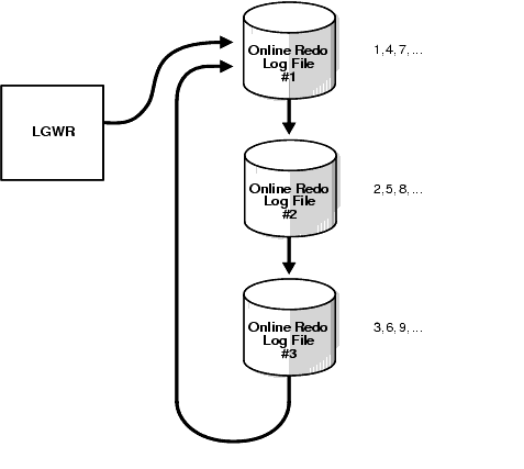

How Oracle Writes to the Online Redo Log
The online redo log of a database consists of two or more online redo log files. Oracle requires a minimum of two files to guarantee that one is always available for writing while the other is being archived (if in ARCHIVELOG mode).
LGWR writes to online redo log files in a circular fashion; when the current online redo log file fills, LGWR begins writing to the next available online redo log file. When the last available online redo log file is filled, LGWR returns to the first online redo log file and writes to it, starting the cycle again. Figure 6-1 illustrates the circular writing of the online redo log file. The numbers next to each line indicate the sequence in which LGWR writes to each online redo log file.
Filled online redo log files are available to LGWR for re-use depending on whether archiving is enabled:
Figure 6-1 Circular Use of Online Redo Log Files by LGWR

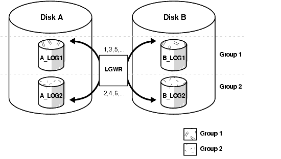

Multiplexing Online Redo Log Files
Oracle provides the capability to multiplex an instance's online redo log files to safeguard against damage to its online redo log files. When multiplexing online redo log files, LGWR concurrently writes the same redo log information to multiple identical online redo log files, thereby eliminating a single point of redo log failure.
Oracle recommends that you multiplex your redo log files; the loss of the log file data can be catastrophic if recovery is required.
Figure 6-2 Multiplexed Online Redo Log Files
The corresponding online redo log files are called groups. Each online redo log file in a group is called a member. In Figure 6-2, A_LOG1 and B_LOG1 are both members of Group 1; A_LOG2 and B_LOG2 are both members of Group 2, and so forth. Each member in a group must be exactly the same size.
Notice that each member of a group is concurrently active, or, concurrently written to by LGWR, as indicated by the identical log sequence numbers assigned by LGWR. In Figure 6-2, first LGWR writes to A_LOG1 in conjunction with B_LOG1, then A_LOG2 in conjunction with B_LOG2, etc. LGWR never writes concurrently to members of different groups (for example, to A_LOG1 and B_LOG2).

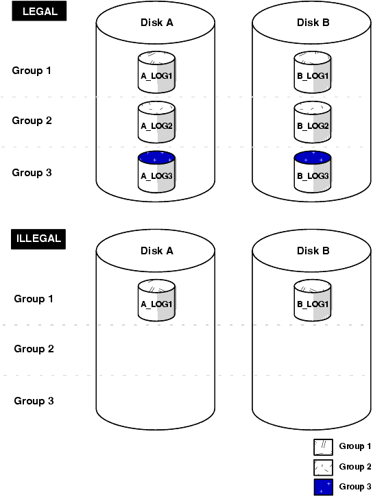

Legal and Illegal Configurations
To safeguard against a single point of online redo log failure, a multiplexed online redo log is ideally symmetrical: all groups of the online redo log have the same number of members. Nevertheless, Oracle does not require that a multiplexed online redo log be symmetrical. For example, one group can have only one member, while other groups have two members. This configuration protects against disk failures that temporarily affect some online redo log members but leave others intact.
The only requirement for an instance's online redo log is that it have at least two groups. Figure 6-3 shows legal and illegal multiplexed online redo log configurations. The second configuration is illegal because it has only one group.
Figure 6-3 Legal and Illegal Multiplexed Online Redo Log Configuration
