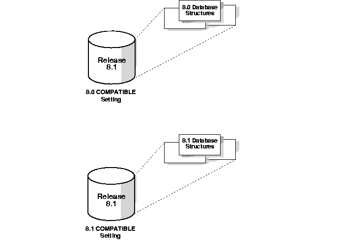

When you upgrade to a new release of Oracle, certain new features may make your database incompatible with your previous release. Your upgraded Oracle database becomes incompatible with your previous release under the following conditions:
Oracle enables you to control the compatibility of your database with the COMPATIBLE initialization parameter. By default, when the COMPATIBLE initialization parameter is not set in your initialization parameter file, it defaults to the lowest possible setting for the release, which is 8.0.0 for all 8.0 and 8.1 releases. You cannot use new features that would make your database incompatible with release 8.0.0 until you reset the COMPATIBLE initialization parameter to a higher value.
This default behavior has the following advantages:
Of course, the major disadvantage of the default setting is that many of the features of the new release are not available to you if you leave the COMPATIBLE initialization parameter unset.

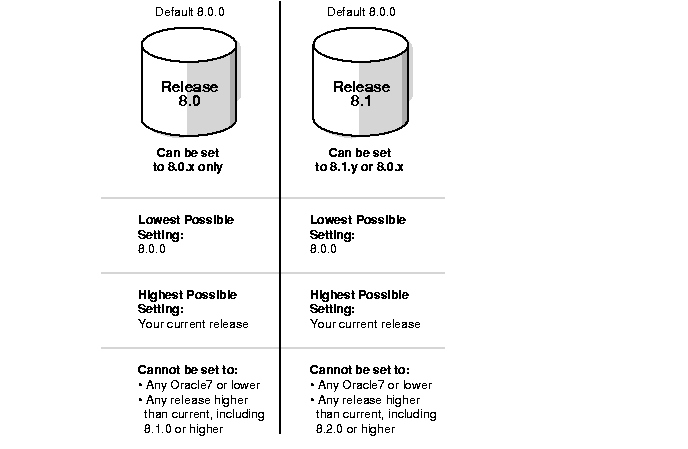

Depending on the products you chose to install during your release 8.1 installation of Oracle, the Oracle Universal Installer may set the COMPATIBLE initialization parameter to a higher value, such as 8.1.0. Check your initialization parameter file if you are unsure of the current setting for the COMPATIBLE initialization parameter.
Figure 9-1 illustrates the default settings and the possible settings for release 8.0 and release 8.1 of Oracle.
The COMPATIBLE initialization parameter operates in the following way:
Once you upgrade or migrate to a new release, you can set the COMPATIBLE initialization parameter to match the new release. Doing so enables you to use all of the features of the new release, but may make it more difficult for you to downgrade to your previous release. If you want to downgrade, then you must remove all of the incompatibilities with the release to which you are downgrading, which is a process that may require a great deal of time and effort.
