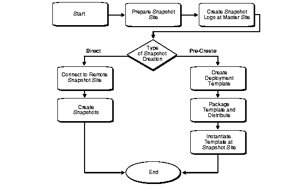

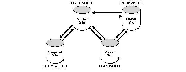

Oracle offers several types of snapshots to meet the needs of many different replication (and non-replication) situations. The following sections describe each type of snapshot and also describe some environments for which they are best suited.
The following sections contain examples of creating different types of snapshots. Whenever you create a snapshot, regardless of its type, always specify the schema name of the table owner in the query for the snapshot. For example, consider the following CREATE SNAPSHOT statement:

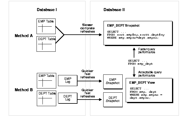

For certain applications, you might want to consider using a complex snapshot. Figure 3-2 and the following text discuss some issues that you should consider.
In summary, to decide which method to use:

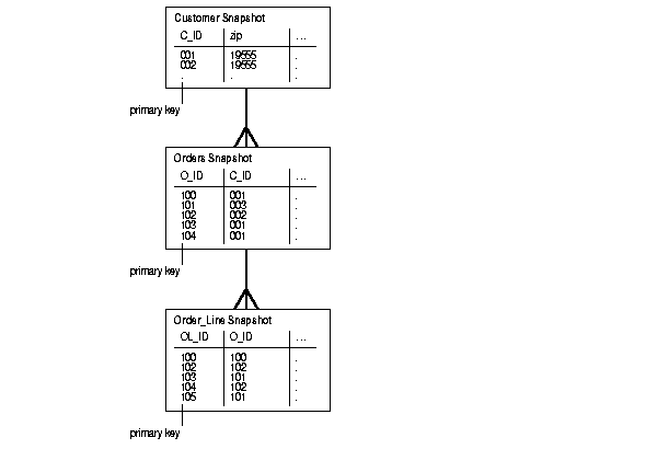

Consider the scenario where you have three tables called CUSTOMER, ORDERS, and ORDER_LINE, and you want to create three corresponding snapshots that maintain the referential integrity of these master tables. If a salesperson wants to retrieve the customer information, pending orders, and the associated order lines for all customers in the 19555 zip code, the most efficient method is to create snapshots with one or more subqueries in the defining query of the snapshot.
The CUSTOMER snapshot has a very simple defining query because the CUSTOMER master table is at the top of the hierarchy:
CREATE SNAPSHOT sales.customer AS SELECT * FROM sales.customer@dbs1.acme.com WHERE zip = 19555;
When you create the ORDERS snapshot, you want to retrieve all of the orders for the customers located in the 19555 zip code. Look at the relationships in Figure 3-3 below, and note that the CUSTOMER and ORDERS table are related through the
C_ID column. The following statement creates the ORDERS snapshot with the appropriate data set:
CREATE SNAPSHOT sales.orders AS SELECT * FROM sales.orders@dbs1.acme.com o WHERE EXISTS (SELECT c_id FROM sales.customer@dbs1.acme.com c WHERE o.c_id = c.c_id AND c.zip = 19555);
Creating the ORDER_LINE snapshot uses the same approach as the ORDERS snapshot, except that you have one additional subquery. Notice in Figure 3-3 that the ORDER_LINE and the ORDERS tables are related through the O_ID row. The following statement creates the ORDER_LINE snapshot with the appropriate data set:
CREATE SNAPSHOT sales.order_line AS SELECT * FROM sales.order_line@dbs1.acme.com ol WHERE EXISTS (SELECT o_id FROM sales.orders@dbs1.acme.com o WHERE ol.o_id = o.o_id AND EXISTS (SELECT c_id FROM sales.customer@dbs1.acme.com c WHERE o.c_id = c.c_id AND c.zip = 19555));
The snapshots created by these three DDL statements are each fast refreshable. If new customers are identified in the target zip code, the new data will be propagated to the snapshot site during the subsequent refresh process. Likewise, if a customer is removed from the target zip code, the appropriate data also will be removed from the snapshot during the subsequent refresh process.

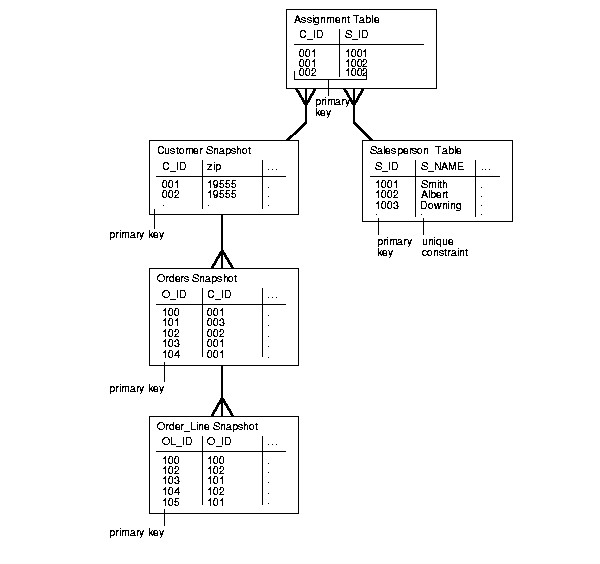

While the previous subquery examples demonstrate greater flexibility for snapshots, there are still certain limitations in the above example. For example, if the salesperson changed territories or the existing territory was assigned an additional zip code, the above snapshot definitions would need to be altered or recreated because the zip code 19555 was "hard coded" in the previous snapshot definitions.
With this in mind, if assignment tables are used in conjunction with subquery subsetting, changes to a snapshot environment can easily be controlled by the DBA. For example, consider the customer/salesperson relationship in Figure 3-4.
In this example, a salesperson is assigned customers based on the ASSIGNMENT table. If new salespersons are hired or other salespersons leave, the existing customers can be assigned to their new salesperson by simply modifying the contents of the assignment table. Besides creating a single point of administration, assignment tables used in conjunction with subquery subsetting enables this easy administration to remain secure. For example, salesperson #1001 cannot view the customer information of other salespersons, which is very important if the customer information contains sensitive data.
Considering the relationships pictured in Figure 3-4, if the ORDERS snapshot's defining query was specified as the following:
CREATE SNAPSHOT sales.orders AS SELECT * FROM sales.orders@hq.acme.com o -- conditions for customers WHERE EXISTS ( SELECT c_id FROM sales.customer@hq.acme.com c WHERE o.c_id = c.c_id AND EXISTS ( SELECT * FROM sales.assignments@hq.acme.com a WHERE a.c_id = c.c_id AND EXISTS ( SELECT * FROM sales.salesperson@hq.acme.com s WHERE a.s_id = s.s_id AND s.s_id = 'gsmith')));
Then, the ORDERS snapshot is populated with order data for the customers that are assigned to salesperson 'gsmith'. Notice the 'gsmith' value in the last line of the CREATE SNAPSHOT statement.
With this flexibility, managers can easily control snapshot data sets by making simple changes to the assignment table, without requiring a DBA to modify any SQL. For example, if the specified salesperson was assigned two new customers, the manager would simply assign these two new customers to the salesperson in the assignment table. After the next fast snapshot refresh, the data for these two customers will be propagated to the target snapshot site, such as the salesperson's laptop. Conversely, if a customer was taken away from the specified salesperson, all data pertaining to the specified customer would be removed from the snapshot site after the next refresh and the salesperson would no longer be able to access that information.

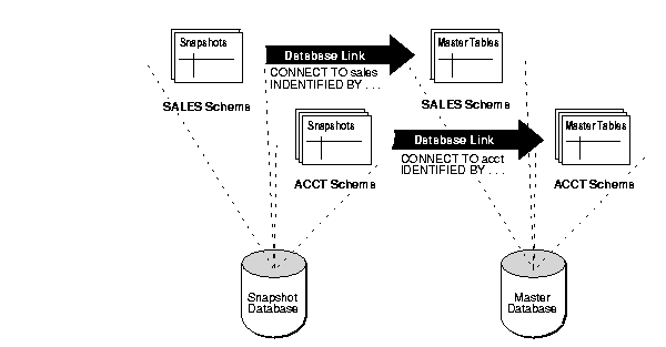

At the master site, an Oracle database automatically registers information about a snapshots based on its master table(s). The following sections explain more about Oracle's snapshot registration mechanism.
You can query the DBA_REGISTERED_SNAPSHOTS data dictionary view to list the following information about a remote snapshot:
You can also query the DBA_SNAPSHOT_REFRESH_TIMES view at the master site to obtain the last refresh times for each snapshot. Administrators can use this information to monitor snapshot activity from master sites and coordinate changes to snapshot sites if a master table needs to be dropped, altered, or relocated.

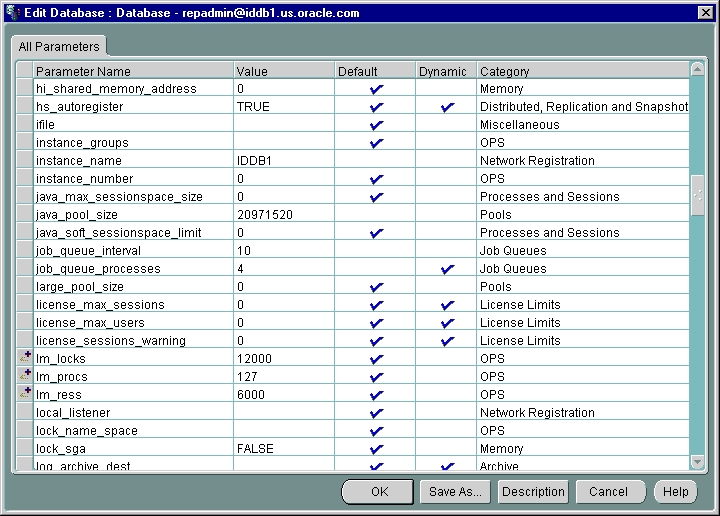

Oracle automatically registers a snapshot at its master database when you create the snapshot, and unregisters the snapshot when you drop it.
If necessary, you can maintain registration manually. Use the REGISTER_SNAPSHOT and UNREGISTER_SNAPSHOT procedures of the DBMS_SNAPSHOT package at the master site to add, modify, or remove snapshot registration information.

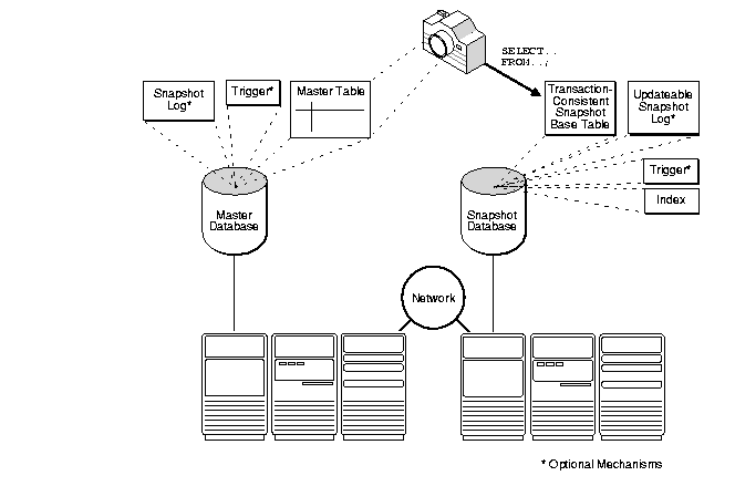

The mechanisms used in snapshot replication are depicted in Figure 3-5. Some of these mechanisms are optional and are used only as needed to support the created snapshot environment. For example, if you have a read-only snapshot, then you do not have an updateable snapshot log or an internal trigger at the remote site. Also, if you have a complex snapshot that cannot be fast refreshed, then you may not have a snapshot log at the master site.
The three mechanisms displayed in Figure 3-6 are required at the master site to support fast refreshing of snapshots.
The master table is the basis for the snapshot and is located at the target master site. This table may be involved in both snapshot replication and multimaster replication (remember that a snapshot points to only one master site).
Changes made to the master table, as recorded by the snapshot log, will be propagated to the snapshot during the refresh process.

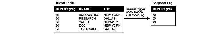

When changes are made to the master table using DML, an internal trigger records information about the affected rows in the snapshot log. This information includes the values of the primary key and/or the ROWID, and the values of the filter columns. This is an internal trigger that is automatically activated when you create a snapshot log for the target master table.
Note: Filter columns are required when the snapshot contains a subquery. See "Data Subsetting with Snapshots" for information on subquery snapshots and "Using Filter Columns" for more information. |
When you create a snapshot log for a master table, Oracle creates an underlying table as the snapshot log. A snapshot log holds the primary keys and/or the ROWIDs of rows that have been updated in the master table. A snapshot log can also contain filter columns to support fast refreshes of snapshots with subqueries. The name of a snapshot log's table is MLOG$_master_table_name. The snapshot log is created in the same schema as the target master table. One snapshot log can support multiple snapshots on its master table.
As described in the previous section, the internal trigger adds change information to the snapshot log whenever a DML transaction has taken place on the target master table.

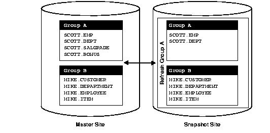

A snapshot group in a replication system maintains a partial or complete copy of the objects at the target master group. Snapshot groups cannot span master group boundaries. Figure 3-7 displays the correlation between Groups A and B at the master site and Groups A and B at the snapshot site.
Group A at the snapshot site (see Figure 3-7) contains only some of the objects in the corresponding Group A at the master site. Group B at the snapshot site contains all objects in Group B at the master site. Under no circumstances, however, could Group B at the snapshot site contain objects from Group A at the master site. As illustrated in Figure 3-7, a snapshot group has the same name as the master group on which the snapshot group is based. For example, a snapshot group based on a "PERSONNEL" master group is also named "PERSONNEL."
In addition to maintaining organizational consistency between snapshot sites and master sites, snapshot groups are required for supporting updateable snapshots. If a snapshot does not belong to a snapshot group, then it must be a read-only snapshot.
If you need to support multiple users within the same database at a snapshot site, you may want to create multiple snapshot groups for the target master group. Doing so enables you to define different subqueries for your snapshot definitions in each snapshot group, and allows each user to access only his or her subset of the data.
Defining multiple data sets with different snapshot groups is more secure than defining different WHERE clauses for multiple views supporting different users. When you define multiple data sets with different snapshot groups, you can grant users access to individual snapshot objects, and you can control what the user views, deletes, and inserts. With a WHERE clause in a view, you can only control what a user views, but not what a user the deletes or inserts.
Defining multiple snapshot groups gives you the ability to control data sets at a group level. For example, if you create different snapshot groups for the HR, PERSONNEL, and MANUFACTURING departments, you can administer each department as a group, instead of as individual objects. For example, you can refresh the snapshots as a departmental group, and you can drop the objects as a group.
To accommodate multiple snapshot groups at the same snapshot site that are based on a single master group, you can specify a group owner as an additional identifier when defining your snapshot group.
After you have defined your snapshot group with the addition of a group owner, you add your snapshot objects to the target snapshot group by defining the same group owner. When using a group owner, remember that each snapshot object must have a unique name. If a single snapshot site has multiple snapshot groups based on the same master group, a snapshot group's object names cannot have the same name as snapshot objects in another snapshot group. To avoid conflicting names, you might want to append the group owner name to the end of your object name. For example, if you have group owners "HR" and "PERSONNEL", you might name the "EMP" snapshot object as "EMP_HR" and "EMP_PERSONNEL," respectively.
Additionally, all snapshot groups that are based on the same master group at a single snapshot site must "point" to the same master site. For example, if the SCOTT_MG snapshot group owned by HR is based on the associated master group at the ORC1.WORLD master site, then the SCOTT_MG snapshot group owned by PERSONNEL must also be based on the associated master group at ORC1.WORLD, assuming that the HR and PERSONNEL owned groups are at the same snapshot site.

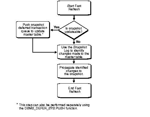

To perform a fast refresh, the server that manages the snapshot first identifies the changes that occurred in the master since the most recent refresh of the snapshot and then applies them to the snapshot. Fast refreshes are more efficient than complete refreshes when there are few changes to the master because the participating server and network replicate a smaller amount of data. You can perform fast refreshes of snapshots only when the master table has a snapshot log.
After a direct path load on a master table using SQL*Loader, a fast refresh does not apply the changes that occurred during the direct path load. Also, fast refresh does not apply changes that result from other types of bulk load operations on master tables. Examples of these operations include some INSERT statements with an APPEND hint and some INSERT ... SELECT * FROM statements.

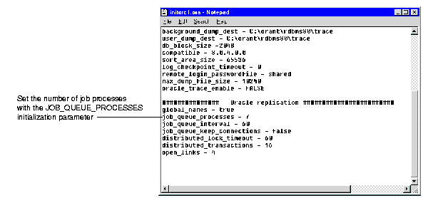

Most problems encountered with snapshot replication come from not preparing the environment properly. There are four essential tasks that you must perform before you begin creating your snapshot environment:

Each snapshot site needs several users to perform the administrative and refreshing activities at the snapshot site. You must create and grant the necessary privileges to the snapshot administrator and to the refresher.
You need equivalent proxy users at the target master site to perform tasks on behalf of the snapshot site users. Usually, a proxy snapshot administrator and a proxy refresher are created.
A schema containing a snapshot in a remote database must correspond to the schema that contains the master table in the master database. Therefore, identify the schemas that contain the master tables that you want to replicate with snapshots. Once you have identified the target schemas at the master database, create the corresponding accounts with the same names at the remote database. For example, if all master tables are in the SALES schema of the DB1 database, create a corresponding SALES schema in the snapshot database DB2.

Before creating your snapshots, you need to create several administrative database links. Specifically, you should create a PUBLIC database link from the snapshot site to the master site; doing so makes defining your private database links easier because you do not need to include the USING clause in each link. You also need private database links from the snapshot administrator to the proxy administrator and from the propagator to the receiver, but, if you use the Replication Manager Setup Wizard, these database links are created for you automatically.
See Also:
Appendix A, "Security Options" in Oracle8i Replication Management API Reference for more information. |
After the administrative database links have been created, a private database link must be created connecting each replicated snapshot schema at the snapshot database to the corresponding schema at the master database. Be sure to embed the associated master database account information in each private database link at the snapshot database. For example, the SALES schema at a snapshot database DB2 should have a private database link to database DB1 that connects using the SALES username and password.

You will often use the Edit Database dialog box of Instance Manager to configure the SNP processes and the SNP job interval at the snapshot site if you have a dedicated network link to the snapshot site or if you are able to schedule the network link. This is required because Instance Manager is not installed at the snapshot site in most cases and thus the configuration must be done remotely from the master site. If remote configuration is not possible, see the next section.
Complete the following to set your job processes using Instance Manager:
You can save this configuration, which is helpful if you use Instance Manager to manage your database.
See Also:
Oracle Enterprise Manager Administrator's Guide and the Instance Manager online help for more information on using Instance Manager. |
If you do not have access to Instance Manager, you can manually edit the initialization parameter file. Use a text editor to modify the contents of your initialization parameter file.
In most cases, all of the initialization parameters used in replication are grouped together under an "Oracle replication" heading in your initialization parameter file.
After you have modified the contents of your initialization parameter file, restart your database with these new settings.

To create a snapshot log, you need the following privileges:
When you create a snapshot log, you can specify whether you are using filter columns. Filter columns are an essential component when using subquery snapshots. A filter column must be defined in a snapshot log that is supporting a snapshot that references a column that is in a WHERE clause and is not part of the equijoin columns.
Consider the following DDL:
1) CREATE SNAPSHOT sales.orders AS 2) SELECT * FROM sales.orders@dbs1.acme.com o 3) WHERE EXISTS 4) (SELECT c_id FROM sales.customer@dbs1.acme.com c 5) WHERE o.c_id = c.c_id AND zip = 19555);
Notice in line 5 of the above DDL that three columns are referenced in the WHERE clause. Columns O.C_ID and C.C_ID are referenced as part of the equijoin clause; the column ZIP is an additional filter column. Therefore, create a filter column in the snapshot log for the ZIP column of the SALES.CUSTOMER table.
You are encouraged to analyze the defining queries of your planned snapshots and identify which filter columns must be created in your snapshot logs. If you try to create or refresh a snapshot that requires a filter column before creating the snapshot log containing the filter column, your snapshot creation or refresh may fail.

Snapshot environments can be created in several different ways and from several different locations. In most cases, you should use deployment templates at the master site to locally pre-create a snapshot environment that will be individually deployed to the target snapshot site.
You can also individually create the snapshot environment by establishing a connection to the snapshot site and building the snapshot environment directly.
See the Replication Manager online help for information on using deployment templates to centrally create a snapshot environment using Replication Manager.
See the Replication Manager online help for information on individually creating the snapshot environment with a direct connection to the remote snapshot site using Replication Manager.
See Chapter 4, "Create Deployment Template" of the Oracle8i Replication Management API Reference manual for information on using deployment templates to centrally pre-create a snapshot environment using the replication management API.
See Chapter 5, "Create Snapshot Group" of the Oracle8i Replication Management API Reference manual for information on individually creating the snapshot environment with a direct connection to the remote snapshot site using the replication management API.
