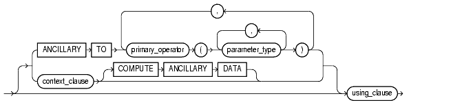

implementation_clause::=
context_clause::=
using_clause::=
ANCILLARY TO primary_operator
specifies that the operator binding is ancillary to the specified primary operator binding (primary_operator). If you specify this clause, do not specify a previous binding with just one number parameter.
context_clause
specifies the name of the implementation type used by the functional implementation of the operator as a scan context.
COMPUTE ANCILLARY DATA
specifies that the operator binding computes ancillary data.
using_clause
specifies the function that provides the implementation for the binding.
function_name
is the name of the function. The function can be a standalone function, packaged function, type method, or a synonym for any of these.
