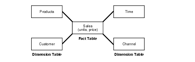

The star schema is the simplest data warehouse schema. It is called a star schema because the diagram of a star schema resembles a star, with points radiating from a center. The center of the star consists of one or more fact tables and the points of the star are the dimension tables shown in Figure 2-1:
Unlike other database structures, in a star schema, the dimensions are denormalized. That is, the dimension tables have redundancy which eliminates the need for multiple joins on dimension tables. In a star schema, only one join is needed to establish the relationship between the fact table and any one of the dimension tables.
The main advantage to a star schema is optimized performance. A star schema keeps queries simple and provides fast response time because all the information about each level is stored in one row. See Chapter 16, "Schemas", for further information regarding schemas.

A fact table is a table in a star schema that contains facts. A fact table typically has two types of columns: those that contain facts, and those that are foreign keys to dimension tables. A fact table might contain either detail-level facts or facts that have been aggregated. Fact tables that contain aggregated facts are often called summary tables. A fact table usually contains facts with the same level of aggregation.
Values for facts or measures are usually not known in advance; they are observed and stored.
Fact tables are the basis for the data queried by OLAP tools.
You must define a fact table for each star schema. A fact table typically has two types of columns: those that contain facts, and those that are foreign keys to dimension tables. From a modeling standpoint, the primary key of the fact table is usually a composite key that is made up of all of its foreign keys; in the physical data warehouse, the data warehouse administrator may or may not choose to create this primary key explicitly.
Facts support mathematical calculations used to report on and analyze the business. Some numeric data are dimensions in disguise, even if they seem to be facts. If you are not interested in a summarization of a particular item, the item may actually be a dimension. Database size and overall performance improve if you categorize borderline fields as dimensions.

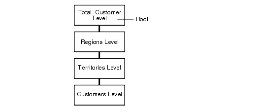

A dimension is a structure, often composed of one or more hierarchies, that categorizes data. Several distinct dimensions, combined with measures, enable you to answer business questions. Commonly used dimensions are Customer, Product, and Time. Figure 2-2 shows some a typical dimension hierarchy.
Dimension data is typically collected at the lowest level of detail and then aggregated into higher level totals, which is more useful for analysis. For example, in the Total_Customer dimension, there are four levels: Total_Customer, Regions, Territories, and Customers. Data collected at the Customers level is aggregated to the Territories level. For the Regions dimension, data collected for several regions such as Western Europe or Eastern Europe might be aggregated as a fact in the fact table into totals for a larger area such as Europe.

Levels represent a position in a hierarchy. For example, a Time dimension might have a hierarchy that represents data at the Month, Quarter, and Year levels. Levels range from general to very specific, with the root level as the highest, or most general level. The levels in a dimension are organized into one or more hierarchies.
Level relationships specify top-to-bottom ordering of levels from most general (the root) to most specific information and define the parent-child relationship between the levels in a hierarchy.
You can define hierarchies where each level rolls up to the previous level in the dimension or you can define hierarchies that skip one or multiple levels.
