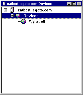

On a Windows system, the Devices window itself (shown in Figure 3-2) does not show the attribute settings of the device resources.

When you run the LSM Administrator GUI on a Windows system, the Devices window appears, as shown in Figure 3-2. To view the attribute settings for any specific device, right-click the icon of that device and select Edit from the pop-up menu. The Edit Device dialog box opens, displaying the attributes for the device.
