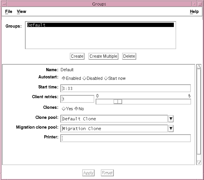

To verify that the LSM Server configuration is properly set up for the automatic bootstrap backup, you need to run the LSM Administrator GUI. See "Using the LSM Administrator GUI" for details about running the GUI on either a UNIX or Windows system.
Then, you need to verify that the client resource and Default group resource are both configured correctly. For information about accessing the client resource, see "Client Resource" . In the client resource, be sure that the Group attribute is set to Default.
Finally, check the Default group resource configuration. Open the Groups window by one of the following methods, depending on the type of system running the GUI:
The Groups window lists the single group resource, with the name Default. On a UNIX system, the Groups window also shows all the attribute settings of the group resource.
On a UNIX system, the Groups window is displayed as shown in Figure 4-1.

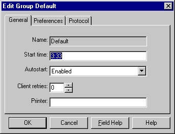

On a Windows system, the Groups window does not automatically show the attribute settings of the group resource, so you must perform the following additional steps to see the group's attributes:
The Edit Group dialog box on a Windows system, listing all the attributes of the group resource, is displayed as shown in Figure 4-2.
The Start time attribute specifies when the bootstrap backup is configured to begin--3:33 a.m. by default. To have the bootstrap information sent to a specific printer, set the Printer attribute to the name of that printer.

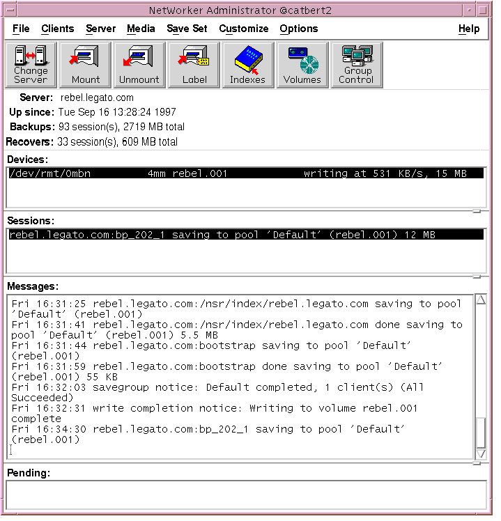

You can use the LSM Administrator GUI to monitor the status of Oracle backup and restore operations. In the GUI on UNIX, the messages are displayed in the Sessions and Messages sections of the main LSM Administrator window. In the GUI on Windows NT, the messages appear in the Monitor window.
You can view progress messages that appear during the backup and completion messages that advise when the backup is complete. You can also view the messages in specific online system files.
The following example shows the types of messages displayed in the Sessions and Messages sections of the main LSM Administrator window on UNIX during Oracle backups.
