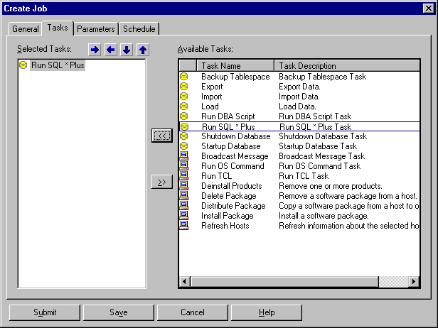

The Task page allows you to choose the tasks that you want the job to perform.
Select a task and click on the << (Add) button to include the task in the job. You can add multiple tasks to the job from the Available Tasks scrolling list. For information on Oracle predefined job tasks and their parameters, see the online help for Oracle job tasks and Oracle Job Tasks on page 4-17.
You can remove tasks from this list. Select the task and
click on the >> (Remove) button.

This example illustrates how to complete the General, Tasks, Parameters, and Schedule Pages when creating a job. It also describes how to save and submit a job.
If the job is processed successfully, the job will start
executing on 7/1/98 at 12:00 AM. After an execution of a job, it is moved
to the Job History page of the Job window. You can view the progress of
the job and any output in the Progress Page.
This section lists the Oracle predefined job tasks and parameters for:
This information is entered in the Job
Task Page and Job Parameters Page
of the Create Job property sheet. The name and the parameters are listed
for each task.
