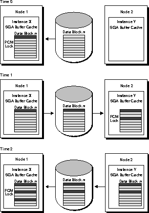

Consider the following example and the illustrations in Figure 4-2. (This example assumes that one PCM lock covers one block--although many blocks could be covered.)
See Also: "How Buffer State and Lock Mode Change" on page 9-11
