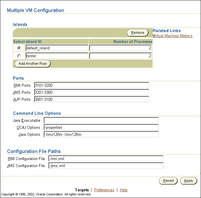

To change the Java command line options for an OC4J Instance, go to the home page for the OC4J Instance and perform the following steps:
For example, enter the following to set the JVM heap sizes to 128 Megabytes:
-Xmx128m
Figure 6-1 shows the Server Properties page with Java Options.

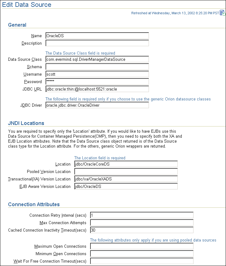

A data source, which is the instantiation of an object that implements the javax.sql.DataSource interface, enables you to retrieve a connection to a database server. This section describes data source configuration options for global data sources. A global data source is available to all the deployed applications in an OC4J Instance.
This section covers the following topics:
See Also:
Some of the performance related configuration options have different affects, depending on the type of the data source. OC4J supports two types of data sources, emulated and non-emulated:
The pre-installed default data source is an emulated data source. Emulated data sources are wrappers around Oracle data sources. If you use these data sources, your connections are extremely fast, because they do not provide full XA or JTA global transactional support. We recommend that you use these data sources for local transactions or when your application requires access or update to a single database. You can use emulated data sources for Oracle or non-Oracle databases.
You can use the emulated data source to obtain connections to different databases by changing the values of the url and connection-driver parameters.
The following is a definition of an emulated data source:
<data-source class="com.evermind.sql.DriverManagerDataSource" name="OracleDS" location="jdbc/OracleCoreDS" xa-location="jdbc/xa/OracleXADS" ejb-location="jdbc/OracleDS" connection-driver="oracle.jdbc.driver.OracleDriver" username="scott" password="tiger" url="jdbc:oracle:thin:@localhost:5521:oracle" inactivity-timeout="30" />
Non-emulated data sources are pure Oracle data sources. These are used by applications that want to coordinate access to multiple sessions within the same database or to multiple databases within a global transaction.
Each data source is configured with one or more logical names that allow you to identify the data source within J2EE applications. The ejb-location is the logical name of an EJB data source. In addition, use the ejb-location name to identify data sources for most J2EE applications, where possible, even when not using EJBs. The ejb-location only applies to emulated data sources. You can use this option for single phase commit transactions or emulated data sources.
Using the ejb-location, the data source manages opening a pool of connections, and manages the pool. Opening a connection to a database is a time-consuming process that can sometimes take longer than the operation of getting the data itself. Connection pooling allows client requests to have faster response times, because the applications do not need to wait for database connections to be created. Instead, the applications can reuse connections that are available in the connection pool.
The max-connections option specifies the maximum number of open connections for a pooled data source. To improve system performance, the value you specify for the number max-connections depends on a combination of factors including the size and configuration of your database server, and the type of SQL operations that your application performs.
The default value for max-connections and the handling of the maximum depends on the data source type, emulated or non-emulated.
For emulated data sources, there is no default value for max-connections, but the database configuration limits that affect the number of connections apply. When the maximum number of connections, as specified with max-connections, are all active, new requests must wait for a connection to be become available. The maximum time to wait is specified with wait-timeout.
For non-emulated data sources, there is a property, cacheScheme, that determines how max-connections is interpreted. Table 6-2 lists the values for the cacheScheme property (DYNAMIC_SCHEME is the default value for cacheScheme).
See Also:
The tradeoffs for changing the value of max-connections are:
max-connections.
The min-connections option specifies the minimum number of open connections for a pooled data source.
For applications that use a database, performance can improve when the data source manages opening a pool of connections, and manages the pool. This can improve performance because incoming requests don't need to wait for a database connection to be established; they can be given a connection from one of the available connections, and this avoids the cost of closing and then reopening connections.
By default, the value of min-connections is set to 0. When using connection pooling to maintain connections in the pool, specify a value for min-connections other than 0.
For emulated and non-emulated data sources, the min-connections option is treated differently.
For emulated data sources, when starting up the initial min-connections connections, connections are opened as they are needed and once the min-connections number of connections is established, this number is maintained.
For non-emulated data sources, after the first access to the data source, OC4J then starts the min-connections number of connections and maintains this number of connections.
Limiting the total number of open database connections to a number your database can handle is an important tuning consideration. You should check to make sure that your database is configured to allow at least as large a number of open connections as the total of the values specified for all the data sources min-connections options, as specified in all the applications that access the database.
The inactivity-timeout specifies the time, in seconds, to cache unused connections before closing them.
To improve performance, you can set the inactivity-timeout to a value that allows the data source to avoid dropping and then re-acquiring connections while your J2EE application is running.
The default value for the inactivity-timeout is 60 seconds, which is typically too low for applications that are frequently accessed, where there may be some inactivity between requests. For most applications, to improve performance, we recommend that you increase the inactivity-timeout to 120 seconds.
To determine if the default inactivity-timeout is too low, monitor your system. If you see that the number of database connections grows and then shrinks during an idle period, and grows again soon after that, you have two options: you can increase the inactivity-timeout, or you can increase the min-connections.
The wait-timeout specifies the number of seconds to wait for a free connection if the connection pool does not contain any available connections (that is, the number of connections has reached the limit specified with max-connections and they are all currently in use).
If you see connection timeout errors in your application, increasing the wait-timeout can prevent the errors. The default wait-timeout is 60 seconds.
If database resources, including memory and CPU are available and the number of open database connections is approaching max-connections, you may have limited max-connections too stringently. Try increasing max-connections and monitor the impact on performance. If there are not additional machine resources available, increasing max-connections is not likely to improve performance.
You have several options in the case of a saturated system:
wait-timeout.
The connection-retry-interval specifies the number of seconds to wait before retrying a connection when a connection attempt fails.
If the connection-retry-interval is set to a small value, or a large number of connection attempts is specified with max-connect-attempts this may degrade performance if there are many retries performed without obtaining a connection.
The default value for the connection-retry-interval is 1 second.
The max-connect-attempts option specifies the maximum number of times to retry making a connection. This option is useful to control when the network is not stable, or the environment is unstable for any reason that sometimes makes connection attempts fail.
If the connection-retry-interval option is set to a small value, or a large number of connection attempts is specified with max-connect-attempts this may degrade performance if there are many retries performed without obtaining a connection.
The default value for max-connect-attempts is 3.
Figure 6-2 shows the Oracle Enterprise Manager configuration page that lets you view or modify a data source. This page is available in Oracle Enterprise Manager by selecting the Edit button for a selected data source from the Data Sources page from the application default page for an OC4J Instance, or by selecting data sources from the administration section of a deployed application's description page (this is only available when the application has its own local data source).
Oracle Enterprise Manager stores the data sources elements that you add or modify in an XML file. This file defaults to the name data-sources.xml and is located in /j2ee/home/config. If you want to change the name or the location of this file, you can do this in the General Properties page off of the default application screen or off of your specific application's page, when the application specifies a local data source.

Oracle9iAS lets you configure multiple OC4J processes in an OC4J Instance. If there are sufficient resources on your system, you may be able to improve performance by configuring multiple OC4J processes for the OC4J Instance that services your J2EE application. Using multiple OC4J processes is the simplest form of load balancing without using Oracle9iAS clustering. Configuring an OC4J Instance to allow requests to be served by multiple OC4J processes can reduce or avoid contention and improve scalability. Oracle9iAS also supports multi node clustering for load balancing.
The optimal ratio of OC4J processes to CPUs is dependent on characteristics of the application, hardware configuration and JDK being used. But in general, for multi-cpu configurations with greater than two processors, you should consider configuring multiple OC4J processes. For example, on a recent test of a J2EE application, a single OC4J process was sufficient to use 70% of the resources on a four processor system. That statistic indicated that either adding a second OC4J process would be advantageous or that the incoming load was insufficient to utilize more of the machine resources. By monitoring the incoming load, we were able to determine that it was the former, and adding a second process improved performance.
Adding processes beyond the available resources of the system will not improve performance. For example, if one OC4J process is sufficient to saturate the CPU resources of a system, adding four more processes is not likely to improve performance and may, in fact, degrade it. A good starting point is to configure one OC4J process for every 2-3 CPUs and measure the improvement derived from adding additional processes.
Using Oracle Enterprise Manager you can specify the number of processes in an OC4J Instance using the OC4J Instance level configuration available on the OC4J Instance's home page.
If you configure your OC4J to use load-balancing with multiple OC4J processes running within the same island, and you do not want sessions to be replicated, make sure that the <distributable/> property is not set in the application's web.xml file.
