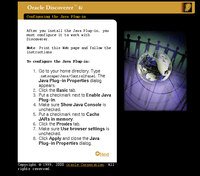

If you are using a Netscape browser and depending on the software already installed on the client machine, you might be prompted to download and install the Java Plug-in. If you are not prompted to download and install the Java Plug-in, skip the next step.
Note: The screen below only appears when using a Unix browser.
When you have configured the Java Plug-in (or if you did not have to install and configure the Java Plug-in) the following screen appears:
