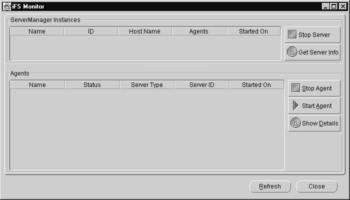

To use Oracle iFS Manager to manage the Server Manager instances, you use Oracle iFS Monitor. Oracle iFS Monitor uses the same Server Manager commands you use on a command line, but through a graphical interface. You still have the option of issuing Server Manager commands on the command line, but now there is an easier way of managing the servers and agents monitored by Server Manager through Oracle iFS Manager.
The Oracle iFS Monitor is only used to monitor the servers and agents started by Server Manager. You cannot use Oracle iFS Monitor to start Server Manager; you must start Server Manager from the machine where Oracle iFS was installed. However, you can use Oracle iFS Monitor to stop the agents and the Server Manager instance that is monitoring the agents.
Oracle iFS Monitor displays the servers registered with the database and the agents managed by Server Manager.

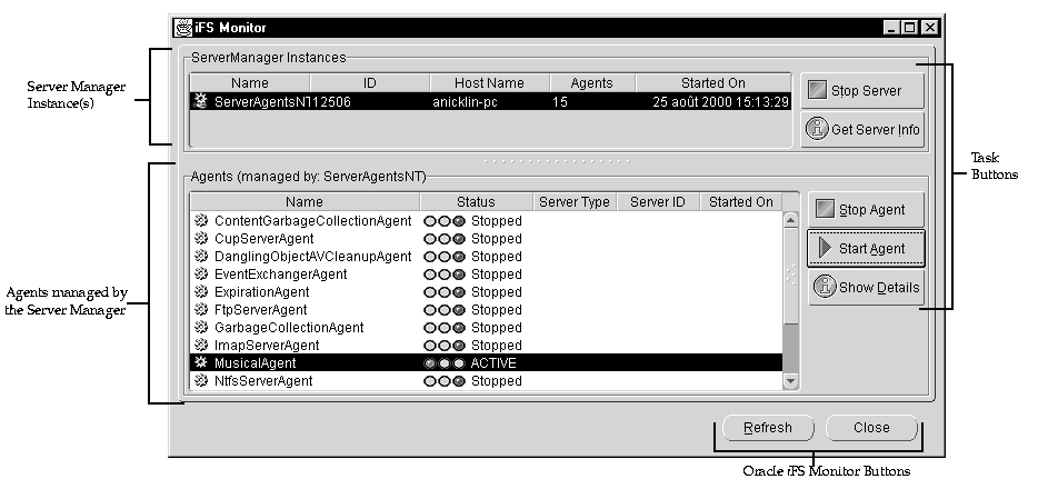

The Oracle iFS Monitor window has the following parts:
Where:
The buttons on the right side of the Oracle iFS Monitor window are used to perform Server Manager tasks. The following table describes the buttons and their purpose.
The buttons at the bottom of the Oracle iFS Monitor window are used to perform Oracle iFS Monitor window tasks. The following table describes the buttons and their purpose.

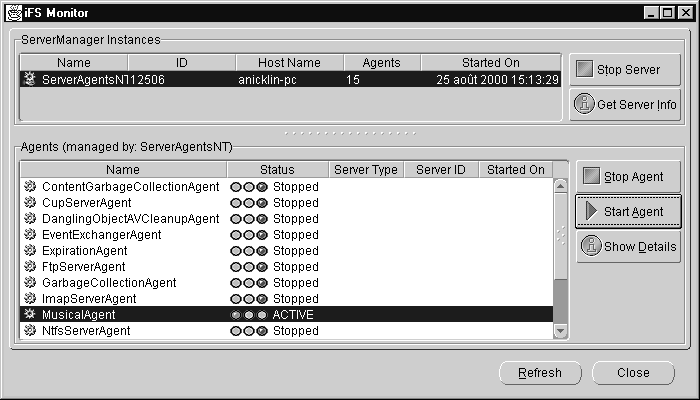

Oracle iFS Monitor is accessed through Oracle iFS Manager by selecting Monitor from the File menu. A window displays containing the Server Manager instances and agents. If you are starting Oracle iFS Monitor before starting an instance of Server Manager, no information is displayed as shown here:
When a Server Manager instance is started, select the Server Manager for which you want to view agents. The agents display in the Agents box as shown here:
All agents are displayed, even if they are have a status of Stopped.
See AlsoBefore you can use Oracle iFS Monitor, you must start at least one instance of Server Manager. For more information on starting a Server Manager instance, see Chapter 2, "Starting Oracle iFS".
If an agent has been specified in the definition file to start automatically with Server Manager, then the status of that agent displays as ACTIVE and a green light is displayed when the Oracle iFS Monitor is started. To start an agent manually, do the following:
This action may take several minutes. A yellow light and a status of Starting indicates the in the process of starting. When the agent is started, the status changes to ACTIVE and a green light is displayed.
