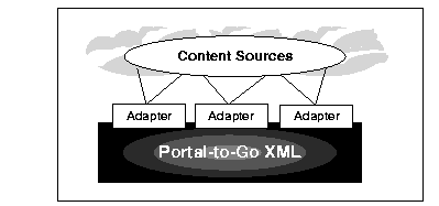

What Is a Portal-to-Go Adapter?
A Portal-to-Go adapter is a Java application that retrieves data from an external source and renders it in Portal-to-Go XML. When invoked by a master service, an adapter returns an XML document that contains the service content.
In the Portal-to-Go architecture, adapters constitute the interface between the Portal-to-Go server and the content source.

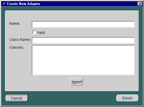

You use the Create New Adapter form to install an adapter in the repository. To invoke the form:
  1. Right-click Adapters in the Portal-to-Go Repository tree view.
  2. Click Create New Adapter.
The form includes the following parameters:
Parameter  Value
Name
The name of the adapter. The name should be unique in the adapter folder.
Valid
Specifies whether the adapter is available to services. If selected, the adapter is available to services. If an adapter is invalid, the adapter is unavailable, and all master services that use the adapter are invalid.
Class Name
The Java class that either implements the adapter or serves as the entry point for the classes that implement the adapter.
Classes
The archived class or classes that implement the adapter. To import the archive, click Import and browse to the archive that implements the adapter.
