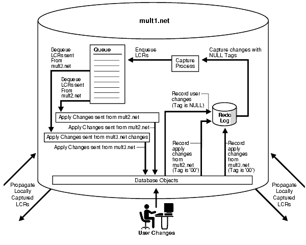

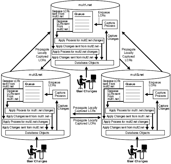

This scenario involves a Streams environment in which each database is a source database for every other database, and each database is a destination database of every other database. Each database communicates directly with every other database.
For example, consider an environment that replicates the database objects and data in the hr schema between three Oracle databases: mult1.net, mult2.net, and mult3.net. DML and DDL changes made to tables in the hr schema are captured at all three databases in the environment and propagated to each of the other databases in the environment, where changes are applied. Figure 8-1 illustrates an example environment in which each database is a source database.
You can avoid change cycles by configuring such an environment in the following way:
NULL redo tags for changes from each source database. If you use a procedure in the DBMS_STREAMS_ADM package to create an apply process, then the apply process generates non-NULL tags with a value of '00' in the redo log by default. In this case, no further action is required for the apply process to generate non-NULL tags.
If you use the CREATE_APPLY procedure in the DBMS_APPLY_ADM package to create an apply process, then do not set the apply_tag parameter. Again, the apply process generates non-NULL tags with a value of '00' in the redo log by default, and no further action is required.
NULL. You do this by ensuring that each DML rule in the rule set used by the capture process has the following condition:
:dml.is_null_tag()='Y'
Each DDL rule should have the following condition:
:ddl.is_null_tag()='Y'
These rule conditions indicate that the capture process captures a change only if the tag for the change is NULL. If you use the DBMS_STREAMS_ADM package to generate rules, then each rule has one of these conditions by default.
This configuration prevents change cycling because all of the changes applied by the apply processes are never recaptured (they were captured originally at the source databases). Each database sends all of its changes to the hr schema to every other database. So, in this environment, no changes are lost, and all databases are synchronized. Figure 8-2 illustrates how tags can be used in a database in a multiple source environment.
| See Also:
"Multiple Source Databases in an Oracle-Only Environment" illustrates this example |

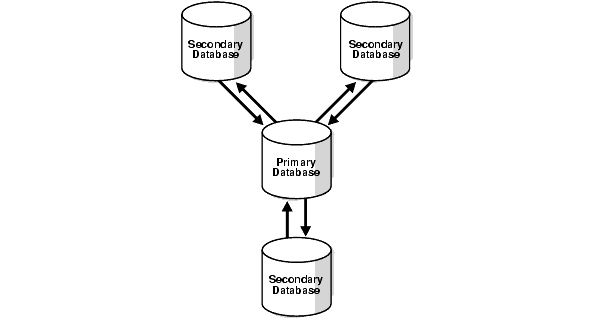

This scenario involves a Streams environment in which one database is the primary database, and this primary database shares data with several secondary databases. The secondary databases share data only with the primary database. The secondary databases do not share data directly with each other, but, instead, share data indirectly with each other through the primary database. This type of environment is sometimes called a "hub and spoke" environment.
In such an environment, changes are captured, propagated, and applied in the following way:
An alternate scenario may use queue forwarding. If this environment used queue forwarding, then changes from secondary databases that are applied at the primary database are not captured at the primary database. Instead, these changes are forwarded from the queue at the primary database to all secondary databases, except for the one at which the change originated.
| See Also:
"Directed Networks" for more information about apply forwarding and queue forwarding |

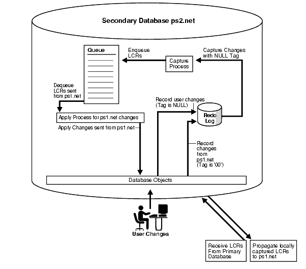

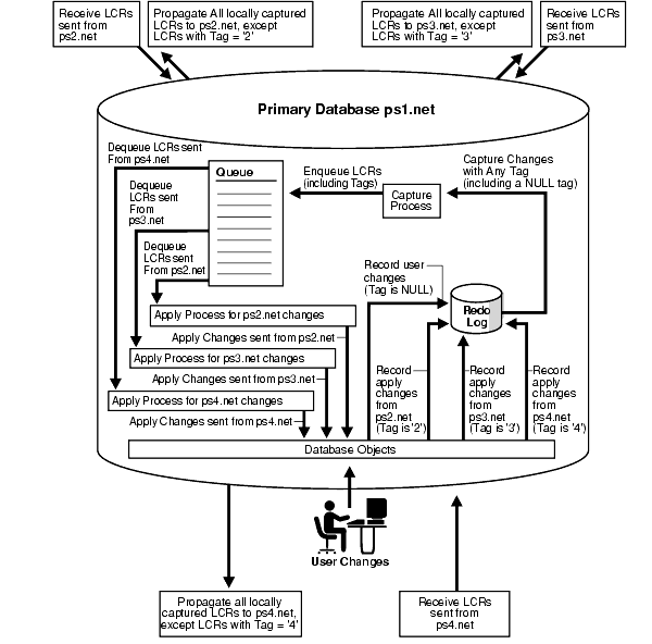

For example, consider an environment that replicates the database objects and data in the hr schema between one primary database named ps1.net and three secondary databases named ps2.net, ps3.net, and ps4.net. DML and DDL changes made to tables in the hr schema are captured at the primary database and at the three secondary databases in the environment. Then, these changes are propagated and applied as described previously. The environment uses apply forwarding, not queue forwarding, to share data between the secondary databases through the primary database. Figure 8-3 illustrates an example environment which has one primary database and multiple secondary databases.
You can avoid change cycles by configuring the environment in the following way:
ps1.net to generate non-NULL redo tags that indicate the site from which it is receiving changes. In this environment, the primary database has at least one apply process for each secondary database from which it receives changes. For example, if an apply process at the primary database receives changes from the ps2.net secondary site, then this apply process may generate a raw value that is equivalent to the hexadecimal value '2' for all changes it applies. You do this by setting the apply_tag parameter in the CREATE_APPLY or ALTER_APPLY procedure in the DBMS_APPLY_ADM package to the non-NULL value.
For example, run the following procedure to create an apply process that generates redo entries with tags that are equivalent to the hexadecimal value '2':
BEGIN DBMS_APPLY_ADM.CREATE_APPLY( queue_name => 'strmadmin.streams_queue', apply_name => 'apply_ps2', rule_set_name => 'strmadmin.apply_rules_ps2', apply_tag => HEXTORAW('2'), apply_captured => true); END; /
NULL redo tags. The exact value of the tags is irrelevant as long as it is non-NULL. In this environment, each secondary database has one apply process that applies changes from the primary database.
For example, assuming no apply processes exist at the secondary databases, run the ADD_SCHEMA_RULES procedure in the DBMS_STREAMS_ADM package at each secondary database to create an apply process that generates non-NULL redo entries with tags that are equivalent to the hexadecimal value '00':
BEGIN DBMS_STREAMS_ADM.ADD_SCHEMA_RULES( schema_name => 'hr', streams_type => 'apply', streams_name => 'apply', queue_name => 'strmadmin.streams_queue', include_dml => true, include_ddl => true, source_database => 'ps1.net'); END; /
include_tagged_lcr parameter to true when you run one of the procedures that generate capture rules in the DBMS_STREAMS_ADM package. If you use the DBMS_RULE_ADM package to create rules for the capture process at the primary database, then make sure the rules do not contain is_null_tag conditions, because these conditions involve tags in the redo log.
For example, run the following procedure at the primary database to produce one DML capture process rule and one DDL capture process rule that each have a condition that evaluates to TRUE for changes in the hr schema, regardless of the tag for the change:
BEGIN DBMS_STREAMS_ADM.ADD_SCHEMA_RULES( schema_name => 'hr', streams_type => 'capture', streams_name => 'capture', queue_name => 'strmadmin.streams_queue', include_tagged_lcr => true, -- Note parameter setting include_dml => true, include_ddl => true); END; /
NULL. You do this by ensuring that each DML rule in the rule set used by the capture process at the secondary database has the following condition:
DDL rules should have the following condition:
These rules indicate that the capture process captures a change only if the tag for the change is NULL. If you use the DBMS_STREAMS_ADM package to generate rules, then each rule has one of these conditions by default. If you use the DBMS_RULE_ADM package to create rules for the capture process at a secondary database, then make sure each rule contains one of these conditions.
For example, if a propagation job propagates changes to the secondary database ps2.net, whose tags are equivalent to the hexadecimal value '2', then the rules for the propagation job should propagate all LCRs relating to the hr schema to the secondary database, except for LCRs with a tag of '2'. For row LCRs, such rules should include the following condition:
:dml.get_tag()!=HEXTORAW('2')
For DDL LCRs, such rules should include the following condition:
:ddl.get_tag()!=HEXTORAW('2')
You can use the CREATE_RULE procedure in the DBMS_RULE_ADM package to create rules with these conditions.
This configuration prevents change cycling in the following way:
Figure 8-4 illustrates how tags are used at the primary database ps1.net.
Figure 8-5 illustrates how tags are used at one of the secondary databases (ps2.net).

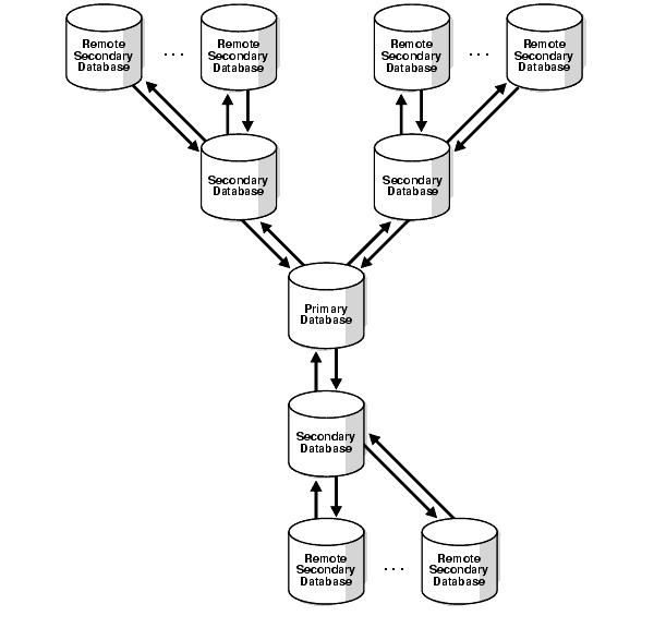

In this environment, one primary database shares data with several secondary databases, but the secondary databases have other secondary databases connected to them, which will be called remote secondary databases. This environment is an extension of the environment described in "Primary Database Sharing Data with Several Secondary Databases".
A remote secondary database does not share data directly with the primary database, but instead shares data indirectly with the primary database through a secondary database. So, the shared data exists at the primary database, at each secondary database, and at each remote secondary database. Changes made at any of these databases are captured and propagated to all of the other databases. Figure 8-6 illustrates an environment with one primary database and multiple extended secondary databases.
In such an environment, you can avoid change cycling in the following way:
'00'. This value is the default tag value for an apply process.TRUE only if the tag in the LCR does not equal '00'. For example, enter a condition similar to the following for row LCRs:
:dml.get_tag()!=HEXTORAW('00')
TRUE only if the tag in the LCR does not equal the tag value for the remote secondary database. For example, if the tag value of a remote secondary database is equivalent to the hexadecimal value '19', then enter a condition similar to the following for row LCRs:
:dml.get_tag()!=HEXTORAW('19')
By configuring the environment in this way, you prevent change cycling, and no changes originating at any database are lost.
