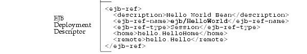

If you have two beans in the JAR: BeanA and BeanB. If BeanB creates a reference to BeanA, you can define this reference in one of three methods:
BeanB would define the following <ejb-ref> within its definition:
<ejb-ref> <ejb-ref-name>myBeans/BeanA</ejb-ref-name> <ejb-ref-type>Session</ejb-ref-type> <home>myBeans.BeanAHome</home> <remote>myBeans.BeanA</remote> </ejb-ref>
No <ejb-link> is necessary for this method. However, the BeanB implementation must refer to BeanA in the JNDI retrieval, which would use java:comp/env/myBeans/BeanA for retrieval within an EJB or Java client and use "myBeans/BeanA" within a Servlet.
<ejb-link> element. This method allows you to use any logical name in your bean implementation for the JNDI retrieval:
<ejb-ref> <ejb-ref-name>ejb/nextVal</ejb-ref-name> <ejb-ref-type>Session</ejb-ref-type> <home>myBeans.BeanAHome</home> <remote>myBeans.BeanA</remote> <ejb-link>myBeans/BeanA</ejb-link> </ejb-ref>
BeanB would use java:comp/env/ejb/nextVal in the JNDI retrieval of BeanA.

The following example defines a reference to the Hello bean, as follows:
java:comp/env/ejb/HelloWorld".
hello.HelloHome; its remote interface is hello.Hello.
HelloWorldBean" name.
As shown in Figure 8-2, the <ejb-link> is mapped to the name attribute within the <ejb-ref-mapping> element in the OC4J-specific deployment descriptor by providing the same logical name in both elements. The Oracle-specific deployment descriptor would have the following definition to map the logical bean name of "java:comp/env/ejb/HelloWorld" to the JNDI URL "/test/myHello".
To invoke this bean from within your implementation, you use the <ejb-ref-name> defined in the EJB deployment descriptor. In EJB or pure Java clients, you prefix this name with "java:comp/env/ejb/", which is where the container places the EJB references defined in the deployment descriptor. Servlets only require the logical name defined in the <ejb-ref-name>.
The following is a lookup from an EJB client:
InitialContext ic = new InitialContext(); HelloHome hh = (HelloHome)ic.lookup("java:comp/env/ejb/HelloWorld");
The following is a lookup from a Servlet, if the Servlet defines the logical name of "ejb/HelloWorld" in <ejb-ref> in its web.xml file and maps it to the actual name of "/test/myHello" within the orion-web.xml file.
InitialContext ic = new InitialContext(); HelloHome hh = (HelloHome)ic.lookup("ejb/HelloWorld");

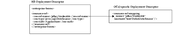

The resource manager connection factory references can include resource managers such as JMS, Java mail, URL, and JDBC DataSource objects. Similar to the EJB references, you can access these objects from JNDI by creating an environment element for each object reference. However, these references can only be used for retrieving the object within the bean that defines these references. Each is fully described in the following sections:
You can access a database through JDBC either using the traditional method or by creating an environment element for a JDBC DataSource. In order to create an environment element for your JDBC DataSource, you must do the following:
DataSource in the data-sources.xml file.
<res-ref-name> element in the EJB deployment descriptor. This name should always start with "jdbc". In the bean code, the lookup of this reference is always prefaced by "java:comp/env/jdbc".
java:comp/env/jdbc" preface and the logical name defined in the EJB deployment descriptor.
As shown in Figure 8-3, the JDBC DataSource uses the JNDI name "test/OrderDataSource". The logical name that the bean knows this resource as is "jdbc/OrderDB". These names are mapped together within the OC4J-specific deployment descriptor. Thus, within the bean's implementation, the bean can retrieve the connection to OrderDataSource by using the "java:comp/env/jdbc/OrderDB" environment element.
The environment element is defined within the EJB deployment descriptor by providing the logical name, "jdbc/OrderDB", its type of javax.sql.DataSource, and the authenticator of "Application".
The environment element of "jdbc/OrderDB" is mapped to the JNDI bound name for the connection, "test/OrderDataSource" within the Oracle-specific deployment descriptor.
Once deployed, the bean can retrieve the JDBC DataSource as follows:
javax.sql.DataSource db; java.sql.Connection conn; . . . db = (javax.sql.DataSource) initCtx.lookup("java:comp/env/jdbc/OrderDB"); conn = db.getConnection();

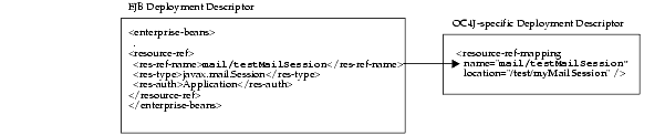

You can create an environment element for a Java mail Session object through the following:
javax.mail.Session reference within the JNDI name space in the application.xml file using the <mail-session> element, as follows:
<mail-session location="mail/MailSession" smtp-host="mysmtp.oraclecorp.com"> <property name="mail.transport.protocol" value="smtp"/> <property name="mail.smtp.from" value="emailaddress@oracle.com"/> </mail-session>
The location attribute contains the JNDI name specified in the location attribute of the <resource-ref-mapping> element in the OC4J-specific deployment descriptor.
<res-ref-name> element in the EJB deployment descriptor. This name should always start with "mail". In the bean code, the lookup of this reference is always prefaced by "java:comp/env/mail".
java:comp/env/mail" preface and the logical name defined in the EJB deployment descriptor.
As shown in Figure 8-4, the Session object was bound to the JNDI name "/test/myMailSession". The logical name that the bean knows this resource as is "mail/testMailSession". These names are mapped together within the OC4J-specific deployment descriptor. Thus, within the bean's implementation, the bean can retrieve the connection to the bound Session object by using the "java:comp/env/mail/testMailSession" environment element.
This environment element is defined with the following information:
The environment element is defined within the EJB deployment descriptor by providing the logical name, "mail/testMailSession", its type of javax.mail.Session, and the authenticator of "Application".
The environment element of "mail/testMailSession" is mapped to the JNDI bound name for the connection, "test/myMailSession" within the OC4J-specific deployment descriptor.
Once deployed, the bean can retrieve the Session object reference as follows:
InitialContext ic = new InitialContext(); Session session = (Session) ic.lookup("java:comp/env/mail/testMailSession"); //The following uses the mail session object //Create a message object MimeMessage msg = new MimeMessage(session); //Construct an address array String mailTo = "whosit@oracle.com"; InternetAddress addr = new InternetAddress(mailto); InternetAddress addrs[] = new InternetAddress[1]; addrs[0] = addr; //set the message parameters msg.setRecipients(Message.RecipientType.TO, addrs); msg.setSubject("testSend()" + new Date()); msg.setContent(msgText, "text/plain"); //send the mail message Transport.send(msg);

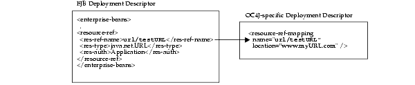

You can create an environment element for a Java URL object through the following:
<res-ref-name> element in the EJB deployment descriptor. This name should always start with "url". In the bean code, the lookup of this reference is always prefaced by "java:comp/env/url".
java:comp/env/url" preface and the logical name defined in the EJB deployment descriptor.
As shown in Figure 8-5, the URL object was bound to the URL "www.myURL.com". The logical name that the bean knows this resource as is "url/testURL". These names are mapped together within the OC4J-specific deployment descriptor. Thus, within the bean's implementation, the bean can retrieve the connection to the bound Session object by using the "java:comp/env/url/testURL" environment element.
The environment element is defined within the EJB deployment descriptor by providing the logical name, "url/testURL", its type of java.net.URL, and the authenticator of "Application".
The environment element of "url/testURL" is mapped to the URL "www.myURL.com" within the OC4J-specific deployment descriptor.
Once deployed, the bean can retrieve the URL object reference as follows:
InitialContext ic = new InitialContext(); URL url = (URL) ic.lookup("java:comp/env/url/testURL"); //The following uses the URL object URLConection conn = url.openConnection();

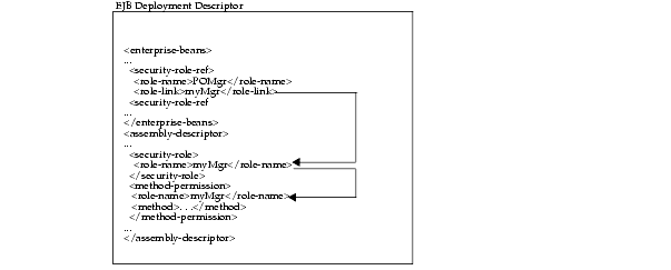

As shown in Figure 8-7, you can use a logical name for a role within your bean implementation, and map this logical name to the correct database role or user. The mapping of the logical name to a database role is specified in the OC4J-specific deployment descriptor. See "Mapping Logical Roles to Users and Groups" for more information.
If you use a logical name for a database role within your bean implementation for methods such as isCallerInRole, you can map the logical name to an actual database role by doing the following:
<enterprise-beans> section <security-role-ref> element. For example, to define a role used within the purchase order example, you may have checked, within the bean's implementation, to see if the caller had authorization to sign a purchase order. Thus, the caller would have to be signed in under a correct role. In order for the bean to not need to be aware of database roles, you can check isCallerInRole on a logical name, such as POMgr, since only purchase order managers can sign off on the order. Thus, you would define the logical security role, POMgr within the <security-role-ref><role-name> element within the <enterprise-beans> section, as follows:
<enterprise-beans> ... <security-role-ref> <role-name>POMgr</role-name> <role-link>myMgr</role-link> </security-role-ref> </enterprise-beans>
The <role-link> element within the <security-role-ref> element can be the actual database role, which is defined further within the <assembly-descriptor> section. Alternatively, it can be another logical name, which is still defined more in the <assembly-descriptor> section and is mapped to an actual database role within the Oracle-specific deployment descriptor.
PurchaseOrder bean must have authorized itself as myMgr. Note that PurchaseOrder is the name declared in the <entity | session><ejb-name> element.
Thus, the following defines the role as myMgr, the EJB as PurchaseOrder, and all methods by denoting the '*' symbol.
<assembly-descriptor> <security-role> <description>Role needed purchase order authorization</description> <role-name>myMgr</role-name> </security-role> <method-permission> <role-name>myMgr</role-name> <method> <ejb-name>PurchaseOrder</ejb-name> <method-name>*</method-name> </method> </method-permission> ... </assembly-descriptor>
After performing both steps, you can refer to POMgr within the bean's implementation and the container translates POMgr to myMgr.

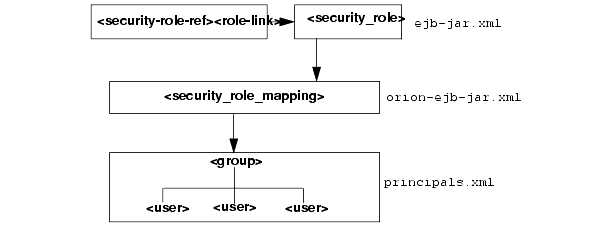

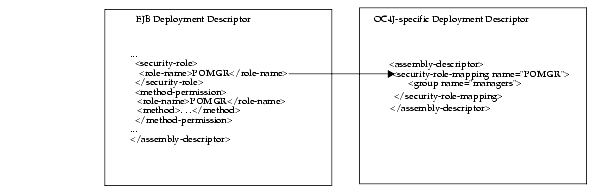

You can use logical roles or actual users and groups in the EJB deployment descriptor. However, if you use logical roles, you must map them to the actual users and groups defined either in the JAZN or XML User Managers.
Map the logical roles defined in the application deployment descriptors to JAZN or XML User Manager users or groups through the <security-role-mapping> element in the OC4J-specific deployment descriptor.
name attribute of this element defines the logical role that is to be mapped.
group or user element maps the logical role to a group or user name. This group or user must be defined in the JAZN or XML User Manager configuration. See Oracle9iAS Containers for J2EE User's Guide and Oracle9iAS Containers for J2EE Services Guide for a description of the JAZN and XML User Managers.
This example maps the logical role POMGR to the managers group in the orion-ejb-jar.xml file. Any user that can log in as part of this group is considered to have the POMGR role; thus, it can execute the methods of PurchaseOrderBean.
<security-role-mapping name="POMGR"> <group name="managers" /> </security-role-mapping>
To map this role to a specific user, do the following:
<security-role-mapping name="POMGR"> <user name="guest" /> </security-role-mapping>
Lastly, you can map a role to a specific user within a specific group, as follows:
<security-role-mapping name="POMGR"> <group name="managers" /> <user name="guest" /> </security-role-mapping>
As shown in Figure 8-8, the logical role name for POMGR defined in the EJB deployment descriptor is mapped to managers within the OC4J-specific deployment descriptor in the <security-role-mapping> element.
Notice that the <role-name> in the EJB deployment descriptor is the same as the name attribute in the <security-role-mapping> element in the OC4J-specific deployment descriptor. This is what identifies the mapping.
If any methods have not been associated with a role mapping, they are mapped to the default security role through the <default-method-access> element in the orion-ejb-jar.xml file. The following is the automatic mapping for any insecure methods:
<default-method-access> <security-role-mapping name="<default-ejb-caller-role>" impliesAll="true" /> </security-role-mapping> </default-method-access>
The default role is <default-ejb-caller-role> and is defined in the name attribute. You can replace this string with any name for the default role. The impliesAll attribute indicates whether any security role checking occurs for these methods. This attribute defaults to true, which states that no security role checking occurs for these methods. If you set this attribute to false, the container will check for this default role on these methods.
If the impliesAll attribute is false, you must map the default role defined in the name attribute to a JAZN or XML user or group through the <user> and <group> elements. The following example shows how all methods not associated with a method permission are mapped to the "others" group.
<default-method-access> <security-role-mapping name="default-role" impliesAll="false" /> <group name="others" /> </security-role-mapping> </default-method-access>
