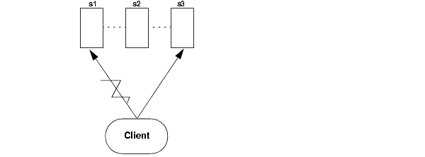

Unlike HTTP clustering, OC4J nodes included in an EJB cluster are not currently grouped in an island and do not have a load balancer as a front-end. Instead, the EJB client container stubs discover--either statically or dynamically--all the OC4J nodes in the EJB cluster, shuffle the destination addresses, and choose one from this group for the connection. Thus, the only method for load balancing and failover is a random methodology.
As Figure 9-1 demonstrates, the client container stubs chose server "s1" for its EJB connection. However, sometime during the conversation, the connection went down. At this point, the client container stubs shuffle the remaining OC4J node addresses and choose another server to connect to for the failover. In this example, server "s3" from the OC4J cluster resumes the conversation.
