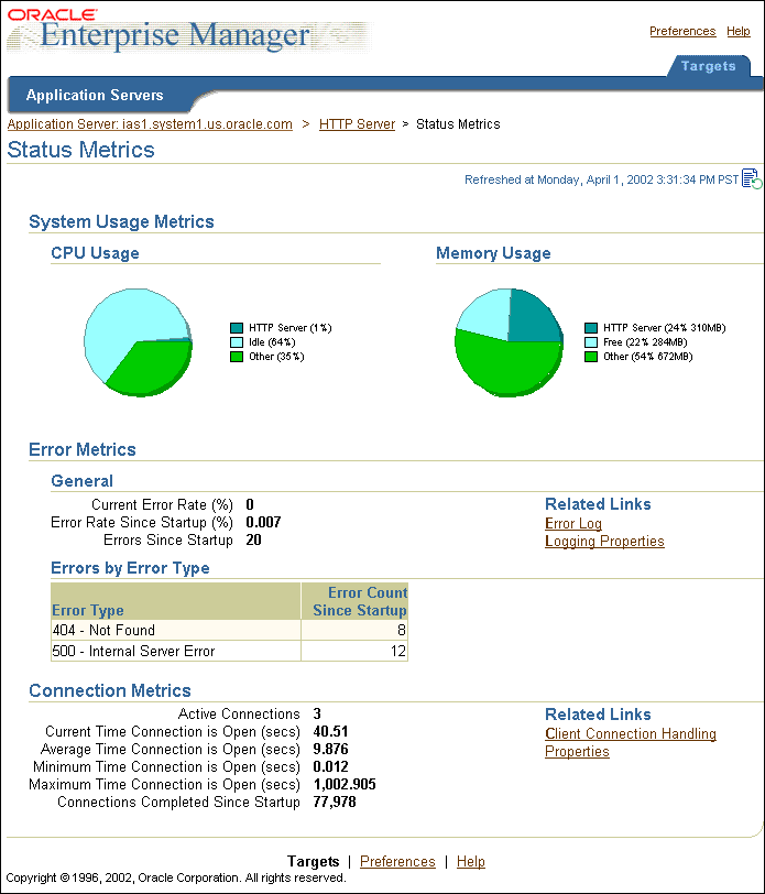

The Oracle Enterprise Manager status metrics provide information on CPU usage, memory usage, Oracle HTTP Server errors, and the number of active connections.
Figure 3-1 shows the Enterprise Manager HTTP Server status metrics page.

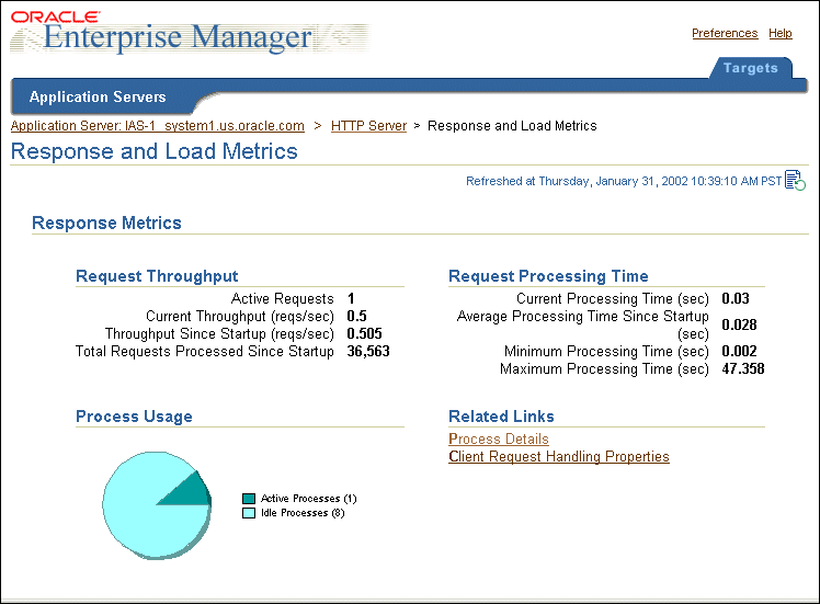

Figure 3-2 shows the Oracle Enterprise Manager Response and Load Metrics page. This page shows values for Oracle HTTP Server Active Requests and Request Throughput, and reports the average, minimum, and maximum processing time for requests. The values on the Response and Load Metrics page can help you assess the system load.

Using Oracle Enterprise Manager you can view the Error Metrics on the HTTP status page, as shown in Figure 3-1. Error Metrics include the current error rate, which is the number of errors occurring in the last five minutes as a percentage of the total requests, the error rate since startup, and the count of the total number of errors since startup. The Status Metrics page includes the Errors by Error Type table shown in Figure 3-1 which lists more details for HTTP errors, including the error types and error counts. This table breaks down each error into a category based on its HTTP error response type.
The data values shown for Errors by Error Type in Figure 3-1 indicate that most of the errors were due to requests for unknown URIs (404 - Not Found errors). On many Oracle HTTP Server sites, Not Found errors are relatively common. However, you should investigate reports showing a large numbers of Not Found errors, such as a number that is greater than 1% of the total requests.
To investigate errors in more detail, such as any reported internal errors, examine the error log by selecting the Error Log link under the Related Links heading. Using the error log, you should be able to determine more information about the URIs that are causing specific errors.

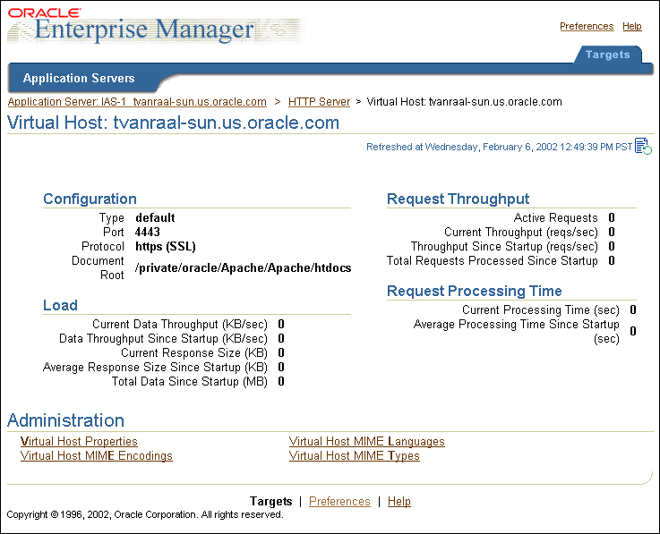

Figure 3-4 shows a display of the Virtual Host page. By viewing the Virtual Host page you should be able to obtain information about request processing by virtual host. The Request Throughput, Load, and Request Processing Time values provide information that enables you to identify a virtual host on your system that is processing a large number of requests, or that is using significant processing resources and may be stressing the system. This information should help you to categorize Oracle9iAS performance issues by virtual host.

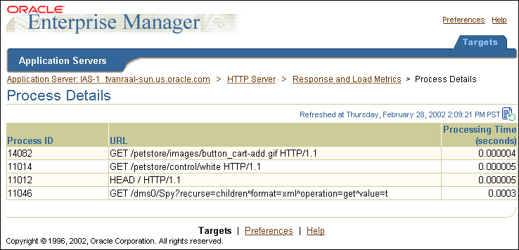

Running Oracle HTTP Server, usually you do not need to worry about which child server handles an individual request because any available child server can handle any incoming request (each request is handled by a free child server). However, if your Oracle9iAS system experiences delays or deadlocks, you may need to analyze the Oracle HTTP Server child server processes. The Process Details page available from Related Links section on the Response and Load Metrics page shows the Process ID for each active Oracle HTTP Server child process. Viewing this information allows you to monitor child servers to identify runtime problems, configuration errors, or application bugs that cause either request processing deadlocks or very long delays. In these situations analyzing the Process Details page can help determine where the deadlock or delay is occurring.
Figure 3-5 shows a Process Details page with Oracle HTTP Server child server information.
When viewing the Oracle HTTP Server Process Details page, note the following:
TimeOut directive.

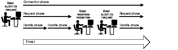

The metric table shown in Example 3-1 groups metrics into categories, including handle, request, and connection. The individual metric names in each category have the form name.metric, for example, connection.time. The metrics in these three categories describe the following:
handle
The phase in which a request is handled by an HTTP server module. Note that a single request may be handled by more than one HTTP server module. The handle metrics shown at the top level, in the ohs_server metric table, are summarized for all of the HTTP server modules.
request
The phase during which an HTTP server daemon reads a request and sends a response for it (first byte in, last byte out). There may be more than one request serviced during a single connection phase. This would be the case if the HTTP parameter KeepAlive were set and utilized by clients.
connection
The connection phase, starting from the time an HTTP connection is established to the time it is closed.
