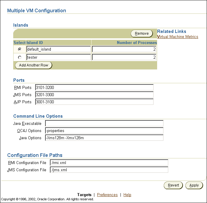

To change the Java command line options for an OC4J Instance, go to the home page for the OC4J Instance and perform the following steps:
For example, enter the following to set the JVM heap sizes to 128 Megabytes:
-Xmx128m
Figure 6-1 shows the Server Properties page with Java Options.

Oracle9iAS lets you configure multiple OC4J processes in an OC4J Instance. If there are sufficient resources on your system, you may be able to improve performance by configuring multiple OC4J processes for the OC4J Instance that services your J2EE application. Using multiple OC4J processes is the simplest form of load balancing without using Oracle9iAS clustering. Configuring an OC4J Instance to allow requests to be served by multiple OC4J processes can reduce or avoid contention and improve scalability. Oracle9iAS also supports multi node clustering for load balancing.
The optimal ratio of OC4J processes to CPUs is dependent on characteristics of the application, hardware configuration and JDK being used. But in general, for multi-cpu configurations with greater than two processors, you should consider configuring multiple OC4J processes. For example, on a recent test of a J2EE application, a single OC4J process was sufficient to use 70% of the resources on a four processor system. That statistic indicated that either adding a second OC4J process would be advantageous or that the incoming load was insufficient to utilize more of the machine resources. By monitoring the incoming load, we were able to determine that it was the former, and adding a second process improved performance.
Adding processes beyond the available resources of the system will not improve performance. For example, if one OC4J process is sufficient to saturate the CPU resources of a system, adding four more processes is not likely to improve performance and may, in fact, degrade it. A good starting point is to configure one OC4J process for every 2-3 CPUs and measure the improvement derived from adding additional processes.
Using Oracle Enterprise Manager you can specify the number of processes in an OC4J Instance using the OC4J Instance level configuration available on the OC4J Instance's home page.
If you configure your OC4J to use load-balancing with multiple OC4J processes running within the same island, and you do not want sessions to be replicated, make sure that the <distributable/> property is not set in the application's web.xml file.
It is often beneficial to spread J2EE application load among multiple OC4J Instances, especially when applications are run on a multiprocessor system. Running multiple OC4J Instances generally results in higher throughput and shorter response time, even on a single-processor host.
If your web site has many different applications deployed which have different requirements and needs, you may want to configure different OC4J Instances, each with the appropriate number of OC4J processes to service the different applications.
To deploy applications to different OC4J Instances, perform the following steps:
After deploying the applications to different OC4J Instances, you can monitor the performance to see if throughput increases, or the response time decreases.
