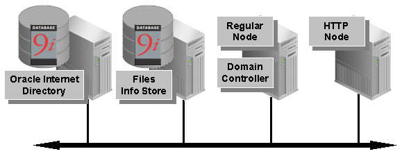

The Oracle Files Domain
An Oracle Files domain is a logical grouping of Oracle Files nodes, running under the control of the domain controller process, and an Oracle9i database instance (called the "Files Information Store") that contains the Oracle Files data.
Oracle Files Schema
The Oracle Files schema is created in an Oracle database during the configuration process. The schema owns all database objects, including metadata about Oracle Files and configuration information (see Figure 1-1).
An Oracle Files node is the application software that comprises the product, along with the underlying Java Virtual Machine (JVM) required to support the software at runtime. The Oracle Files domain controller process (the "domain controller") controls and manages the nodes making up the domain.
Figure 1-1 The Oracle Files Domain
Text description of fig1c1.gif follows.
Oracle Files Nodes
Important concepts to understand about nodes include:
Figure 1-2 Oracle Files Nodes
Text description of fig1c2.gif follows.
The relationship between the domain, the Oracle Files schema, and the domain controller is 1:1:1. However, the Oracle Files domain is a logical construct, not a physical one, which means that the Oracle Files domain controller process, node processes, and the database itself can be physically configured on a single host machine, as shown in Figure 1-3, or across several, separate hosts, as shown in Figure 1-4.

Figure 1-4 A Multiple-Machine Oracle Files Deployment
Text description of fig1c4.gif follows.
If you choose the single-machine configuration illustrated in Figure 1-3, you must ensure that your server meets the recommended hardware requirements for all components. Be aware that administration is more complex in a single-machine environment. In most cases, you should install Oracle Internet Directory on a separate machine.
With appropriate network load balancers and machine configuration, users may not be aware of whether the Oracle Files instance is running on one machine or across several machines. Users access content, such as folders and documents, using the appropriate client application for a particular Oracle Files protocol server.
