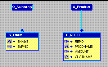

- Repeat the steps above for a second query, but this time name your query
Q_Product and use the following SELECT statement:
SELECT REPID, PRODNAME, AMOUNT, CUSTNAME
FROM SALES
ORDER BY REPID, CUSTNAME
Figure 11-2 Two-query data model without a link

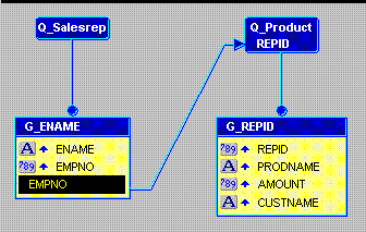

- In the Data Model view, click the Data Link tool in the tool palette.
- Click and drag from the EMPNO column in the G_ENAME group to the REPID column in the G_REPID group. Notice that a line is drawn from the bottom of the G_ENAME group to the Q_Product query. Labels for EMPNO and REPID are created at each end of the line to indicate they are the columns linking G_ENAME to Q_Product.
Figure 11-3 Two-query data model with a data link
- Double-click the new data link line to display the Property Inspector and examine the property settings:
- G_ENAME is identified as the parent, while Q_Product is listed as the child. In terms of the data, the sales rep's name and employee number make up the master record and should print once for the associated product information retrieved by the Q_Product query.
- Notice that WHERE already appears in the SQL Clause property. WHERE is the default clause used in master/detail relationships. You can replace WHERE with other SQL clauses such as HAVING and START WITH, but for this report the default is correct.
- The other point to notice is that an equal sign (=) appears in the Condition property. An equality (i.e., table1.columnname = table2.columnname) is the default condition for master/detail relationships defined via a data link. You can replace the equal sign with any other supported conditional operator (to see what's supported, click on the field), but for this report the default is the proper condition.
Linking the group G_ENAME and the query Q_Product via the EMPNO and REPID columns is analogous to writing both queries as the single-query shown below:
SELECT ENAME, EMPNO, REPID,
FROM EMP, SALES
WHERE JOB = 'SALESMAN'
AND EMPNO = REPID (+)

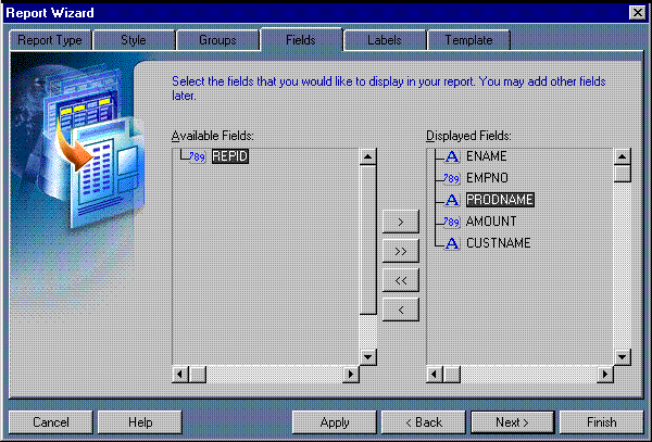

- On the Fields page:
- Click the double right arrows (>>) to move all of the fields to the Displayed Fields list.
- Click REPID in the Displayed Fields list and click the left arrow (<) to move it back to the Available Fields list. Since REPID and EMPNO represent the same value, you only need to display one of them. EMPNO is part of the master group, which is the level where we want to see its values in the report. REPID is part of the detail group. Hence, you remove REPID from the Displayed Fields list to prevent it from appearing in the output.

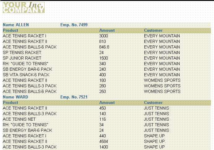

The final report output should look something like this:
Figure 11-6 Group above report output with monetary values formatted
