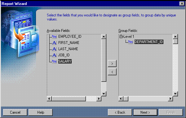

- On the Groups page, click DEPARTMENT_ID and click the right arrow (>) to move this field to the Group Fields list, then click Next.
Figure 10-2 Groups page of the Report Wizard

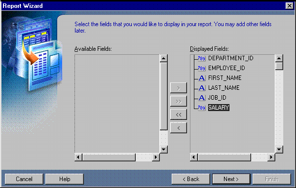

- On the Fields page, click the double right arrows (>>) to move all of the fields to the Displayed Fields list.
Figure 10-3 Fields page of the Report Wizard

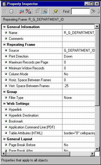

10.2.3 Use the Property Inspector to add white space
If you examine your report output in the Paper Design view, you will notice that it can be difficult to distinguish where one department's data ends and the next department's data begins. To make the report more readable, you want to add some white space between the departments, but you want to retain the same spacing between employee rows. For this report, you'll change a repeating frame property for the master repeating frame to create some white space between the department records.
To create white space between the departments:
- In the Paper Design view, click the first number value underneath the Department Id label. Notice that all of the department numbers are immediately selected.
- Click the Select Parent Frame button in the toolbar. Notice how the border of the repeating frame that contains the Department Id field is now highlighted.
- Choose Tools > Property Inspector to display the Property Inspector, and set properties:
- Under Repeating Frame, set the Vert. Space Between Frames property to 0.25.
Figure 10-6 Property Inspector for master repeating frame
- Click the title bar of the Report Editor to make it the active window again.
- Save your report.
Figure 10-7 Paper Design view after white space is added

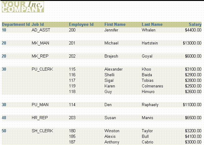

10.3 Group report with two break columns
Figure 10-8 Group left report output with two break columns
The report above looks similar to the group left report you built in Section 10.2, "Group report with one break column". However, notice that DEPARTMENT_ID values sometimes print more frequently than they did in the previous report. The DEPARTMENT_ID value repeats for each unique value of JOB_ID within the department. This behavior occurs because DEPARTMENT_ID is now grouped with JOB_ID and must print with JOB_ID. While DEPARTMENT_ID values may repeat several times, not until the position of PU_CLERK in department 30 does a job repeat, and not until that point can the break group actually break.
Concepts
- You can specify that your report break on certain combinations of information by varying the columns you include in the break group.
- You can modify your previous report by moving JOB_ID into the break group, so that your report has two break columns instead of one.
- After changing the data model, redefault the layout to incorporate your changes, then specify the format mask again.

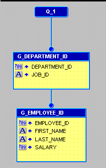

10.3.1 Modify the data model
The first task in changing your previous report is to modify the data model by placing an additional column in the break group.
To add a column to the break group:
- Open the report you created in the previous section.
- In the Object Navigator, double-click the view icon next to the Data Model node to display the Data Model view.
- In the Data Model view, click the break group, G_DEPARTMENT_ID, then click and drag the handle on the bottom center of the G_DEPARTMENT_ID group box down about a quarter of an inch to resize it.
- Click and drag on the JOB_ID column in the G_EMPLOYEE_ID group and move it into the G_DEPARTMENT_ID group, underneath the DEPARTMENT_ID column.
Figure 10-9 Data model with two break columns

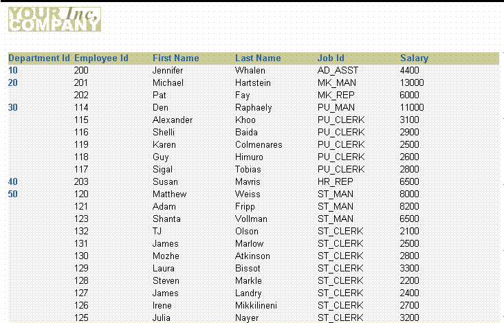

10.3.2 Redefault the layout
In order for your data model change to be reflected in your output, you need to redefault the layout for your report using the Report Wizard.
To redefault the layout with the Report Wizard:
- Click the title bar of the Report Editor to make it the active window. The Report Editor must be the active window in order for you to access the Report Wizard.
- Choose Tools > Report Wizard.
- Select Create Paper Layout only.
- Click Finish. Notice the changes to the output in the Paper Design view. Also note how the formatting of the Salary field and the additional spacing between records is retained. When possible, Reports Builder will retain your manual modifications between uses of the Report Wizard.
- Save your report.

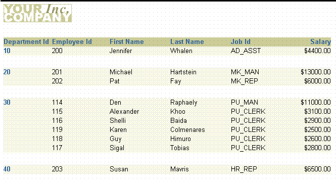

10.4 Group report with two break groups
Figure 10-10 Group left report output with two break groups
The figure above shows a further modification of your group left report. In this version, DEPARTMENT_ID prints only once for each department. JOB_ID also prints only once when more than one employee in a department has the same job. Both columns are now in separate break groups and DEPARTMENT_ID is in the higher group. Hence, it does not repeat for each unique value of JOB_ID within a department any more.
Concepts
- You can also create reports that include multiple break groups and assign one or more columns to each break group.
- You'll further modify the data model to include two break groups: G_DEPARTMENT_ID and G_JOB_ID.
To see a sample group left report with two break groups, open the examples folder named break, then open the Oracle Reports example named grp_lft2.rdf. For details on how to access it, see "Accessing the example reports" in the Preface.
