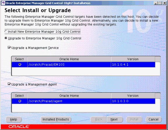

Start Oracle Universal Installer by running the runInstaller script in Linux (go to the top-level folder in the contents copied from the DVD and execute ./runInstaller or setup.exe on Microsoft Windows) from the top directory of Disk1.
When you invoke Oracle Universal Installer, you will be presented with two choices:
Perform a new Enterprise Manager Grid Control installation
See Understanding the Installation Types for more information.
Products Upgrade
Select this option to continue with the upgrade process.
Click Products Upgrade. The Select Install or Upgrade screen appears.
The installer automatically detects the Grid Control components that require an upgrade and lists them in this screen.
Here, you can choose to perform the following upgrades:
OMS and the associated (monitoring) Management Agent
Only the OMS
Only the Management Agent
Caution:
If you are upgrading both OMS and Agent (which is part of a chain agent installation), ensure the agent you have selected is the one that is communicating with selected OMS.Also, ensure you shut down the agent and the OMS that you are going to upgrade, before starting the process.
Select the Oracle homes that you want to upgrade and click Next. The Specify Installation Location screen appears.

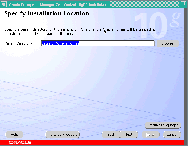

Here, specify a parent directory (base directory), for example, /scratch/OracleHomes, for the new installation. because the installer is going to perform an out-of-placeFoot 2 upgrade, all the Oracle homes created during the upgrade will be placed as subdirectories under this parent directory.
Click Next. The Product-Specific Prerequisite Checks screen appears.

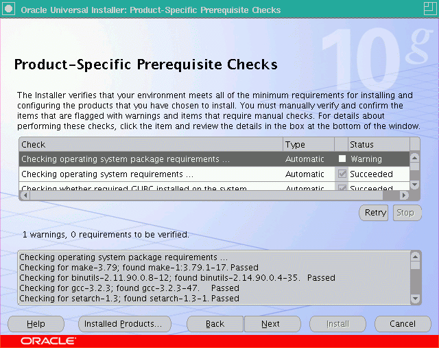

At this point, the installer runs some prerequisite checks to verify whether or not the environment meets the minimum requirements for a successful Enterprise Manager installation.
Early detection of problems with the system setup reduces the chances of you encountering problems during installation; for instance, problems with insufficient disk space, missing patches, inappropriate hardware, and so on.
This page displays the check name, type, and status for all prerequisite checks designed for the installation. Automatic checks are run first, followed by optional and manual checks.
Depending on the status of the automatic checks, you must verify all warning and manual checks. At some point, if you have stopped the prerequisite check and want to rerun these checks, select the checks that you want to rerun and click Retry. As each check runs, a progress bar is shown, and test details (expected results, actual results, error messages, instructions) are displayed in the details section, at the bottom of the page.
To stop all prerequisite checks, click Stop. At any point of time, click a prerequisite check to view its corresponding details, including the recommended user actions.
You must manually verify and confirm all checks that were flagged with a warning, skipped (stopped by user), or failed.To continue with the installation without retrying, click Next.
The Specify Configuration screen appears.

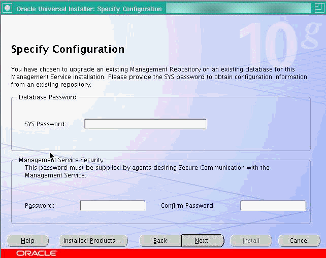

Here, you must specify the existing Database and Secure OMS passwords. The Database Password (SYS) is required to access the configuration files of the existing database repository that is associated with the OMS that you have selected for upgrade.
In the Database password section, specify the SYS Password (the default super administrator account) for the existing database repository that is associated with the selected OMS.
In the Management Service Security section, specify a password that will be used to secure the communications between the OMS and its agents.
Management Service Security: This section is enabled only when the existing OMS that you are upgrading is not secure.Click Next. If you are upgrading both OMS and Agent, but only the existing OMS is secure and locked, then the Agent Registration Password screen appears. Here, you must provide the correct password to enable communications between the secure OMS and the agent that you are upgrading.

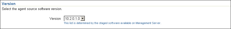

In the Version section of this page, select the appropriate version of the agent software that you want to use for upgrade.
The values in this list will depend on the staged software that are available on the OMS host.In the Hosts section, do the following:

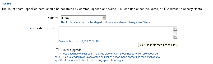

In the Provide Host List text box, specify all the hosts (host names or IP addresses) on which you want to perform the Agent installation. Alternatively, click Get Host Names From File to browse and select the file that contains a list of all the required host names.
WARNING:
Do not specify duplicate entries of the host list. If there are duplicate host entries in this list, the application hangs.
Use the same host names for which the SSH has been set.
You can use either a comma (,) or white space as a separator when specifying multiple hosts.Caution:
The Agent Deploy application picks up only the values in the first column of the Host List file that you specify or select.Ensure the host list format is appropriate, since the Agent Deploy application does not validate this format on the selected file.
A sample host list format is provided in Table 22-3.
Select Cluster Upgrade if you want to upgrade the Management Agent cluster.
The hosts that you specify must belong to the same cluster. Also, note that only the hosts that you specify here will be upgraded, irrespective of the number of hosts in that cluster. For example, if there are 10 hosts in a cluster and you specify only 5 here, Agent Deploy will upgrade only those five hosts in the cluster that you have specified.In the OS Credential section, specify the appropriate operating system user credentials. Select Run root.sh (UNIX platforms only) if you want Agent Deploy to execute this script.

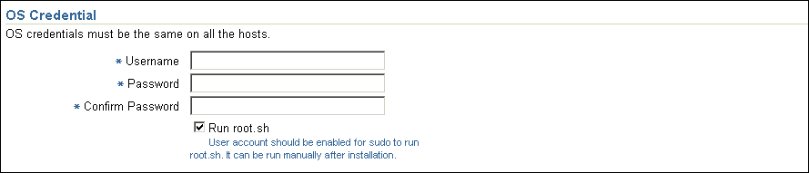

The root.sh script runs after the configuration assistants are run and before the postinstallation scripts (if any) are run. If you do not select this option here, you must run root.sh on each node manually.
Agent Deploy application uses sudo to run the root.sh script. You must specify the invoking user's password here.
If /etc/sudoers is configured in such a way that sudo never prompts for a password, then a directory with the host password as the title gets created in the invoking users home directory. To avoid this, ensure that you configure /etc/sudoers file such that running a command using sudo always prompt for a password.

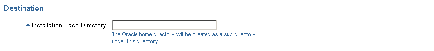

In the Existing Agent Information section, specify the full path to an existing agent Oracle home location. This source agent installation will be used to perform the upgrade.
The path of the source agent should be the same on all the remote hosts.In the Destination section, specify the absolute path for the Installation Base Directory. This directory will be created on all the specified hosts, and the Agent Oracle home directory will be created as a subdirectory under this directory.

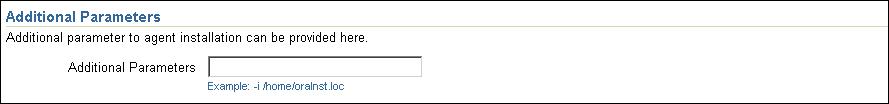

In the Additional Parameters text box, specify any additional parameters that you want to pass during installation.
Oracle recommends you to specify only those parameters that you want to run in addition to the general parameters you have already provided in this page for upgrade. For example, in step (7), you are providing the installation base directory. Therefore, for additional parameters, try to avoid specifying the installation base directory again. If you still do so, then the value you specified in step (7) will be ignored and the value you specified here will be used instead.
The following are the additional parameters you can specify:
Specify -t if you do NOT want to start the Agent after installation or upgrade. No value required.
Specify -d if you do NOT want to initiate automatic target discovery. No value required.
Specify -i if you want to provide an Inventory pointer location file. For example, -i /etc/oraInst.loc.
Specify -p if you want to provide a file location for Static port for Agent. For example, -p /home/config/staticports.ini.
