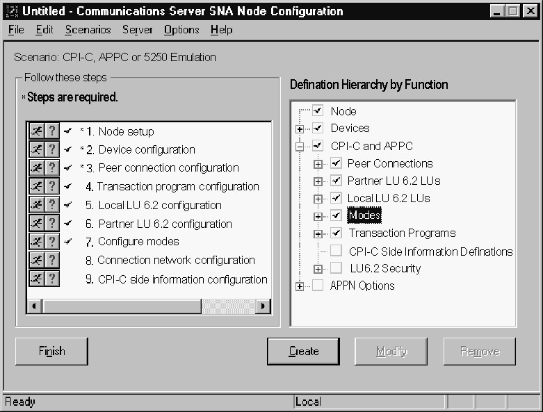

7.4.1.1 Creating the Configuration

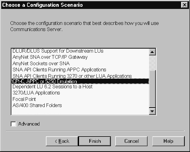

SNA Node Configuration will first ask if you are creating a new configuration or loading an existing configuration. The following example is presented with the assumption that a new configuration is being created.
SNA Node Configuration will next prompt you for a configuration scenario. Our example is made assuming that a CPI-C or APPC scenario is being chosen.

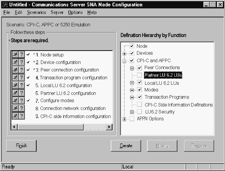

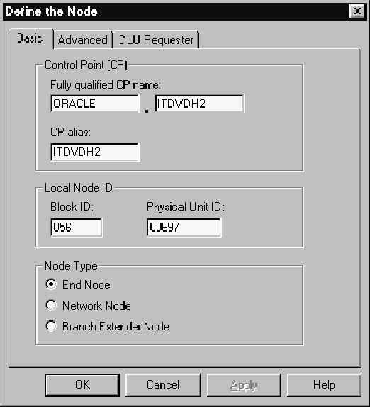

7.4.1.2 Defining the Node
Each SNA Server must have a Control Point defined. This is typically called the Node definition. Click Node and click Create.
Figure 7-3 Node Definition
Description of Figure 7-3 follows
Description of "Figure 7-3 Node Definition"
In the Define the Node dialog box, in the Basic tab, enter the Control Point, Local Node ID, and Node Type information. You can also select option in the Advanced tab depending on your SNA network configuration. Click OK.

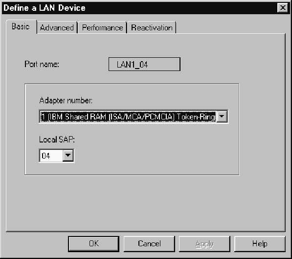

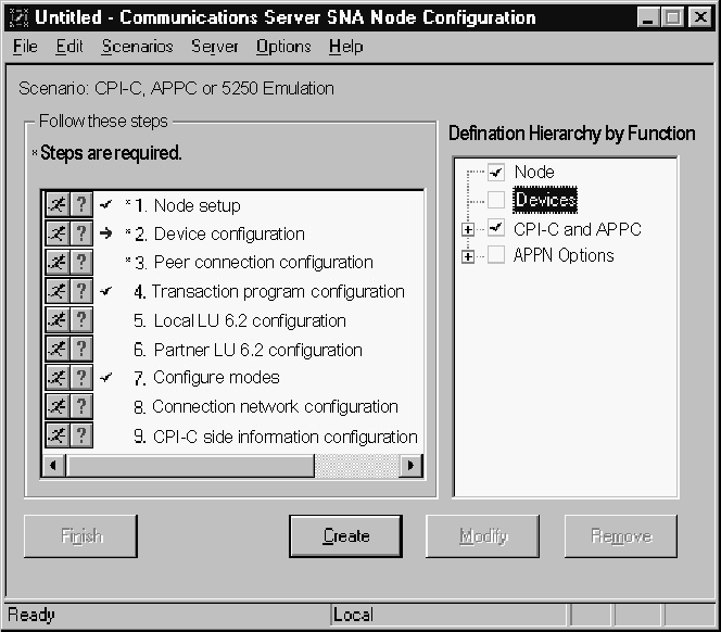

Communication devices should be configured next. Select Devices, and click Create.

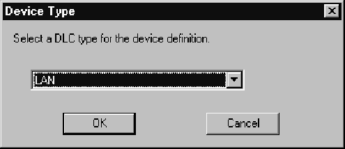

Figure 7-5 Choosing the Device Type
Description of Figure 7-5 follows
Description of "Figure 7-5 Choosing the Device Type"
Select the type of device to use for communication. The LAN type is typical for either Ethernet or Token-ring attached network devices.

In the Basic tab, select the adapter to use and the local SAP. The other tabs may be explored for network tuning parameters. Click OK.

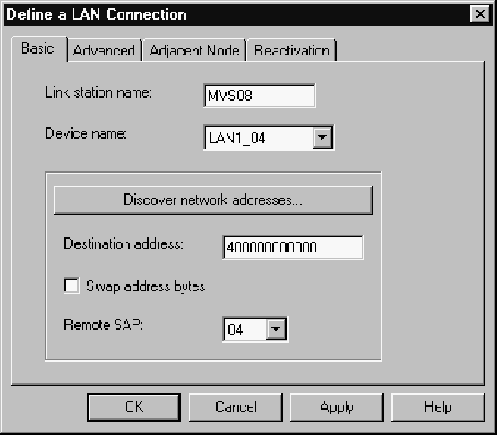

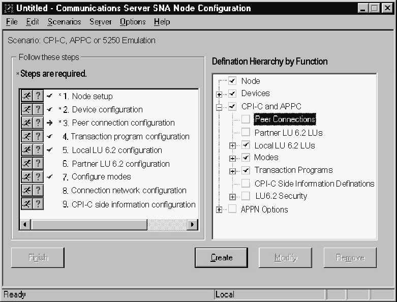

Peer connections should be configured next. Select Peer Connections, and click Create.
Figure 7-8 Defining the Link station
Description of Figure 7-8 follows
Description of "Figure 7-8 Defining the Link station"
In the Basic tab, enter a link station name for this connection. Choose the Device for the connection, and enter the destination address and remote SAP.

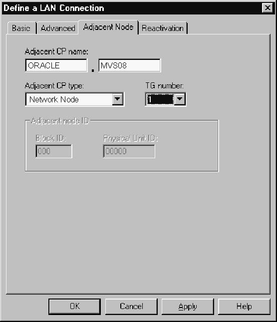

Select the Adjacent Node tab. Enter the Adjacent CP name of the remote system and pick its CP Type. You may have to choose a different Transmission Group (TG) as the default. Consult your SNA Network Administrator for details. The other tabs may be explored for tuning and link reactivation options. Click OK.

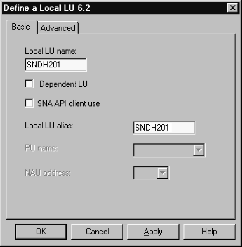

Next, define the local LUs for this Node. Select Local LU 6.2 LUs, and click Create.

In the Basic tab, enter the name of the local LU and an alias, if desired. The name must match the Local LU definition of the remote host for this node. The Advancedtab may be explored for Synchronization support and for LU session limits. Click OK.

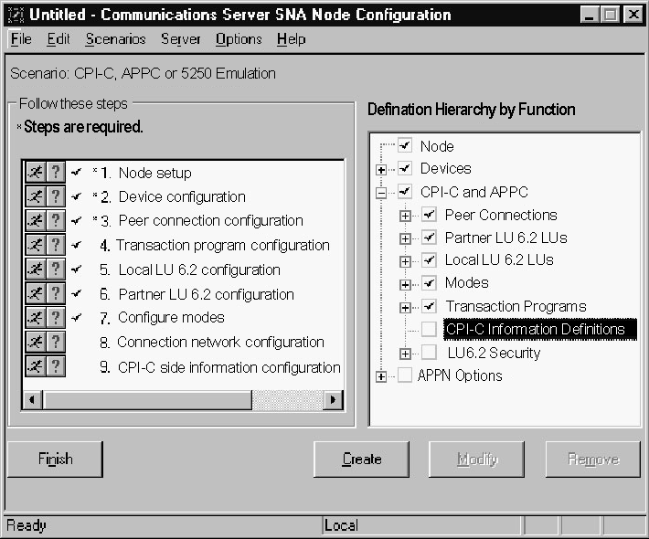

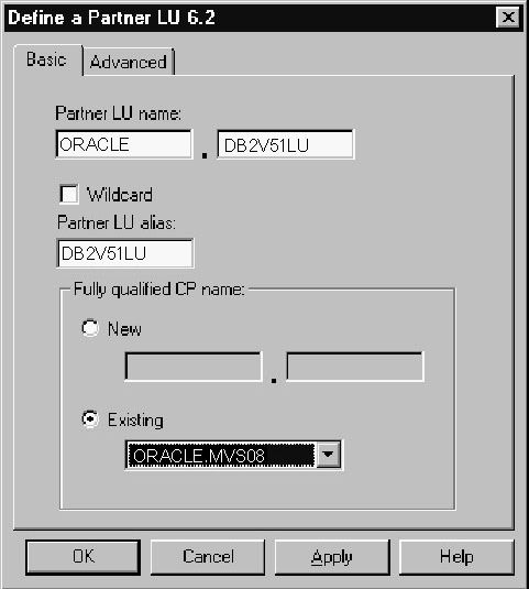

Next, define remote Partner LUs for this Node to connect to. Select Partner LU 6.2 LUs and click Create.
Figure 7-13 Defining Partner LUs
Description of Figure 7-13 follows
Description of "Figure 7-13 Defining Partner LUs"
In the Basic tab, enter the name of the remote or partner LU and an alias, if desired. Seclect Fully Qualified CP from the existing list. The Advanced tab may be explored for logical record limits and security support. Click OK.

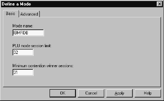

Next, define the IBMRDB mode, which will be used for DRDA connections. Select Modes and click Create.
Figure 7-15 Define the IBMRDB Mode
Description of Figure 7-15 follows
Description of "Figure 7-15 Define the IBMRDB Mode"
In the Basic tab, enter the name IBMRDB and the mode session limits. Consult your SNA Network Administrator for details. The Advanced tab may be explored for pacing and autoactivation session options. Click OK.

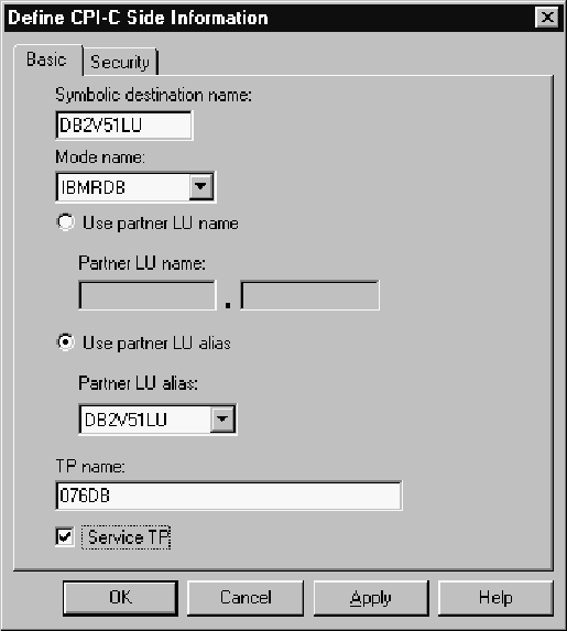

Next, define the CPI-C profile that will be use dby the gateway. Select CPI-C side information definitions and click Create.
Figure 7-17 Define the CPI-C Side Information Profile
Description of Figure 7-17 follows
Description of "Figure 7-17 Define the CPI-C Side Information Profile"
In the Basic tab, enter the Symbolic Destination name. Select IBMRDB for the Mode name drop-down list, and select the Partner LU either by name or by alias. Enter the TP name for the remote DRDA Server. Mode DRDA Servers use the default Service TP name X'07F6C4C2' or '076DB'. Consult your DRDA Server Administrator for the correct TP name. The Advancedtab may be explored for security options.
The DRDA_CONNECT_PARM should be assigned the name of the Symbolic Destination name as entered in Figure 7-16, "Create the CPI-C Side Information Profile".
