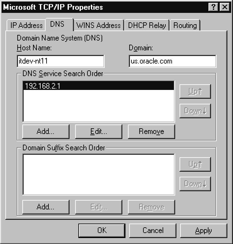

To use a name server, you must configure the TCP/IP to use DNS. Select the DNS tab and enter a host name and domain name. Your network administrator will provide these values. Click Add below the Domain Suffix Search Order box and enter the IP Address of the name server. You may enter up to three name servers. Click OK.
