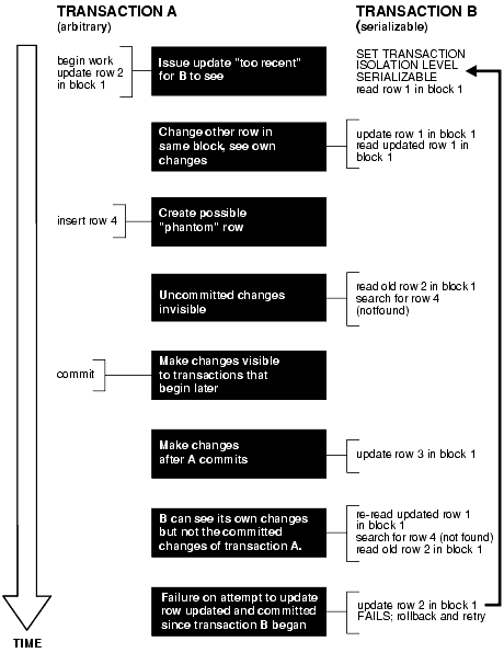

Ensuring Repeatable Reads with Read-Only Transactions
By default, the consistency model for Oracle Database guarantees statement-level read consistency, but does not guarantee transaction-level read consistency (repeatable reads). If you want transaction-level read consistency, and if your transaction does not require updates, then you can specify a read-only transaction. After indicating that your transaction is read-only, you can execute as many queries as you like against any database table, knowing that the results of each query in the read-only transaction are consistent with respect to a single point in time.
A read-only transaction does not acquire any additional data locks to provide transaction-level read consistency. The multi-version consistency model used for statement-level read consistency is used to provide transaction-level read consistency; all queries return information with respect to the system change number (SCN) determined when the read-only transaction begins. Because no data locks are acquired, other transactions can query and update data being queried concurrently by a read-only transaction.
Long-running queries sometimes fail because undo information required for consistent read operations is no longer available. This happens when committed undo blocks are overwritten by active transactions. Automatic undo management provides a way to explicitly control when undo space can be reused; that is, how long undo information is retained. Your database administrator can specify a retention period by using the parameter UNDO_RETENTION.
See Also:
Oracle Database Administrator's Guide for information on long-running queries and resumable space allocation
For example, if UNDO_RETENTION is set to 30 minutes, then all committed undo information in the system is retained for at least 30 minutes. This ensures that all queries running for 30 minutes or less, under usual circumstances, do not encounter the OER error, "snapshot too old."
A read-only transaction is started with a SET TRANSACTION statement that includes the READ ONLY option. For example:
SET TRANSACTION READ ONLY;
The SET TRANSACTION statement must be the first statement of a new transaction; if any DML statements (including queries) or other non-DDL statements (such as SET ROLE) precede a SET TRANSACTION READ ONLY statement, an error is returned. Once a SET TRANSACTION READ ONLY statement successfully executes, only SELECT (without a FOR UPDATE clause), COMMIT, ROLLBACK, or non-DML statements (such as SET ROLE, ALTER SYSTEM, LOCK TABLE) are allowed in the transaction. Otherwise, an error is returned. A COMMIT, ROLLBACK, or DDL statement terminates the read-only transaction; a DDL statement causes an implicit commit of the read-only transaction and commits in its own transaction.

How Serializable Transactions Interact
Figure 2-1 shows how a serializable transaction (Transaction B) interacts with another transaction (A, which can be either SERIALIZABLE or READ COMMITTED).
When a serializable transaction fails with an ORA-08177 error ("cannot serialize access"), the application can take any of several actions:
  • Commit the work executed to that point
  • Execute additional, different, statements, perhaps after rolling back to a prior savepoint in the transaction
  • Roll back the entire transaction and try it again
Oracle Database stores control information in each data block to manage access by concurrent transactions. To use the SERIALIZABLE isolation level, you must use the INITRANS clause of the CREATE TABLE or ALTER TABLE command to set aside storage for this control information. To use serializable mode, INITRANS must be set to at least 3.

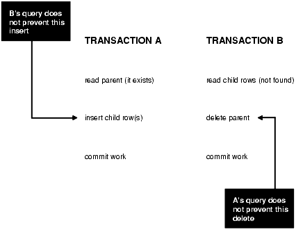

Referential Integrity and Serializable Transactions
Because Oracle Database does not use read locks, even in SERIALIZABLE transactions, data read by one transaction can be overwritten by another. Transactions that perform database consistency checks at the application level should not assume that the data they read will not change during the execution of the transaction (even though such changes are not visible to the transaction). Database inconsistencies can result unless such application-level consistency checks are coded carefully, even when using SERIALIZABLE transactions. Note, however, that the examples shown in this section are applicable for both READ COMMITTED and SERIALIZABLE transactions.
Figure 2-2 shows two different transactions that perform application-level checks to maintain the referential integrity parent/child relationship between two tables. One transaction checks that a row with a specific primary key value exists in the parent table before inserting corresponding child rows. The other transaction checks to see that no corresponding detail rows exist before deleting a parent row. In this case, both transactions assume (but do not ensure) that data they read will not change before the transaction completes.
Figure 2-2 Referential Integrity Check
Description of Figure 2-2  follows
Description of "Figure 2-2 Referential Integrity Check"
The read issued by transaction A does not prevent transaction B from deleting the parent row, and transaction B's query for child rows does not prevent transaction A from inserting child rows. This scenario leaves a child row in the database with no corresponding parent row. This result occurs even if both A and B are SERIALIZABLE transactions, because neither transaction prevents the other from making changes in the data it reads to check consistency.
As this example shows, sometimes you must take steps to ensure that the data read by one transaction is not concurrently written by another. This requires a greater degree of transaction isolation than defined by SQL92 SERIALIZABLE mode.
Using SELECT FOR UPDATE
Fortunately, it is straightforward in Oracle Database to prevent the anomaly described:
  • Transaction A can use SELECT FOR UPDATE to query and lock the parent row and thereby prevent transaction B from deleting the row.
  • Transaction B can prevent Transaction A from gaining access to the parent row by reversing the order of its processing steps. Transaction B first deletes the parent row, and then rolls back if its subsequent query detects the presence of corresponding rows in the child table.
Referential integrity can also be enforced in Oracle Database using database triggers, instead of a separate query as in Transaction A. For example, an INSERT into the child table can fire a BEFORE INSERT row-level trigger to check for the corresponding parent row. The trigger queries the parent table using SELECT FOR UPDATE, ensuring that parent row (if it exists) remains in the database for the duration of the transaction inserting the child row. If the corresponding parent row does not exist, the trigger rejects the insert of the child row.

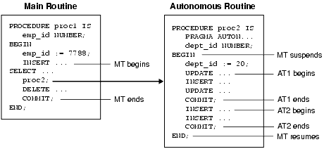

At times, you may want to commit or roll back some changes to a table independently of a primary transaction's final outcome. For example, in a stock purchase transaction, you may want to commit a customer's information regardless of whether the overall stock purchase actually goes through. Or, while running that same transaction, you may want to log error messages to a debug table even if the overall transaction rolls back. Autonomous transactions allow you to do such tasks.

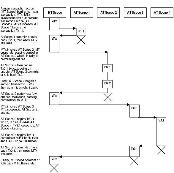

An autonomous transaction (AT) is an independent transaction started by another transaction, the main transaction (MT). It lets you suspend the main transaction, do SQL operations, commit or roll back those operations, then resume the main transaction.
An autonomous transaction executes within an autonomous scope. An autonomous scope is a routine you mark with the pragma (compiler directive) AUTONOMOUS_TRANSACTION. The pragma instructs the PL/SQL compiler to mark a routine as autonomous (independent). In this context, the term routine includes:
  • Top-level (not nested) anonymous PL/SQL blocks
  • Local, standalone, and packaged functions and procedures
  • Methods of a SQL object type
  • PL/SQL triggers

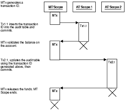

Figure 2-3 shows how control flows from the main routine (MT) to an autonomous routine (AT) and back again. As you can see, the autonomous routine can commit more than one transaction (AT1 and AT2) before control returns to the main routine.
Figure 2-3 Transaction Control Flow
Description of Figure 2-3  follows
Description of "Figure 2-3 Transaction Control Flow"
When you enter the executable section of an autonomous routine, the main routine suspends. When you exit the routine, the main routine resumes. COMMIT and ROLLBACK end the active autonomous transaction but do not exit the autonomous routine. As Figure 2-3 shows, when one transaction ends, the next SQL statement begins another transaction.
A few more characteristics of autonomous transactions:
  • The changes autonomous transactions effect do not depend on the state or the eventual disposition of the main transaction. For example:
    • An autonomous transaction does not see any changes made by the main transaction.
    • When an autonomous transaction commits or rolls back, it does not affect the outcome of the main transaction.
  • The changes an autonomous transaction effects are visible to other transactions as soon as that autonomous transaction commits. This means that users can access the updated information without having to wait for the main transaction to commit.
  • Autonomous transactions can start other autonomous transactions.
Figure 2-4 illustrates some of the possible sequences autonomous transactions can follow.
Figure 2-4 Possible Sequences of Autonomous Transactions
Description of Figure 2-4  follows
Description of "Figure 2-4 Possible Sequences of Autonomous Transactions"

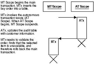

Entering a Buy Order
In this example, illustrated by Figure 2-5, a customer enters a buy order. That customer's information (such as name, address, phone) is committed to a customer information table—even though the sale does not go through.
Figure 2-5 Example: A Buy Order
Description of Figure 2-5  follows
Description of "Figure 2-5 Example: A Buy Order"
Example: Making a Bank Withdrawal
In this example, a customer tries to make a withdrawal from a bank account. In the process, a main transaction calls one of two autonomous transaction scopes (AT Scope 1, and AT Scope 2).
The following diagrams illustrate three possible scenarios for this transaction.
  • Scenario 1: There are sufficient funds to cover the withdrawal and therefore the bank releases the funds
  • Scenario 2: There are insufficient funds to cover the withdrawal, but the customer has overdraft protection. The bank therefore releases the funds.
  • Scenario 3: There are insufficient funds to cover the withdrawal, the customer does not have overdraft protection, and the bank therefore withholds the requested funds.
Scenario 1
There are sufficient funds to cover the withdrawal and therefore the bank releases the funds. This is illustrated by Figure 2-6.
Figure 2-6 Example: Bank Withdrawal—Sufficient Funds
Description of Figure 2-6  follows
Description of "Figure 2-6 Example: Bank Withdrawal—Sufficient Funds"

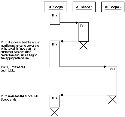

Scenario 2
There are insufficient funds to cover the withdrawal, but the customer has overdraft protection. The bank therefore releases the funds. This is illustrated by Figure 2-7.
Figure 2-7 Example: Bank Withdrawal—Insufficient Funds WITH Overdraft Protection
Description of Figure 2-7  follows
Description of "Figure 2-7 Example: Bank Withdrawal—Insufficient Funds WITH Overdraft Protection"

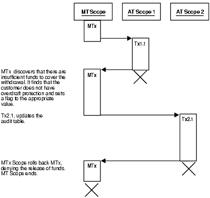

Scenario 3
There are insufficient funds to cover the withdrawal, the customer does not have overdraft protection, and the bank therefore withholds the requested funds. This is illustrated by Figure 2-8.
Figure 2-8 Example: Bank Withdrawal—Insufficient Funds WITHOUT Overdraft Protection
Description of Figure 2-8  follows
Description of "Figure 2-8 Example: Bank Withdrawal—Insufficient Funds WITHOUT Overdraft Protection"
