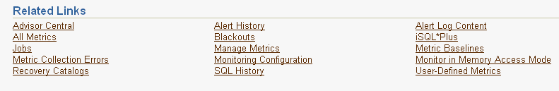

Suggested related links for more information.
Figure 3-3 Database Home Page Related Links

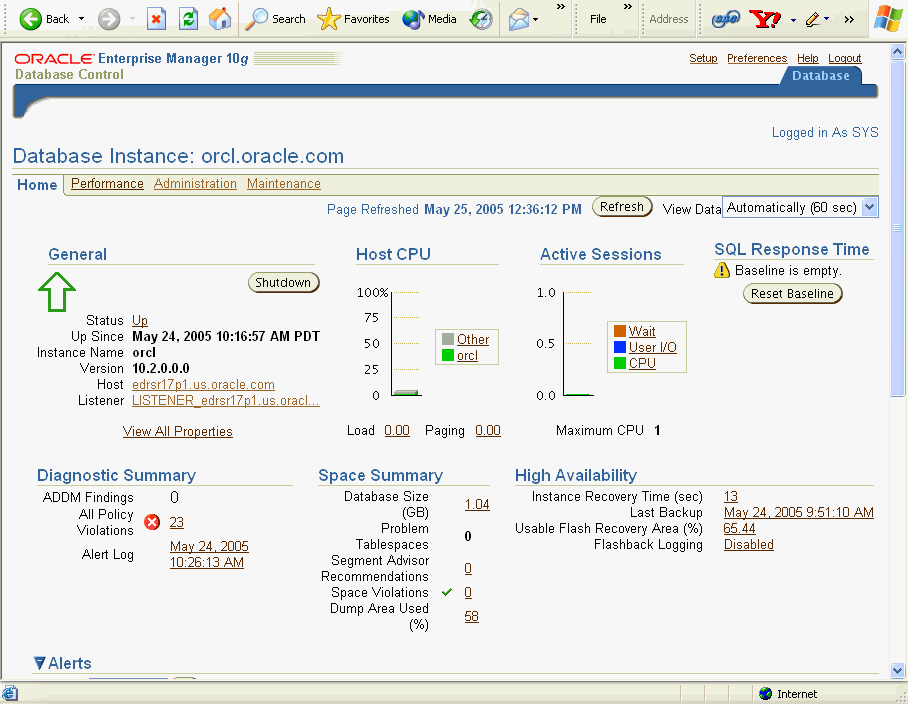

Enterprise Manager displays the Database Home page (Figure 3-4).
The property pages across the top of the page enable you to access performance, administration, and maintenance pages for managing your database. The functionality provided by these pages is discussed in other chapters of this book.
The various sections of the Database Home page and related links provide information about the database's environment and health. For example, the Alerts, Related Alerts, and Diagnostic Summary sections warn you of errors and performance problems that are impacting the operation of your database. You can click the provided links to see more detail about the problem area, and even to obtain recommendations for resolving the problem. This is discussed in Chapter 10, "Monitoring and Tuning the Database".
