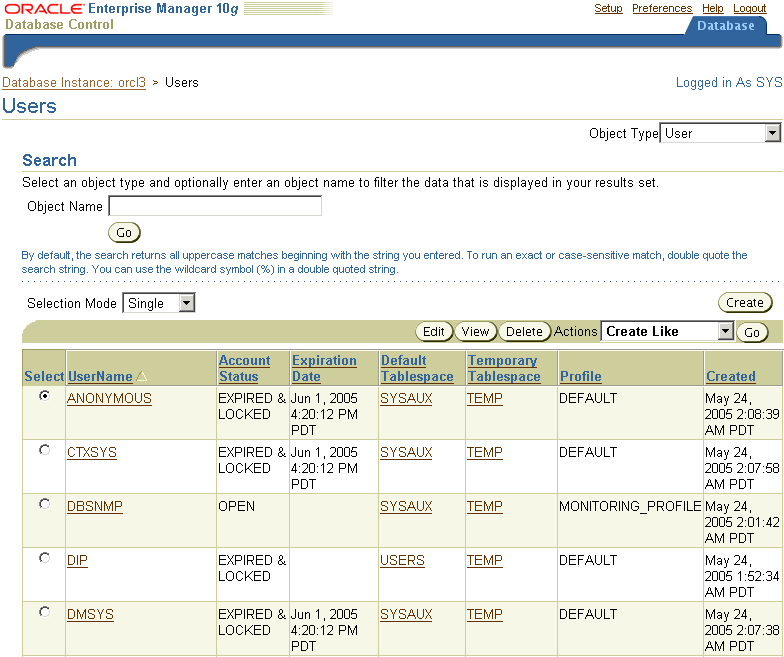

In the Users & Privileges section of the Administration home page, click Users. The Users page appears, as shown in Figure 7-2. From this page you can view, add, edit, or delete database users.

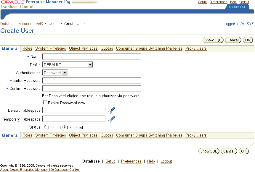

In this section, you create a user named MYUSER, set the password, and assign MYUSER to the USERS tablespace. This series of tasks enables myuser to log in to the database. Later, you learn how to edit and assign roles to this user.
To create a database user, perform the following tasks as user SYS or SYSTEM:
On the Users page, click Create.
The Create Users General page shown in Figure 7-3 is displayed. The General page is one of a series of pages in the Users property page.
In the Name box, enter a user name. For example, enter MYUSER.
In the Profile list, accept the value DEFAULT. The profile specifies the resource limit.
Note that this profile does not allow the user to log in to Enterprise Manager, which would require the user to be assigned the DBA role. For more information, see "Administering Roles".
In the Authentication list, accept the value Password. For advanced authentication schemes, see Oracle Database Security Guide.
In the Enter Password and Confirm Password boxes, enter your password.
Do not check Expire Password now. If the account status to set to expired, then the user or the database administrator must change the password before the user can log in to the database.
For the Default Tablespace field, click the flashlight icon and select the USERS tablespace. While users can specify different defaults for each user, it is easiest to define a default permanent tablespace and a default temporary tablespace at the database level, instead of the user level. For more information on the USERS tablespace, see "Some Tablespaces in the Database".
For the Temporary Tablespace field, click the flashlight icon and select the TEMP tablespace. For more information on the TEMP tablespace, see "Some Tablespaces in the Database".
In Status, select Unlocked.
You can later lock an account to keep a user out of the database. Locking an account is preferable to deleting a user, which removes all associated tables and data.
Click OK.
The Users page appears. You can now see an entry for the new user myuser.

Locked accounts cannot be accessed by the user. During installation, you can unlock and reset the Oracle-supplied database user accounts. If you did not choose to unlock those accounts at that time, then you can do so now.
To unlock database account:
From the Users page shown in Figure 7-2, select a user whose Account Status is shown as EXPIRED AND LOCKED. For example, select DMSYS.
From the Actions list, select Unlock User and click Go.
Click Yes to the confirm that you want to unlock the user.
This action unlocks the user account. The Account Status is now EXPIRED. This action does not reset the password, so the user is still unable to log in to the database.
From the Users page, select the same user and click Edit.
The Edit User General page appears.
Enter a password for the account and click Apply.
You must follow the preceding steps individually for each account that you want to unlock and reset.
