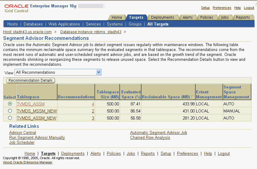

From the Space Summary section of the Administration page, click the link adjacent to Segment Advisor Recommendations. Figure 6-2, "Home Page Space Summary" shows the link.
The Segment Advisor Recommendations page appears, as shown in Figure 6-3, "Segment Advisor Recommendations".

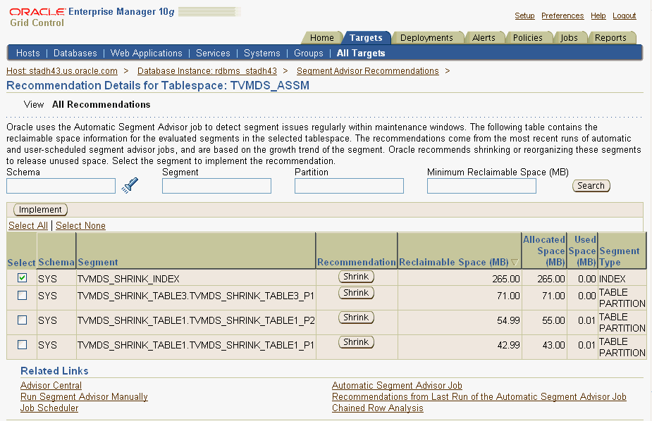

Select a tablespace and then click Recommendation Details.
The Recommendation Details for Tablespace page appears, as shown in Figure 6-4, "Segment Advisor Recommendation Details". This page lists the tablespace segments that are eligible for shrinking.

Click Shrink next to the segment you want to shrink.
Select one or more segments and click Implement.
The Shrink Segment: Options page appears.
You can also reorganize an object at this step. To do so, click the Reorg button and continue with the reorganization wizard.
Accept Compact Segments and Release Space. This action returns freed space to the tablespace. If you do not want to release the freed space to the tablespace, then choose Compact Segments. Click Implement.
The Shrink Segment: Schedule page appears.
Note your job name. Under Start, select to run the job Immediately. The shrink operation can be resource intensive, so Oracle recommends running it during off-peak hours. You can also select Later and schedule a better time to run the operation. Click Submit.
The scheduler Jobs page appears and shows the status of the job.
Click Refresh to update the page until the status of the job is Completed. You can also click View Job Status.
You can run the Segment Advisor manually. You can do so when you want to analyze objects not selected by the Automatic Segment Advisor, or when you want more up-to-date recommendations on a tablespace.

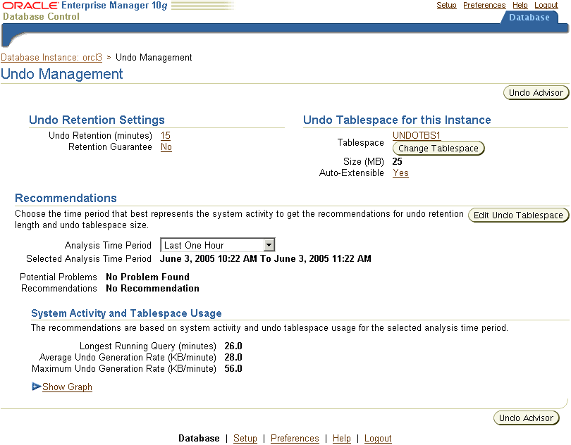

With Enterprise Manager, you can manage undo as follows:
From the Database Control home page, click Administration.
The Administration property page appears.
In the Database Configuration section, click Undo Management.
The Undo Management page appears, as shown in Figure 6-5.
You can use the Undo Management page to view the following about your undo configuration:
Name and size of undo tablespace
Auto-extend tablespace setting
Auto-tuned undo retention period
Minimum retention period
In Undo Tablespace for this Instance, the Auto-Extensible field shows Yes if auto-extending the tablespace is enabled, which is the default. When the undo tablespace is auto-extensible, Oracle automatically increases the size of the tablespace when more space is needed. By combining automatic extension of the undo tablespace with automatically tuned undo retention, you can ensure that long-running queries succeed by guaranteeing the undo for such queries.
If you have a fixed-size tablespace, then you can use this page as a starting point for determining space requirements and extending the tablespace. See "Using the Undo Advisor".
The Undo Retention Settings section describes your minimum undo retention period. While Oracle automatically tunes the undo retention period, minimum undo retention enables you to define the lowest value allowable for your database. When you create a database, the minimum undo retention is set to a default value. You might need to alter this value to build a recovery strategy using Flashback Query. See "Setting Minimum Undo Retention Time".
The Recommendations section of the Undo Management page gives you recommendations on undo tablespace size based on your system activity. Recommendations and alerts can arise when you are using a fixed-size tablespace and queries have been failing because of insufficient undo space. On rarer occasions, when using an auto-extend tablespace, the same recommendations can arise if the system has reached it maximum disk limit.
If Oracle recommends that you extend the undo tablespace, then you can use the Undo Advisor to determine a better size.

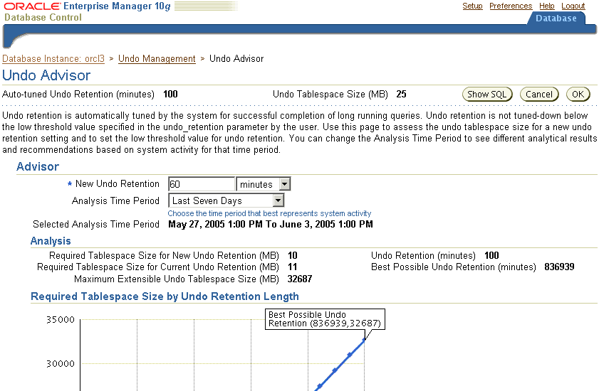

The amount of undo data that can be retained depends on the size of your undo tablespace. If your tablespace is set to auto-extend, then Oracle automatically acquires space as needed. If you choose to disable auto-extend, however, then you are responsible for ensuring that the undo tablespace has enough space. In this situation, Oracle configures the undo retention to the maximum possible value for that tablespace size.
The Undo Advisor helps you analyze various scenarios to determine an appropriate undo tablespace size for different values of maximum undo retention. This analysis might be required in the following situations:
You have a fixed-sized tablespace (auto-extend disabled) and the auto-tuned value of undo retention is not large enough to prevent queries from failing. The Undo Advisor can help you determine a better tablespace size to ensure successful completion of your queries. See "Gaining Advice from Undo Advisor".
You use Flashback features such as Flashback Query or Flashback Table. For Flashback operations to go back in time, the database must ensure that undo data is not overwritten.
To build a flashback recovery strategy, you can set the minimum undo retention, which determines the lowest value for automatic undo tuning. For example, if the low threshold is set to 15 minutes, then Oracle never lowers the undo retention time to less than 15 minutes. Consequently, if your flashback recovery strategy requires you to go back 8 hours to recover from human errors, then set the minimum undo retention to 8 hours. To learn how to set a new retention time, see "Setting Minimum Undo Retention Time"
The Undo Advisor can help you determine a better size for your undo tablespace to ensure successful completion of queries. Follow these general steps to determine the required new size of your tablespace:
Determine the duration of your longest running query according to your application characteristics. If this duration is longer than the tuned retention, then these long-running queries will encounter an error. In this case, your undo tablespace is too small. You need to either set your tablespace to auto-extend or manually extend it.
In the Database Configuration section of the Administration page, click Undo Management.
Click Undo Advisor.
The Undo Advisor page appears. The top of the page shows the current auto-tuned undo retention time and undo tablespace size, as shown in Figure 6-6.
In the New Undo Retention field of the Advisor section, plug in the value of your longest-running query.
In the Analysis Time Period list, select a time period that best reflects your business cycle.
The Analysis section displays the Required Tablespace size for New Undo Retention.
For example, suppose we have a fixed size tablespace of 25 MB. We determine the longest running query is 60 minutes. We enter this number in the New Undo Retention field as shown in Figure 6-6. The advisor recommends 10 MB of space to accommodate this query. Because our tablespace is 25 MB, our undo tablespace is adequately configured.
Figure 6-6 Undo Advisor with Fixed-Sized Tablespace
Additionally, the Required Tablespace Size by Undo Retention Length graph shows the relationship between retention period and undo tablespace size, highlighting key data points such as the Auto-tuned Undo Retention and Best Possible Undo Retention.
