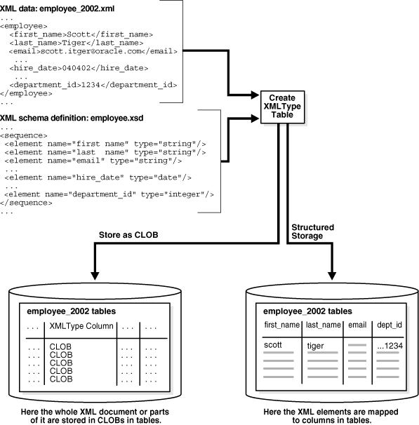

Using XML Schema with Oracle XML DB provides a flexible setup for XML storage mapping. For example:
If your data is highly structured (mostly XML), then each element in the XML documents can be stored as a column in a table.
If your data is unstructured (all or most is not XML data), then the data can be stored in a Character Large Object (CLOB).
Which storage method you choose depends on how your data will be used and depends on the queriability and your requirements for querying and updating your data. In other words, using XML Schema gives you more flexibility for storing highly structured or unstructured data.

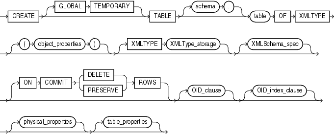

Using Oracle XML DB, developers can create XMLType tables and columns that are constrained to a global element defined by a registered XML schema. After an XMLType column has been constrained to a particular element and a particular XML schema, it can only contain documents that are compliant with the schema definition of that element. An XMLType table column is constrained to a particular element and a particular XML schema by adding the appropriate XMLSCHEMA and ELEMENT clauses to the CREATE TABLE operation.
Figure 5-1 shows the syntax for creating an XMLType table:
CREATE [GLOBAL TEMPORARY] TABLE [schema.] table OF XMLType [(object_properties)] [XMLType XMLType_storage] [XMLSchema_spec] [ON COMMIT {DELETE | PRESERVE} ROWS] [OID_clause] [OID_index_clause] [physical_properties] [table_properties];
A subset of the XPointer notation, shown in the following example, can also be used to provide a single URL containing the XML schema location and element name. See also Chapter 4, "XMLType Operations".

The data associated with an XMLType table or column that is constrained to an XML schema can be stored in two different ways:
The default storage model is structured storage. To override this behavior, and store the entire XML document as a single LOB column, use the STORE AS CLOB clause.
Example 5-11 Specifying CLOB Storage for Schema-Based XMLType Tables and Columns
This example shows how to create an XMLType table and a table with an XMLType column, where the contents of the XMLType are constrained to a global element defined by a registered XML schema, and the contents of the XMLType are stored using a single LOB column.
CREATE TABLE purchaseorder_as_table OF XMLType XMLTYPE STORE AS CLOB XMLSCHEMA "http://xmlns.oracle.com/xdb/documentation/purchaseOrder.xsd" ELEMENT "PurchaseOrder"; CREATE TABLE purchaseorder_as_column (id NUMBER, xml_document XMLType) XMLTYPE COLUMN xml_document STORE AS CLOB XMLSCHEMA "http://xmlns.oracle.com/xdb/documentation/purchaseOrder.xsd" ELEMENT "PurchaseOrder";
You can add LOB storage parameters to the STORE AS CLOB clause.

Figure 5-2 shows how Oracle XML DB creates XML schema-based XMLType tables using an XML document and mapping specified in an XML schema.
Figure 5-2 How Oracle XML DB Maps XML Schema-Based XMLType Tables
An XMLType table is first created and depending on how the storage is specified in the XML schema, the XML document is mapped and stored either as a CLOB value in one XMLType column, or stored object-relationally and spread out across several columns in the table.

Figure 5-3 Mapping simpleType: XML Strings to SQL VARCHAR2 or CLOBs
