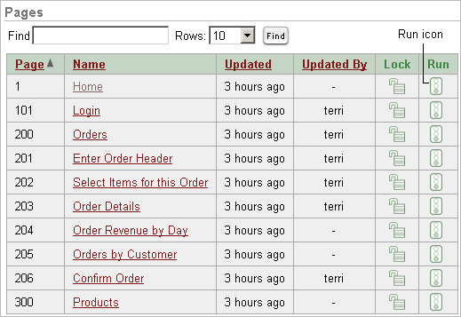

The HTML DB engine dynamically renders and process pages based on data stored in database tables. To view a rendered version of your application, you run or submit it to the HTML DB engine. As you create new pages you can run them individually, or run an entire application. You can run a page from numerous locations within Application Builder by clicking the Run icon. (See Figure 8-1.)
To run a specific page from the Pages list:
Navigate to the Workspace home page.
From the Applications list, select an application.
Application Builder appears. The list of pages for the selected application appears at the bottom of the page.
From the Pages list, locate the page you wish to run and click the Run button in the far right column.

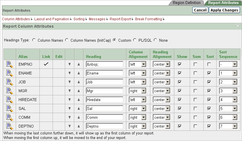

You can use the Report Attributes and Column Attributes pages to precisely control the look and feel of report pages. For example, you can use these attributes to alter column heading text, change column positioning, hide a column, create a sum of a column, or select a sort sequence.
On the Page Definition, you can access the Report Attributes page by clicking either Q or RPT adjacent to the report region you want to edit. Q indicates the report is a regular report and RPT indicates the report is an easy report. You can also navigate to the Report Attributes page by clicking the region name then selecting the Report Attributes tab.
To access the Report Attributes page:
From the Applications list, select the application.
Navigate to the appropriate Page Definition. (See "Viewing a Page Definition".)
Under Regions, click Q next to the name of the report region you want to edit.
The Report Attributes page appears.
Heading Type identifies how the heading was generated for the report. Use the Report Column Attributes section to control report column appearance and functionality. The Link column indicates whether a column link is currently defined. The Edit column indicates whether or not a column is currently updatable. The Edit column.
Table 8-1 describes common report column edits.
Table 8-1 Common Report Column Edits
| Description | Developer Action |
| Alter column display sequence. | Click the up and down arrows. |
| Alter heading alignment. | Under Column Alignment, select a new column alignment. |
| Change column heading text. | Under Heading, enter a different heading text. |
| Control which columns display. | Click Show to indicate a column should display. |
| Enable an unique sort sequence. | Click Sort and select a sequence number from Sort Sequence. |
| Enable the sum of a column. | Click Sum to enable the sum of a column. |

You enable column sorting on the Report Attributes page.
To enable column sorting:
Navigate to the Report Attributes page. (See "Editing Report Attributes".)
Under Report Column Attributes, select the Sort check box adjacent to the columns to be sorted.
From Sort Sequence, select a sequence number.
Sort Sequence is optional. However, if there are one or more sort enabled columns, then at least one column needs a defined Sort Sequence.
Scroll down to Sorting.
Specify ascending and descending image attributes or click set defaults.
