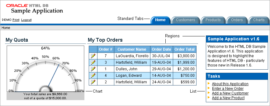

A page is the basic building block of an application. When you build an application in Application Builder, you create pages that contain user interface elements, such tabs, lists, buttons, items, and regions. Figure 6-2 illustrates the use of some of these elements in a running application.
You add components and layout controls to a page on the Page Definition.

Shared components are common elements that can display on every page within an application. Examples of shared layout controls include:
A list is a collection of links that is rendered using a template. For each list entry, you specify display text, a target URL, and other attributes that control when and how the list entry displays. You control the display of the list and the appearance of all list entries by linking it to a template.
A list of values (LOV) is a static or dynamic definition used to display a specific type of page item, such as a radio group, check box, or select list. LOVs can be static (that is, based on a set of predefined display and return values) or dynamic (based on SQL queries that select values from tables).
You define LOVs at the application level by running the LOV Wizard and adding them to the Named List of Values repository.
A menu is a hierarchical list of links that is rendered using a template. For example, you can display menus as a list of links or as a breadcrumb path.
Use navigation bars to link users to various pages within an application. Typically navigation bars are used to enable users to log in and log out or link to help text. The location of a navigation bar depends upon the associated page template. A navigation bar icon enables you to display a link from an image or text. When you create a navigation bar icon you can specify an image name, text, a display sequence, and a target location (a URL or page).
Tabs are an effective way to navigate users between pages of an application. Application Builder includes two different types of tabs: standard tabs and parent tabs
An application having only one level of tabs uses a standard tab set. A standard tab set is associated with a specific page. You can use standard tabs to link users to other pages within your application. A parent tab set functions as a container to hold a group of standard tabs. Parent tabs give users another level of navigation as well as a context (or sense of place) within the application.

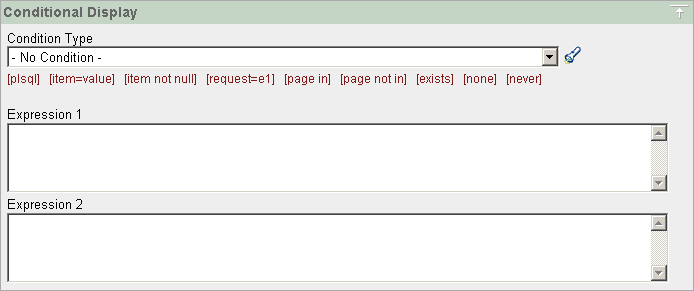

A condition is a small unit of logic that helps you control the display of regions, items, buttons, and tabs as well the execution of processes, computations, and validations. For example, when you apply a condition to a button, the rendering engine evaluates the condition during the rendering (or Show page) process. Whether the condition passes or fails determines whether the page control (such as a button) displays.
You specify a condition by selecting a condition type when you create the control or component (for example, the region, item, button, or tab) or by making a selection from the conditional display attribute. (See Figure 6-4.) The condition evaluates to true or false based on the values you enter in the Expression fields.
To view a complete listing of all available conditions for a given component or control click the View icon to the right of the Condition Type list. Shortcuts to common selections appear directly beneath the list. If your condition requires an expression, type it in the appropriate field.
The sections that follow offer examples of some commonly used condition types.
See Also: Appendix A, "Available Conditions" for a detailed listing of condition types available in Oracle HTML DB |
Current page = Expression 1 evaluates to true if the current page matches the page number listed in the Expression 1 field. For example:
100,101,102
If the current page is 100, 101, or 102, then this condition evaluates to true and the condition passes.
Exists (SQL query returns at least one row) is expressed as a SQL query. If the query returns at least one row, then the condition evaluates as true. For example:
SELECT 1 FROM emp WHERE deptno = :P101_DEPTNO
This example references item P101_DEPTNO as a bind variable. You can use bind variables within application processes and SQL query regions to reference item session state. If one or more employees are in the department identified by the value of P101_DEPTNO, then the condition evaluates as true.

To create an on-submit page process:
Under Conditional Display, select the condition type Request = Expression 1.
In Expression 1, enter GO.
