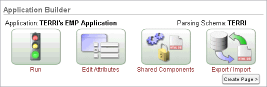

As shown in Figure 7-2, the top of the Application Builder home page displays the current application name and application ID, last update date, and parsing schema.
Click the one of the following to run the current application, edit application attributes, create shared components, export and import information, or create a new page:
Run submits the pages in the current application to the HTML DB engine to render viewable HTML
Edit Attributes displays the Edit Application Attributes page
Shared Components links to a new page for building shared application components and user interface controls

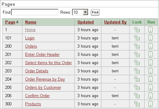

As shown in Figure 7-3, the Pages list displays at the bottom of the page. To access a specific page, select the page name. To search for a specific page number, enter a page number in the Find field and click Find. To view all pages in an application, leave the Find field blank and click Find.
A Tasks list displays on the right side of the page. It contains the following links:
Delete this Application enables you to delete the current application. (See "Deleting an Application".)
Manage Page Groups links to the Page Groups page. Make the pages within your application easier to access by organizing them into page groups. (See "Grouping Pages".)
Manage Page Locks links to the Locked Pages page. Locking pages in an application, prevents conflicts during application development. (See "Locking and Unlocking Page".)
View Application Reports displays links to summary application reports. (See "Viewing Application Reports".)

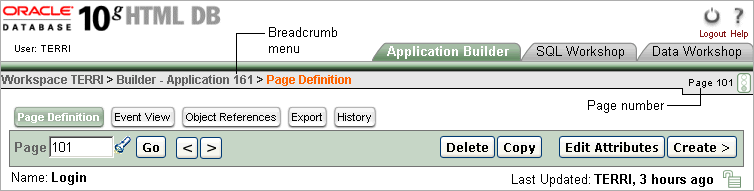

As shown in Figure 7-5, the Page Definition appears.
As shown in Figure 7-6, a breadcrumb menu displays at the top of each Page Definition. Breadcrumb menus appear on every page in Oracle HTML DB. Each menu entry indicates your location relative to other pages in the current application and functions as a navigation path. You can instantly link to another page by clicking a breadcrumb menu entry.
The current page number displays on the far right side of the page, next to a small button that resembles a traffic light. Clicking this button to runs the current page and renders it into viewable HTML.
A page navigation bar appears next. (See Figure 7-6.) Options available on the page navigation bar include:
Page. This field displays the current page number. To access another page directly, enter a page number and click Go. To access the previous or next page number, click the arrow buttons.
Copy. Creates a copy of the selected page within the current application.
Edit Attributes. Links to Page Attributes. Use this page to edit high-level page attributes such as the page name, an optional name alias, and view information about defined tab sets, specified templates, and authorization schemes.
The page name and last update date appear next.

You can view, create, and edit the controls and components that define a page by accessing the Page Definition.
To view the Page Definition for an existing page:
Navigate to the Workspace home page.
From the Applications list, select an application.
Application Builder appears. The list of pages for the selected application appears at the bottom of the page.
From the Pages list, select a page name.
The Page Definition appears.
Each Page Definition serves a a central navigation point for all the controls, components, and application logic that defines a page.
You can access a summary view of all defined controls or components by selecting the title (for example, Regions, Button, Items, Computations, Processes, and so on). For example, selecting Regions displays a summary report of all currently defined regions on the current page. Use this summary view to:
Edit the multiple attributes at once by making new selections from the available fields and select lists
Link to a definition page by clicking the Edit icon
You can access additional summary views by clicking the buttons at the top of each page. To save your edits to any summary view, click Apply Changes.
You can also view the attributes of a specific control or component by selecting its name on the Page Definition. For example, if your Page Definition contained a region named Customers, clicking the region name displays an attribute page for that region.
You can copy or create new controls or components by clicking the Copy and Create icons. (See Figure 7-8.) The Copy icon resembles two small overlapping pages. The Create icon consists of a plus (+) sign overlapping a small page. Click the Copy icon to make a copy of the current control or component. Click the Create icon to create a new control or component.
