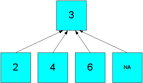

The Average operator calculates the average of all real data, producing an aggregate value of ((2 + 4 + 6)/3)=4, as shown in Figure 8-2.
Figure 8-2 Average Aggregation in a Simple Hierarchy

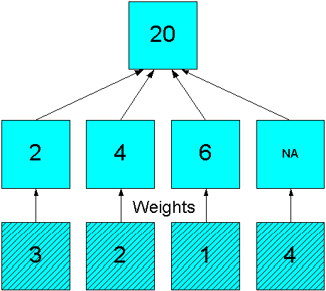

The weighted operators use the values in another measure to generate weighted values before performing the aggregation.Figure 8-4 shows how the simple sum of 12 in Figure 8-1 changes to 20 by using weights ((3*2) + (2*4) + (NA*6) +(4*NA)).
Figure 8-4 Weighted Sum Aggregation in a Simple Hierarchy

Weighted Average: Multiplies each data value by a weight factor, adds the data values, and then divides that result by the sum of the weight factors.
Weighted First: Multiplies the first non-null data value by its corresponding weight value.
Weighted Last: Multiplies the last non-null data value by its corresponding weight value.
Weighted Sum: Multiplies each data value by a weight factor, then adds the data values.

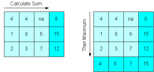

Even though you can use the Sum and Maximum operators alone without ordering the dimensions, you cannot use them together without specifying the order. The following figures show how they calculate different results depending on the order of aggregation. Figure 8-5 shows a cube with two dimensions. Sum is calculated first across one dimension of the cube, then Maximum is calculated down the other dimension.
Figure 8-5 Sum Method Followed by Maximum Method

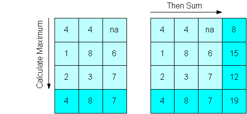

Figure 8-6 shows the same cube, except Maximum is calculated first down one dimension of the cube, then Sum is calculated across the other dimension. The maximum value of the sums in Figure 8-5 is 15, while the sum of the maximum values in Figure 8-6 is 19.
Figure 8-6 Max Method Followed by Sum Method

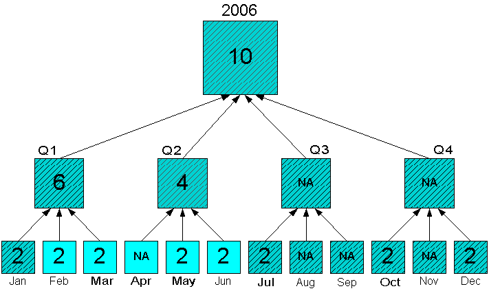

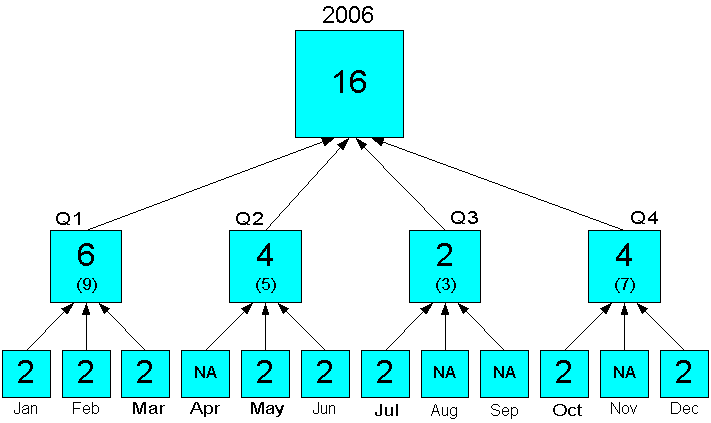

Figure 8-7 shows an aggregation in which the 12 months of 2006 are in status. Neither the quarters nor the year are in status, but aggregates are generated for all levels.
Figure 8-7 Sum Aggregation With All Source Values in Status
Figure 8-8 shows the same portion of data, but with only Feb to Jun in status. Aggregates are calculated only for Q1, Q2, and 2006. Note that Jan is included in the aggregation, even though it is out of status. The aggregation engine adds the ancestors, then the children to status before aggregating the data, as a means of maintaining the integrity of the data. The values for Q3 and Q4 are not included in the aggregation.
Figure 8-8 Sum Aggregation With Some Source Values Out of Status

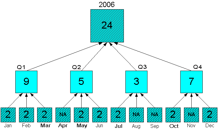

You may need to aggregate data that is stored in the middle of a hierarchy, perhaps if the data for a particular measure is not available or needed at the base level. You must be sure that the cells with the data are the lowest levels in the hierarchy in status. Figure 8-9 shows quarterly forecast data in status and aggregated to the year. The monthly values are not in status, and thus are excluded from the aggregation.
Figure 8-9 Sum Aggregation From the Quarterly Level

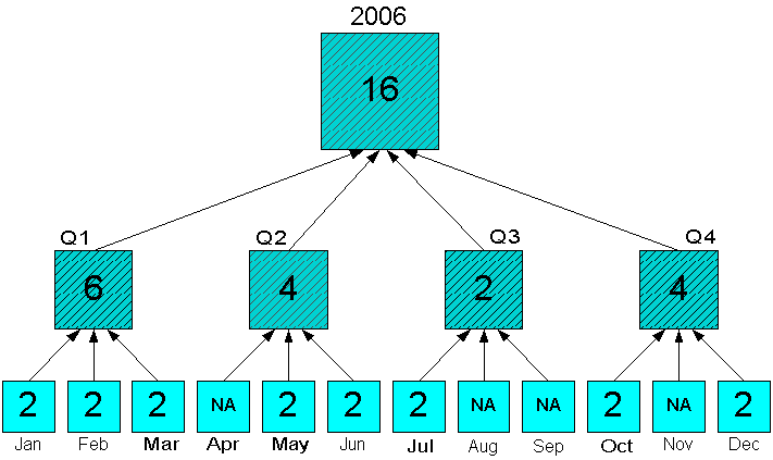

Aggregation begins at the lowest level in status and rolls up the hierarchy. The aggregate values overwrite any pre-existing values higher in the hierarchy. Figure 8-10 shows that when the Month level is in status, those values overwrite the forecast values at the Quarter level. The status of Quarter and Year has no effect on the aggregation.
Figure 8-10 Sum Aggregation From the Month Level Overwrites Quarters
