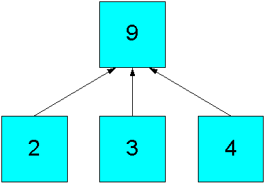

For example, consider the hierarchy in Figure 9-1. The value 9 is derived by aggregating the values 2, 3 and 4 using the Sum operator.
Figure 9-1 Aggregation in a Simple Hierarchy

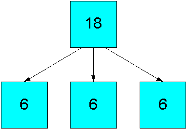

Now change the value of 9 to 18 and allocate the results to the children. The Even allocation operator divides the source value evenly by the number of children, and so assigns each child a value of 6, as shown in Figure 9-2.
Figure 9-2 Even Allocation In a Simple Hierarchy

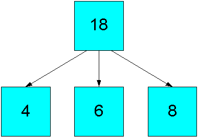

In contrast, the Proportional allocation operator divides the value into proportions based on the current value of each target cell, and so assigns values of 4, 6 and 8, as shown in Figure 9-3.
Figure 9-3 Proportional Allocation In a Simple Hierarchy

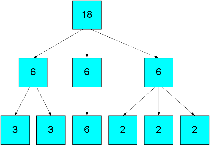

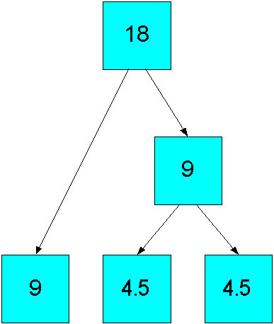

The previous examples show direct allocation, that is, where there is a parent-child relation between the source cell and the target cells. However, most hierarchies have multiple levels, and an allocation may assign values down the hierarchy, as shown in Figure 9-4.
Figure 9-4 Even Allocation in a Multilevel Hierarchy
Next, consider a skip level hierarchy. The source value is allocated down the hierarchy, as shown in Figure 9-5. The relationship of the target cell to the allocation source, not the hierarchical level of a cell, determines the allocation. Note that, as the result of an intermediate value in one branch, the base-level cells are allocated different values than in the simple hierarchy shown in Figure 9-2.
Figure 9-5 Even Allocation in a Skip Level Hierarchy

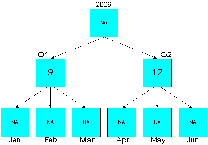

Figure 9-6 shows a portion of a Time hierarchy with the source allocation values at the Quarter level. How the allocation is performed depends on which members are selected (or in status). Table 9-1 describes various status settings and their effect on the allocation.
Figure 9-6 Allocating at the Quarter Level
Table 9-1 Results of Status on Allocation at the Quarter Level
| Status | Allocation | Explanation |
All |
None |
The top member of the hierarchy (2006) has no value, so there is no source value to allocate. |
All quarters |
None |
The children of Q1 and Q2 are not in status, so there is no target for allocation. |
All quarters, all months |
Jan to Jun |
Q1 and Q2 are in status, so the value 9 is allocated to Jan, Feb, and Mar, and the value 12 is allocated to Apr, May, and Jun. |
Q1, Jan to Mar |
Jan to Mar |
Q1 and its children are in status, so the value 9 is allocated to Jan, Feb, and Mar. Q2 is not in status and is not allocated. |

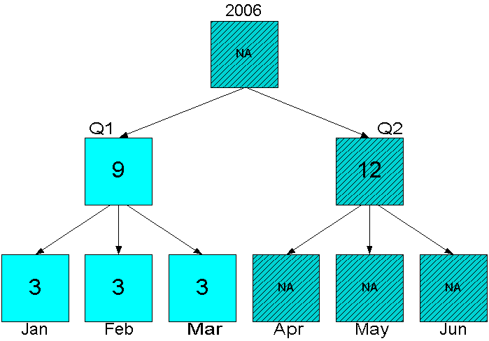

Figure 9-7 shows the correct status for allocating only Q1.
Figure 9-7 Status for Allocating One Mid-Level Branch of a Hierarchy

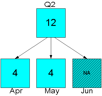

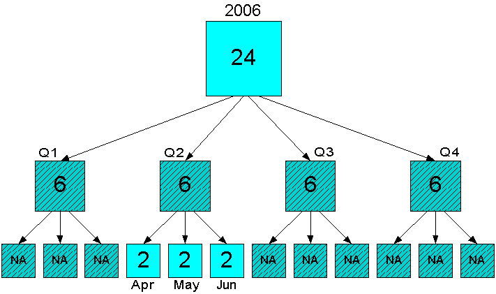

When the allocation path from the source to the target cells is not defined by the current status, the engine may populate the siblings of cells along the path. This information is important only if you want to avoid overwriting existing values or unnecessarily proliferating data.
Figure 9-9 shows the results of an allocation from 2006 to the three months in Q2. Only 2006, Apr, May, and Jun are in status. This status does not define a path from the source to the target. Because the Quarter level is on the path to the target, all of the quarters are allocated a value.
Figure 9-9 Even Allocation Without a Defined Allocation Path

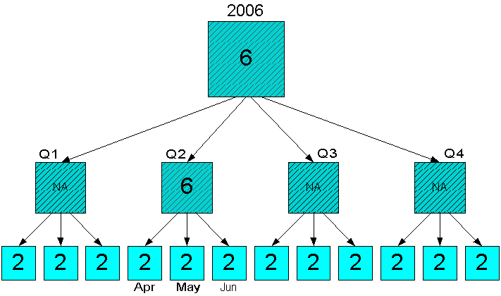

However, when Q2 is included in status, it is the only quarter to get an allocated value, as shown in Figure 9-10.
Figure 9-10 Even Allocation With a Defined Allocation Path

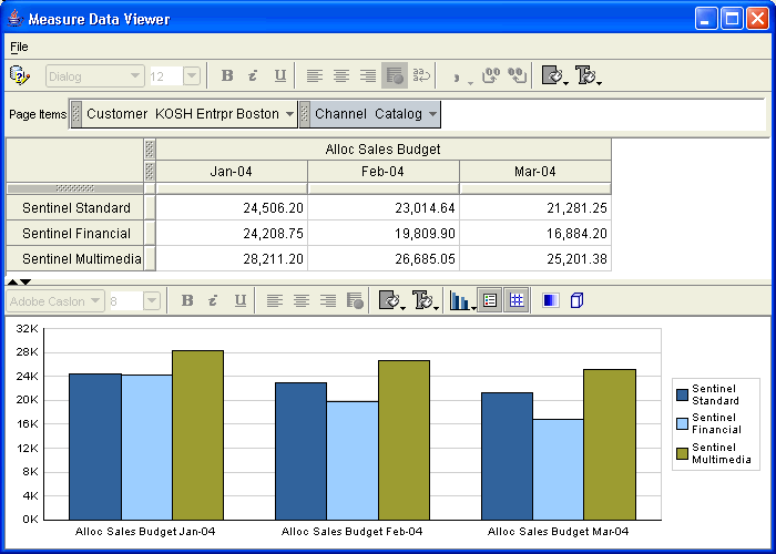

To view the allocation results, take these steps:
Fully expand the UNITS_CUBE folder, right-click the ALLOC_SALES_BUDGET measure, and choose View Data ALLOC_SALES_BUDGET.
The Measure Data Viewer opens. No data is displayed, because the top dimension levels provide the source data, not the allocated data.
From the File menu, choose Query Builder.
The Query Builder opens.
On the Layout tab, switch Product and Customer. Click Help for instructions.
On the Dimensions tab, set the status of all dimensions to the base level. You may wish to select just a few values from these lists. For Time, limit the months to 2004, since that it is only allocated year.
Click OK to close the Query Builder.

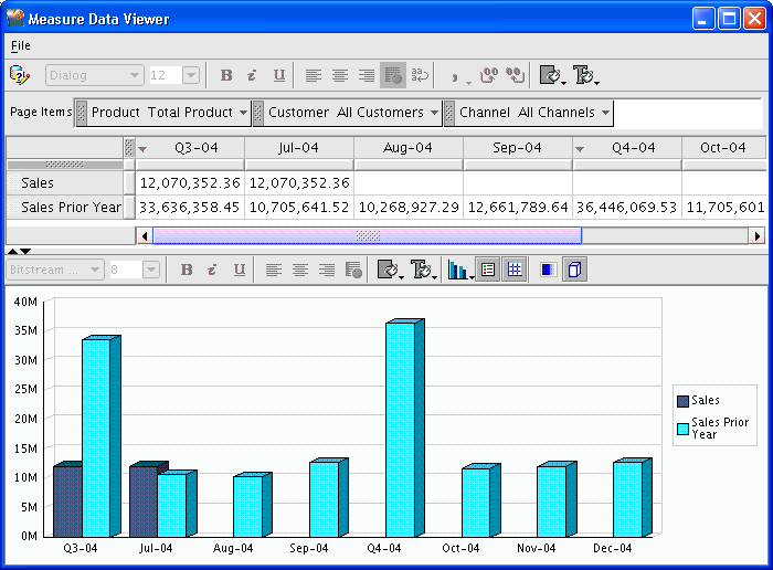

Always follow an Allocation Step with an Aggregation Step.Figure 9-11 shows a sample of the allocated data. The allocated data should be aggregated from these base levels to the top by an aggregation step.

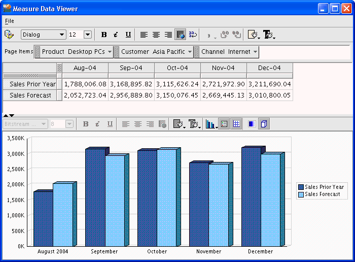

"Case Study: Forecasting Sales for Global Enterprises" generates a four-month Sales forecast from August 2004 to December 2005. The forecast data is at the Month level for Time, and at the topmost level for Product, Customer, and Channel. An allocation step distributes the forecast data down to the base levels of these three dimensions.
This example uses the Proportional method to distribute the values based on the sales performance for the previous year. The Proportional method uses another measure as the basis for the allocation. This example uses a calculated measure for sales values for the prior year as the basis measure. If you did not create Sales_PY for "Case Study: Allocating a Budget", you should do so now.
Figure 9-12 compares Prior Year Sales to Sales. The Prior Year Sales measure has data for the forecast periods, while the Sales measure does not.
Figure 9-12 Creating a Basis Measure for Allocating Forecast Data
The forecast created the data only for a single level of each dimension. Only Time is populated at the base level. The data must be allocated to the base levels of the other dimensions before it can be aggregated by the OLAP engine.

To view the allocation results, use the Measure Viewer to see the data in the Sales Forecast measure. The allocation populated all levels of Product, Customer, and Channel.
Figure 9-13 compares the forecast data with the basis measure at the middle levels of the dimensions used in the allocation.
Figure 9-13 Forecast Data After Allocation
