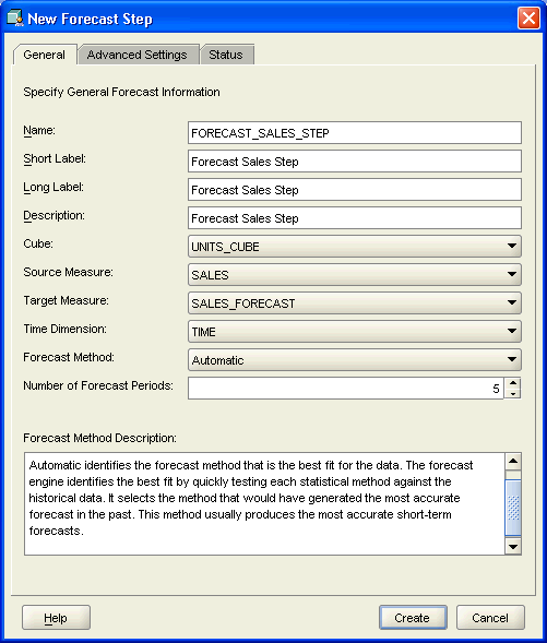

Complete the General page. For the forecast method, select Automatic.
For information about using other methods, refer to "Designing Your Own Forecast". For information about completing the other fields, click Help.

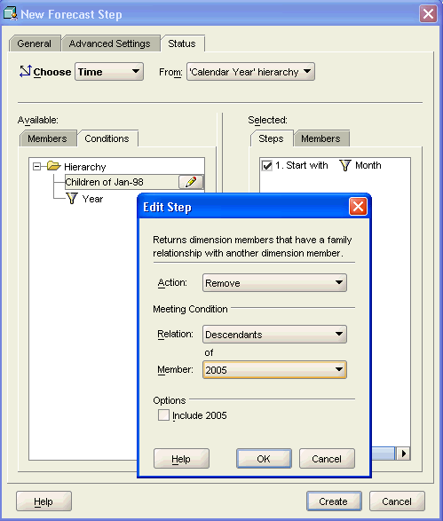

On the Status page, select the historical time periods and other dimension values to use as the basis for the forecast. Select only one level for each dimension.

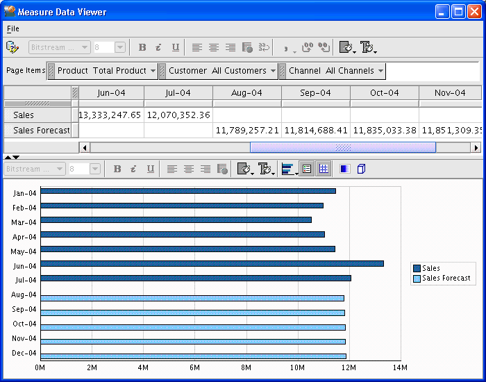

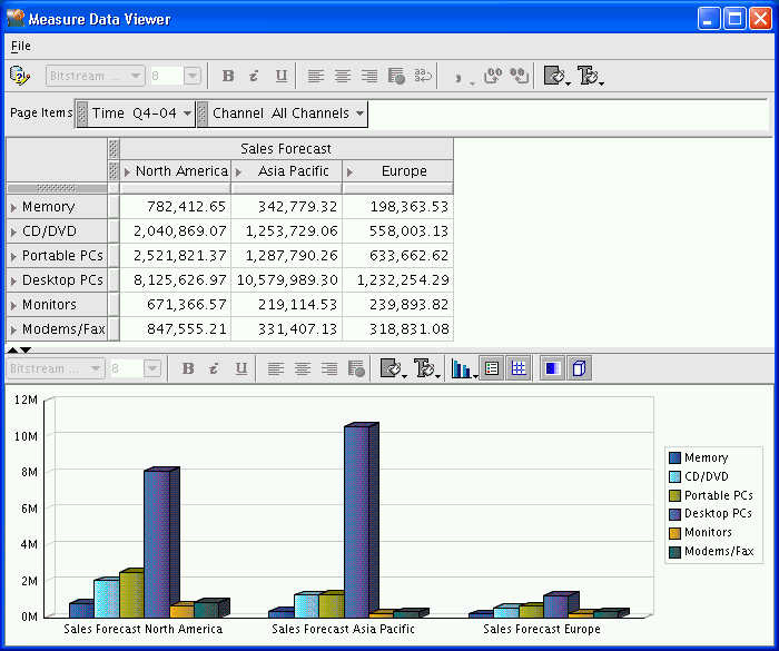

Afterward, you can view the forecast data in the Measure Viewer.
If the forecast does not initially look plausible to you, then check that there are no errors in the design of the forecast:
Compare the first few forecast periods to the last few historical periods to verify that a discrepancy exists.
Use the forecast step editor to check the number of forecast periods against the status of the Time dimension. The forecast periods are the last ones in status. For example, if the Time dimension has dimension members defined through the next five months and you designed a 4-month forecast, then you must remove the last month from status. Otherwise, the forecast is based on a month of null historical data.
Use the Measure Viewer to verify that all of the historical data has been loaded in the source measure. If several periods immediately prior to the forecast period are not loaded, then the forecast is 0.

On the General page of SALES_PLAN, click New Step, then select New Forecast Step.
The Create Forecast Step dialog box opens.
Complete the General page with these values, as shown in Figure 7-1
Cube: UNITS_CUBE
Source Measure: SALES
Target Measure: SALES_FORECAST
Time Dimension: TIME
Forecast Method: Automatic
Number of Forecast Periods: 5
Keep the default settings on the Advanced Parameters page.
On the Status page, set the Time dimension:
On the Selected Steps tab, click All Levels and select Month from the drop-down list.
On the Available Conditions tab, expand the Hierarchy folder. Select Children of Jan-98 and click the Edit Step icon.
The Edit Step dialog box opens, as shown in Figure 7-2.
Set Action to Remove, and set Relation to Descendants.
Click Member and choose More from the list.
The Select Members dialog box opens.
Select 2005.
Click OK to close the Select Members dialog box, then click OK to close the Edit Step dialog box.
Add this condition to the Selected Steps.
On the Members tab, verify that only months are in the list and Dec-04 is the last value.
Figure 7-2 Selecting Time Dimension Members

Fully expand the UNITS_CUBE folder, right-click the SALES_FORECAST measure, and choose View Data SALES_FORECAST.
The Measure Data Viewer opens. No data is displayed, because the base levels for Product, Customer, and Channel are NA.
From the File menu, choose Query Builder.
The Query Builder opens.
On the Items tab, add Sales to the Selected list.
On the Layout tab, arrange the dimensions so that Measure identifies the rows and Time identifies the columns. Click Help for instructions.
On the Dimensions tab, set the status of Time:
On the Steps tab, remove the initial selection.
On the Conditions tab, expand the Hierarchy folder.
Change Children of 1998 to Children of Q3-04, Q4-04, and add this condition to the Selected Steps.
On the Members tab, verify that only months are in the list from Jul-04 to Dec-04.
Click OK to close the Query Builder.
Figure 7-3 shows the results of the forecast, which are displayed in the Measure Viewer.
Figure 7-3 Forecast Data Displayed in the Measure Viewer

Allocate the forecast data down the Product, Customer, and Channel dimensions.
The forecast generated a single, top-level value for these dimensions. For the Time dimension, the forecast generated data at the detail Month level, so allocation is not possible.
Precompute some of the aggregate values to improve querying performance.
The measure is not mapped to a data source, so a refresh of the cube does not aggregate a forecast measure. The data is entirely aggregated on the fly unless you precompute some of the values in a separate step. A forecast measure can use the same rules as the other measures in the cube, but you must specify the rules in an Aggregation Step.
Add an Allocation Step to the Calculation Plan.
Add an Aggregation Step.
Run the Maintenance Wizard as described in "Generating the Forecast Data".
Figure 7-4 shows data in the middle levels of Time, Product, and Customer after allocation and aggregation of the forecast data.
