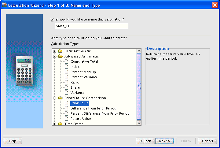

To create a calculated measure:
Expand the folder for the cube that contains the base measures that will be used in the calculation.
Right-click Calculated Measures, then choose Create Calculated Measure from the shortcut menu.
The Calculation Wizard Welcome page is displayed.
Follow the steps of the wizard.
Click Help for specific information about these choices. When you are done, the name of the new calculated measure appears as an item in the Calculated Measures folder.
Figure 6-1 displays the Name and Type page of the Calculation Wizard.

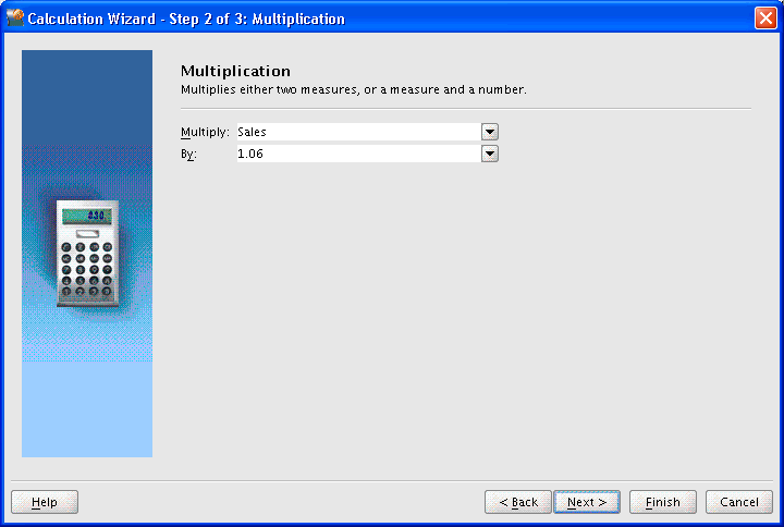

Basic arithmetic operations enable you to perform cell-by-cell calculations on two measures or a measure and a number, using addition, subtractions, multiplication, or division.
The Multiplication page defines a calculated measure using these parameters, as shown in Figure 6-2:
These are the results of a query against this calculated measure, which generates sales targets based on the results for the current year:
                      Sales    Sales Budget
Memory            5,272,678       5,589,038
CD/DVD           15,083,555      15,988,568
Portable PCs     19,155,814      20,305,162
Desktop PCs      67,900,544      71,974,577
Monitors          4,346,492       4,607,281
Modems/Fax        5,977,011       6,335,632

Prior and future time period calculations are an important gauge for detecting and analyzing trends. Oracle OLAP provides several calculations under Prior/Future Comparison:
Prior Value: Returns the value of a measure from an earlier time period.
Difference From Prior Period: Calculates the difference between values for the current time period and an earlier time period.
Percent Difference From Prior Period: Calculates the percent difference between values for the current time period and an earlier time period.
Future Value: Returns the value of a measure from a later time period.
When creating a calculation for prior or future time periods, you choose the measure, the time dimension, the hierarchy, and the distance from the current period. The distance can be calculated as any of the following:
Year Ago
Period Ago
Number of Years, Quarters, Months, Weeks, or Days
The Prior Value page defines a calculated measure using these parameters:
These are the results of a query against this calculated measure. The Prior Period column shows the value of Sales for the preceding period at the same level in the Calendar Year hierarchy.
              Sales               Prior Period
2002             92,515,295          116,931,479
  Q1-02          21,499,270           31,846,054
  Q2-02          22,586,748           21,499,270
  Q3-02          23,845,942           22,586,748
  Q4-02          24,583,335           23,845,942
2003            130,276,515           92,515,295
  Q1-03          26,946,411           24,583,335
  Q2-03          33,247,676           26,946,411
  Q3-03          33,636,358           33,247,676
  Q4-03          36,446,070           33,636,358

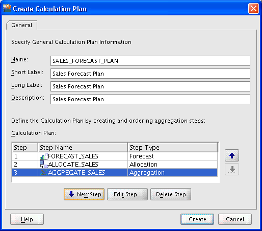

Analytic Workspace Manager provides the tools for generating advanced analytic content:

Chapter 8, "Advanced Aggregations"You create these types of calculations by developing a calculation plan. Calculation plans are composed of an ordered list of steps that generate additional analytical data. Each step performs a specific type of calculation. Unlike calculated measures, these steps generate data that is stored in the cube. By specifying the order in which these steps are performed, you can allow for interdependencies.
You execute calculation plans using the Maintenance Wizard, typically after loading and aggregating new data.
Expand the folder for the analytic workspace.
Right-click Calculation Plans, then choose Create Calculation Plan from the shortcut menu.
The Create Calculation Plan dialog box is displayed.
Complete the General tab.
To create a new step, click New Step.
Choose the type of step: Forecast, allocation, or aggregation.
The New Step dialog box is displayed for that type of calculation.
Complete all tabs, then click Create.
The new step is listed on the Calculation Plan General tab.
Click Create.
The new calculation plan appears as an item in the Calculation Plans folder.
To run the calculation plan:
Right-click it on the navigation tree and choose Execute Calculation Plan.
The Maintenance wizard opens.
Figure 6-3 shows the Create Calculation Plan dialog box with three steps defined.
