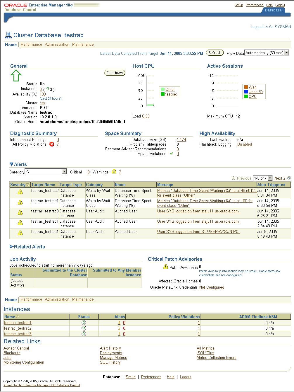

The Cluster Database Home page looks similar to a single-instance Database Control Home Page. However, on the Cluster Database Home page, Oracle Enterprise Manager displays the system state and availability of the entire RAC database. This includes a summary about alerts and job activity as well as links to all of the database and ASM instances.
The Cluster Database Home page shows the status as UP for any database instances that are running. The page shows the statuses for non-running instances as DOWN. You can start the non-running instances or stop the running instances as needed using the Startup and Shutdown buttons respectively that appear in the General section of the page.
Click the Performance tab to see detailed RAC database metrics. If critical or warning alerts appear in the Severity column, then you can analyze them by clicking directly on the alert.
The Alerts table is displayed under the metrics section on the Cluster Database Home Page. The Alerts table lists cluster-wide database alerts in order of severity, sorted by database components. For more information about an alert, click the text in the Message column. This takes you to the specific page that measures the system state of the process that triggered the alert.
On the Cluster Database Home Page level, you can select the Performance, Administration, and Maintenance tabs at the top of the page or you can select the same tabs from just above the Instances table. These three links enable you to perform clusterwide administration tasks. You can obtain help to understand the task options and metric definitions by clicking the Help link next to the Database tab. After you navigate to individual metrics displays, or to return to the Cluster Database Home Page, click the Database tab in the upper right-hand corner of the page.
