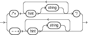

The following syntax diagram shows hints contained in both styles of comments that Oracle supports within a statement block. The hint syntax must follow immediately after an INSERT, UPDATE, DELETE, SELECT, or MERGE keyword that begins the statement block.
where:
The plus sign (+) causes Oracle to interpret the comment as a list of hints. The plus sign must follow immediately after the comment delimiter. No space is permitted.
hint is one of the hints discussed in this section. The space between the plus sign and the hint is optional. If the comment contains multiple hints, then separate the hints by at least one space.
string is other commenting text that can be interspersed with the hints.
The --+ syntax requires that the entire comment be on a single line.

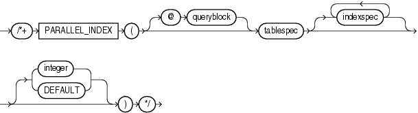

The PARALLEL_INDEX hint instructs the optimizer to use the specified number of concurrent servers to parallelize index range scans for partitioned indexes.
The integer value indicates the degree of parallelism for the specified index. Specifying DEFAULT or no value signifies that the query coordinator should examine the settings of the initialization parameters to determine the default degree of parallelism. For example, the following hint indicates three parallel execution processes are to be used:
SELECT /*+ PARALLEL_INDEX(table1, index1, 3) */
