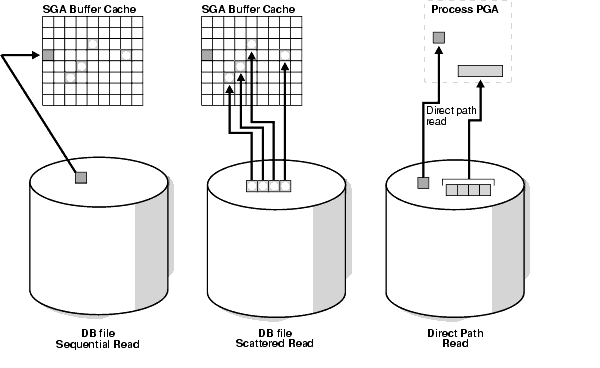

to see whether the top wait events are I/O related. I/O related events include db
file
sequential
read
, db
file
scattered
read
, db
file
single
write
, and db
file
parallel
write
, and log
file
parallel
write
. These are all events corresponding to I/Os performed against datafiles and log files. If any of these wait events correspond to high average time, then investigate the I/O contention.
Cross reference the host I/O system data with the I/O sections in the Automatic Repository report to identify hot datafiles and tablespaces. Also compare the I/O times reported by the operating system with the times reported by Oracle to see if they are consistent.
An I/O problem can also manifest itself with non-I/O related wait events. For example, the difficulty in finding a free buffer in the buffer cache or high wait times for log to be flushed to disk can also be symptoms of an I/O problem. Before investigating whether the I/O system should be reconfigured, determine if the load on the I/O system can be reduced. To reduce Oracle I/O load, look at SQL statements that perform many physical reads by querying the V$SQLAREA
view or by reviewing the 'SQL ordered by Reads' section of the Automatic Workload Repository report. Examine these statements to see how they can be tuned to reduce the number of I/Os.
If there are Oracle-related I/O problems caused by SQL statements, then tune them. If the Oracle server is not consuming the available I/O resources, then identify the process that is using up the I/O. Determine why the process is using up the I/O, and then tune this process.
See Also:
Oracle Database Reference for information about the dynamic performance V$SQLAREA
view
"db file scattered read" and "db file sequential read" for the difference between a scattered read and a sequential read, and how this affects I/O

read
, but it does not show which file and block number. However, V$SESSION_WAIT
shows the file number in P1
, the block number read in P2
, and the number of blocks read in P3
(P1
and P2
let you determine for which segments the wait event is occurring).

Figure 10-1 depicts the differences between the following wait events:
db
file
sequential
read
(single block read into one SGA buffer)
db
file
scattered
read
(multiblock read into many discontinuous SGA buffers)
direct
read
(single or multiblock read into the PGA, bypassing the SGA)
Figure 10-1 Scattered Read, Sequential Read, and Direct Path Read
When a session is reading buffers from disk directly into the PGA (opposed to the buffer cache in SGA), it waits on this event. If the I/O subsystem does not support asynchronous I/Os, then each wait corresponds to a physical read request.
If the I/O subsystem supports asynchronous I/O, then the process is able to overlap issuing read requests with processing the blocks already existing in the PGA. When the process attempts to access a block in the PGA that has not yet been read from disk, it then issues a wait call and updates the statistics for this event. Hence, the number of waits is not necessarily the same as the number of read requests (unlike db
file
scattered
read
and db
file
sequential
read
