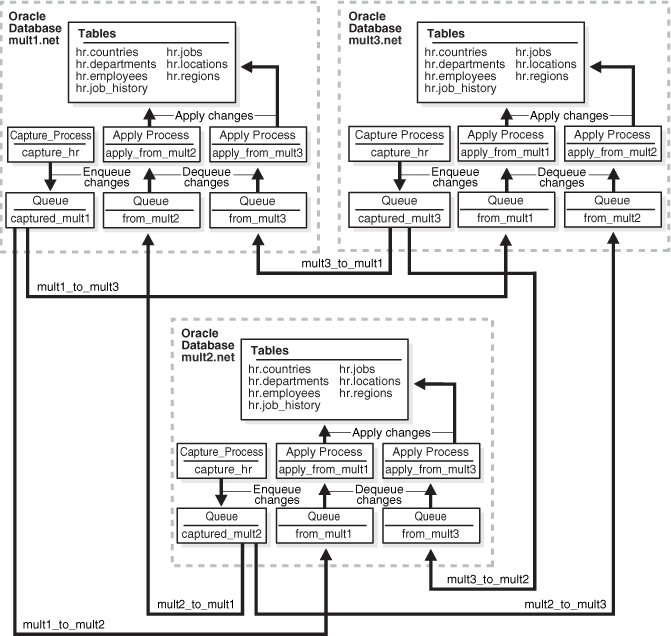

This example illustrates using Streams to replicate data for a schema among three Oracle databases. DML and DDL changes made to tables in the hr
schema are captured at all databases in the environment and propagated to each of the other databases in the environment.
Figure 20-1 provides an overview of the environment.
Figure 20-1 Sample Environment that Shares Data from Multiple Databases
As illustrated in Figure 20-1, all of the databases will contain the hr
schema when the example is complete. However, at the beginning of the example, the hr
schema exists only at mult1.net
. During the example, you instantiate the hr
schema at mult2.net
and mult3.net
In this example, Streams is used to perform the following series of actions:
After instantiation, the capture process at each database captures DML and DDL changes for all of the tables in the hr
schema and enqueues them into a local queue.
Propagations at each database propagate these changes to all of the other databases in the environment.
The apply processes at each database apply changes in the hr
schema received from the other databases in the environment.
This example avoids sending changes back to their source database by using the default apply tag for the apply processes. When you create an apply process, the changes applied by the apply process have redo entries with a tag of '00'
(double zero) by default. These changes are not recaptured because, by default, rules created by the DBMS_STREAMS_ADM
package have an is_null_tag()='Y'
condition by default, and this condition ensures that each capture process captures a change in a redo entry only if the tag for the redo entry is NULL

Complete the following steps to configure a Streams environment that shares information from multiple databases.
Create One Apply Process at mult1.net for Each Source Database
Specify hr as the Apply User for Each Apply Process at mult1.net
Grant the hr User Execute Privilege on the Apply Process Rule Set
Set the Instantiation SCN for mult2.net at the Other Databases
Create One Apply Process at mult2.net for Each Source Database
Specify hr as the Apply User for Each Apply Process at mult2.net
Set the Instantiation SCN for mult3.net at the Other Databases
Create One Apply Process at mult3.net for Each Source Database
Specify hr as the Apply User for Each Apply Process at mult3.net

Step 4 Create One Apply Process at mult1.net for Each Source Database
Configure mult1.net
to apply changes to the hr
schema at mult2.net
*/ BEGIN DBMS_STREAMS_ADM.ADD_SCHEMA_RULES( schema_name => 'hr', streams_type => 'apply', streams_name => 'apply_from_mult2', queue_name => 'strmadmin.from_mult2', include_dml => true, include_ddl => true, source_database => 'mult2.net', inclusion_rule => true); END; / /*
Configure mult1.net
schema at mult3.net
*/ BEGIN DBMS_STREAMS_ADM.ADD_SCHEMA_RULES( schema_name => 'hr', streams_type => 'apply', streams_name => 'apply_from_mult3', queue_name => 'strmadmin.from_mult3', include_dml => true, include_ddl => true, source_database => 'mult3.net', inclusion_rule => true); END; / /*
Step 5 Specify hr as the Apply User for Each Apply Process at mult1.net

Step 8 Configure Propagation at mult1.net
Configure and schedule propagation of DML and DDL changes in the hr
schema from the queue at mult1.net
to the queue at mult2.net
*/ BEGIN DBMS_STREAMS_ADM.ADD_SCHEMA_PROPAGATION_RULES( schema_name => 'hr', streams_name => 'mult1_to_mult2', source_queue_name => 'strmadmin.captured_mult1', destination_queue_name => 'strmadmin.from_mult1@mult2.net', include_dml => true, include_ddl => true, source_database => 'mult1.net', inclusion_rule => true, queue_to_queue => true); END; / /*
to the queue at mult3.net
*/ BEGIN DBMS_STREAMS_ADM.ADD_SCHEMA_PROPAGATION_RULES( schema_name => 'hr', streams_name => 'mult1_to_mult3', source_queue_name => 'strmadmin.captured_mult1', destination_queue_name => 'strmadmin.from_mult1@mult3.net', include_dml => true, include_ddl => true, source_database => 'mult1.net', inclusion_rule => true, queue_to_queue => true); END; / /*

Step 14 Configure Propagation at mult2.net
schema from the queue at mult2.net
to the queue at mult1.net
*/ BEGIN DBMS_STREAMS_ADM.ADD_SCHEMA_PROPAGATION_RULES( schema_name => 'hr', streams_name => 'mult2_to_mult1', source_queue_name => 'strmadmin.captured_mult2', destination_queue_name => 'strmadmin.from_mult2@mult1.net', include_dml => true, include_ddl => true, source_database => 'mult2.net', inclusion_rule => true, queue_to_queue => true); END; / /*
*/ BEGIN DBMS_STREAMS_ADM.ADD_SCHEMA_PROPAGATION_RULES( schema_name => 'hr', streams_name => 'mult2_to_mult3', source_queue_name => 'strmadmin.captured_mult2', destination_queue_name => 'strmadmin.from_mult2@mult3.net', include_dml => true, include_ddl => true, source_database => 'mult2.net', inclusion_rule => true, queue_to_queue => true); END; / /*
