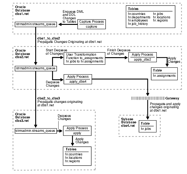

This example illustrates using Streams to replicate data between four databases. The environment is heterogeneous because three of the databases are Oracle databases and one is a Sybase database. DML and DDL changes made to tables in the hr
schema at the dbs1.net
Oracle database are captured and propagated to the other two Oracle databases. Only DML changes are captured and propagated to the dbs4.net
database, because an apply process cannot apply DDL changes to a non-Oracle database. Changes to the hr
schema occur only at dbs1.net
. The hr
schema is read-only at the other databases in the environment.
Figure 19-1 provides an overview of the environment.

This example uses directed networks, which means that captured changes at a source database are propagated to another database through one or more intermediate databases. Here, the dbs1.net
database propagates changes to the dbs3.net
database through the intermediate database dbs2.net
. This configuration is an example of queue forwarding in a directed network. Also, the dbs1.net
database propagates changes to the dbs2.net
database, which applies the changes directly to the dbs4.net
database through a gateway.

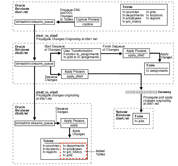

Some of the databases in the environment do not have certain tables. If the database is not an intermediate database for a table and the database does not contain the table, then changes to the table do not need to be propagated to that database. For example, the departments
, employees
, job_history
, and jobs
tables do not exist at dbs3.net
. Therefore, dbs2.net
does not propagate changes to these tables to dbs3.net
In this example, Streams is used to perform the following series of actions:
The capture process captures DML and DDL changes for all of the tables in the hr
schema and enqueues them into a queue at the dbs1.net
database. In this example, changes to only four of the seven tables are propagated to destination databases, but in the example that illustrates "Add Objects to an Existing Streams Replication Environment", the remaining tables in the hr
schema are added to a destination database.
The dbs1.net
database propagates these changes in the form of messages to a queue at dbs2.net
At dbs2.net
, DML changes to the jobs
table are transformed into DML changes for the assignments
table (which is a direct mapping of jobs
) and then applied. Changes to other tables in the hr
schema are not applied at dbs2.net
Because the queue at dbs3.net
receives changes from the queue at dbs2.net
that originated in countries
, locations
, and regions
tables at dbs1.net
, these changes are propagated from dbs2.net
to dbs3.net
. This configuration is an example of directed networks.
The apply process at dbs3.net
applies changes to the countries
, locations
, and regions
tables.
Because dbs4.net
, a Sybase database, receives changes from the queue at dbs2.net
to the jobs
table that originated at dbs1.net
, these changes are applied remotely from dbs2.net
using the dbs4.net
database link through a gateway. This configuration is an example of heterogeneous support.

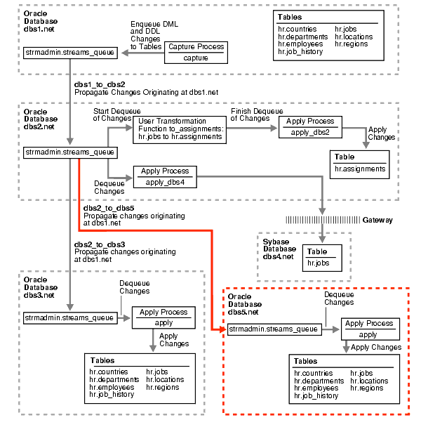

mode. In this example, changes are produced at dbs1.net
, and so dbs1.net
must be running in ARCHIVELOG
mode.

If you are viewing this document online, then you can copy the text from the "BEGINNING OF SCRIPT" line after this note to the next "END OF SCRIPT" line into a text editor and then edit the text to create a script for your environment. Run the script with SQL*Plus on a computer that can connect to all of the databases in the environment./************************* BEGINNING OF SCRIPT ******************************
Step 1 Show Output and Spool Results
Run SET
ECHO
ON
and specify the spool file for the script. Check the spool file for errors after you run this script.
*/ SET ECHO ON SPOOL streams_share_schema1.out /*
Step 2 Configure Propagation at dbs1.net
Connect to dbs1.net
as the strmadmin
user.
*/ CONNECT strmadmin/strmadminpw@dbs1.net /*
Configure and schedule propagation of DML and DDL changes in the hr
schema from the queue at dbs1.net
to the queue at dbs2.net
*/ BEGIN DBMS_STREAMS_ADM.ADD_SCHEMA_PROPAGATION_RULES( schema_name => 'hr', streams_name => 'dbs1_to_dbs2', source_queue_name => 'strmadmin.streams_queue', destination_queue_name => 'strmadmin.streams_queue@dbs2.net', include_dml => true, include_ddl => true, source_database => 'dbs1.net', inclusion_rule => true, queue_to_queue => true); END; / /*
Step 3 Configure the Capture Process at dbs1.net
Configure the capture process to capture changes to the entire hr
schema at dbs1.net
. This step specifies that changes to the tables in the specified schema are captured by the capture process and enqueued into the specified queue.
This step also prepares the hr
schema for instantiation and enables supplemental logging for any primary key, unique key, bitmap index, and foreign key columns in the tables in this schema. Supplemental logging places additional information in the redo log for changes made to tables. The apply process needs this extra information to perform certain operations, such as unique row identification and conflict resolution. Because dbs1.net
is the only database where changes are captured in this environment, it is the only database where you must specify supplemental logging for the tables in the hr
schema.
See Also:
*/ BEGIN DBMS_STREAMS_ADM.ADD_SCHEMA_RULES( schema_name => 'hr', streams_type => 'capture', streams_name => 'capture', queue_name => 'strmadmin.streams_queue', include_dml => true, include_ddl => true, inclusion_rule => true); END; / /*
Step 4 Set the Instantiation SCN for the Existing Tables at Other Databases
In this example, the hr.jobs
table already exists at dbs2.net
and dbs4.net
. At dbs2.net
, this table is named assignments
, but it has the same shape and data as the jobs
table at dbs1.net
. Also, in this example, dbs4.net
is a Sybase database. All of the other tables in the Streams environment are instantiated at the other destination databases using Data Pump import.
Because the hr.jobs
and dbs4.net
, this example uses the GET_SYSTEM_CHANGE_NUMBER
function in the DBMS_FLASHBACK
package at dbs1.net
to obtain the current SCN for the database. This SCN is used at dbs2.net
to run the SET_TABLE_INSTANTIATION_SCN
procedure in the DBMS_APPLY_ADM
package. Running this procedure twice sets the instantiation SCN for the hr.jobs
table at dbs2.net
and dbs4.net
The SET_TABLE_INSTANTIATION_SCN
procedure controls which LCRs for a table are ignored by an apply process and which LCRs for a table are applied by an apply process. If the commit SCN of an LCR for a table from a source database is less than or equal to the instantiation SCN for that table at a destination database, then the apply process at the destination database discards the LCR. Otherwise, the apply process applies the LCR.
In this example, both of the apply processes at dbs2.net
will apply transactions to the hr.jobs
table with SCNs that were committed after SCN obtained in this step.
This example assumes that the contents of thehr.jobs
table at dbs1.net
, dbs2.net
(as hr.assignments
), and dbs4.net
are consistent when you complete this step. You might want to lock the table at each database while you complete this step to ensure consistency.*/ DECLARE iscn NUMBER; -- Variable to hold instantiation SCN value BEGIN iscn := DBMS_FLASHBACK.GET_SYSTEM_CHANGE_NUMBER(); DBMS_APPLY_ADM.SET_TABLE_INSTANTIATION_SCN@DBS2.NET( source_object_name => 'hr.jobs', source_database_name => 'dbs1.net', instantiation_scn => iscn); DBMS_APPLY_ADM.SET_TABLE_INSTANTIATION_SCN@DBS2.NET( source_object_name => 'hr.jobs', source_database_name => 'dbs1.net', instantiation_scn => iscn, apply_database_link => 'dbs4.net'); END; / /*
Step 5 Instantiate the dbs1.net Tables at dbs3.net
This example performs a network Data Pump import of the following tables:
hr.countries
hr.locations
hr.regions
A network import means that Data Pump imports these tables from dbs1.net
without using an export dump file.
See Also:
Oracle Database Utilities for information about performing an importConnect to dbs3.net
as the strmadmin
user.
*/ CONNECT strmadmin/strmadminpw@dbs3.net /*
This example will do a table import using the DBMS_DATAPUMP
package. For simplicity, exceptions from any of the API calls will not be trapped. However, Oracle recommends that you define exception handlers and call GET_STATUS
to retrieve more detailed error information if a failure occurs. If you want to monitor the import, then query the DBA_DATAPUMP_JOBS
data dictionary view at the import database.
*/ SET SERVEROUTPUT ON DECLARE h1 NUMBER; -- Data Pump job handle sscn NUMBER; -- Variable to hold current source SCN job_state VARCHAR2(30); -- To keep track of job state js ku$_JobStatus; -- The job status from GET_STATUS sts ku$_Status; -- The status object returned by GET_STATUS job_not_exist exception; pragma exception_init(job_not_exist, -31626); BEGIN -- Create a (user-named) Data Pump job to do a table-level import. h1 := DBMS_DATAPUMP.OPEN( operation => 'IMPORT', job_mode => 'TABLE', remote_link => 'DBS1.NET', job_name => 'dp_sing1'); -- A metadata filter is used to specify the schema that owns the tables -- that will be imported. DBMS_DATAPUMP.METADATA_FILTER( handle => h1, name => 'SCHEMA_EXPR', value => '=''HR'''); -- A metadata filter is used to specify the tables that will be imported. DBMS_DATAPUMP.METADATA_FILTER( handle => h1, name => 'NAME_EXPR', value => 'IN(''COUNTRIES'', ''REGIONS'', ''LOCATIONS'')'); -- Get the current SCN of the source database, and set the FLASHBACK_SCN -- parameter to this value to ensure consistency between all of the -- objects included in the import. sscn := DBMS_FLASHBACK.GET_SYSTEM_CHANGE_NUMBER@dbs1.net(); DBMS_DATAPUMP.SET_PARAMETER( handle => h1, name => 'FLASHBACK_SCN', value => sscn); -- Start the job. DBMS_DATAPUMP.START_JOB(h1); -- The import job should be running. In the following loop, the job -- is monitored until it completes. job_state := 'UNDEFINED'; BEGIN WHILE (job_state != 'COMPLETED') AND (job_state != 'STOPPED') LOOP sts:=DBMS_DATAPUMP.GET_STATUS( handle => h1, mask => DBMS_DATAPUMP.KU$_STATUS_JOB_ERROR + DBMS_DATAPUMP.KU$_STATUS_JOB_STATUS + DBMS_DATAPUMP.KU$_STATUS_WIP, timeout => -1); js := sts.job_status; DBMS_LOCK.SLEEP(10); job_state := js.state; END LOOP; -- Gets an exception when job no longer exists EXCEPTION WHEN job_not_exist THEN DBMS_OUTPUT.PUT_LINE('Data Pump job has completed'); DBMS_OUTPUT.PUT_LINE('Instantiation SCN: ' ||sscn); END; END; / /*
Step 6 Configure the Apply Process at dbs3.net
Connect to dbs3.net
as the strmadmin
user.
Configure dbs3.net
to apply changes to the countries
table, locations
table, and regions
table.
*/ BEGIN DBMS_STREAMS_ADM.ADD_TABLE_RULES( table_name => 'hr.countries', streams_type => 'apply', streams_name => 'apply', queue_name => 'strmadmin.streams_queue', include_dml => true, include_ddl => true, source_database => 'dbs1.net', inclusion_rule => true); END; / BEGIN DBMS_STREAMS_ADM.ADD_TABLE_RULES( table_name => 'hr.locations', streams_type => 'apply', streams_name => 'apply', queue_name => 'strmadmin.streams_queue', include_dml => true, include_ddl => true, source_database => 'dbs1.net', inclusion_rule => true); END; / BEGIN DBMS_STREAMS_ADM.ADD_TABLE_RULES( table_name => 'hr.regions', streams_type => 'apply', streams_name => 'apply', queue_name => 'strmadmin.streams_queue', include_dml => true, include_ddl => true, source_database => 'dbs1.net', inclusion_rule => true); END; / /*
Step 7 Specify hr as the Apply User for the Apply Process at dbs3.net
user owns all of the database objects for which changes are applied by the apply process at this database. Therefore, hr
already has the necessary privileges to change these database objects, and it is convenient to make hr
the apply user.
When the apply process was created in the previous step, the Streams administrator strmadmin
was specified as the apply user by default, because strmadmin
ran the procedure that created the apply process. Instead of specifying hr as the apply user, you could retain strmadmin
as the apply user, but then you must grant strmadmin
privileges on all of the database objects for which changes are applied and privileges to execute all user procedures used by the apply process. In an environment where an apply process applies changes to database objects in multiple schemas, it might be more convenient to use the Streams administrator as the apply user.
See Also:
Oracle Streams Concepts and Administration for more information about configuring a Streams administrator*/ BEGIN DBMS_APPLY_ADM.ALTER_APPLY( apply_name => 'apply', apply_user => 'hr'); END; / /*
Step 8 Grant the hr User Execute Privilege on the Apply Process Rule Set
Because the hr
user was specified as the apply user in the previous step, the hr
user requires EXECUTE
privilege on the positive rule set used by the apply process
*/ DECLARE rs_name VARCHAR2(64); -- Variable to hold rule set name BEGIN SELECT RULE_SET_OWNER||'.'||RULE_SET_NAME INTO rs_name FROM DBA_APPLY WHERE APPLY_NAME='APPLY'; DBMS_RULE_ADM.GRANT_OBJECT_PRIVILEGE( privilege => SYS.DBMS_RULE_ADM.EXECUTE_ON_RULE_SET, object_name => rs_name, grantee => 'hr'); END; / /*
Step 9 Start the Apply Process at dbs3.net
Set the disable_on_error
parameter to n
so that the apply process will not be disabled if it encounters an error, and start the apply process at dbs3.net
*/ BEGIN DBMS_APPLY_ADM.SET_PARAMETER( apply_name => 'apply', parameter => 'disable_on_error', value => 'n'); END; / BEGIN DBMS_APPLY_ADM.START_APPLY( apply_name => 'apply'); END; / /*
Step 10 Configure Propagation at dbs2.net
Connect to dbs2.net
as the strmadmin
user.
*/ CONNECT strmadmin/strmadminpw@dbs2.net /*
Configure and schedule propagation from the queue at dbs2.net
to the queue at dbs3.net
. You must specify this propagation for each table that will apply changes at dbs3.net
. This configuration is an example of directed networks because the changes at dbs2.net
*/ BEGIN DBMS_STREAMS_ADM.ADD_TABLE_PROPAGATION_RULES( table_name => 'hr.countries', streams_name => 'dbs2_to_dbs3', source_queue_name => 'strmadmin.streams_queue', destination_queue_name => 'strmadmin.streams_queue@dbs3.net', include_dml => true, include_ddl => true, source_database => 'dbs1.net', inclusion_rule => true, queue_to_queue => true); END; / BEGIN DBMS_STREAMS_ADM.ADD_TABLE_PROPAGATION_RULES( table_name => 'hr.locations', streams_name => 'dbs2_to_dbs3', source_queue_name => 'strmadmin.streams_queue', destination_queue_name => 'strmadmin.streams_queue@dbs3.net', include_dml => true, include_ddl => true, source_database => 'dbs1.net', inclusion_rule => true); END; / BEGIN DBMS_STREAMS_ADM.ADD_TABLE_PROPAGATION_RULES( table_name => 'hr.regions', streams_name => 'dbs2_to_dbs3', source_queue_name => 'strmadmin.streams_queue', destination_queue_name => 'strmadmin.streams_queue@dbs3.net', include_dml => true, include_ddl => true, source_database => 'dbs1.net', inclusion_rule => true); END; / /*
Step 11 Create the Rule-Based Transformation for Row LCRs at dbs2.net
Connect to dbs2.net
as the hr
user.
*/ CONNECT hr/hr@dbs2.net /*
Create the rule-based transformation function that transforms row changes resulting from DML statements to the jobs
table from dbs1.net
into row changes to the assignments
table on dbs2.net
The following function transforms every row LCR for the jobs
table into a row LCR for the assignments
table.
If DDL changes were also applied to theassignments
table, then another transformation would be required for the DDL LCRs. This transformation would need to change the object name and the DDL text.*/ CREATE OR REPLACE FUNCTION hr.to_assignments_trans_dml( p_in_data in ANYDATA) RETURN ANYDATA IS out_data SYS.LCR$_ROW_RECORD; tc pls_integer; BEGIN -- Typecast AnyData to LCR$_ROW_RECORD tc := p_in_data.GetObject(out_data); IF out_data.GET_OBJECT_NAME() = 'JOBS' THEN -- Transform the in_data into the out_data out_data.SET_OBJECT_NAME('ASSIGNMENTS'); END IF; -- Convert to AnyData RETURN ANYDATA.ConvertObject(out_data); END; / /*
Step 12 Configure the Apply Process for Local Apply at dbs2.net
Connect to dbs2.net
as the strmadmin
user.
Configure dbs2.net
to apply changes to the assignments
table. Remember that the assignments
table receives changes from the jobs
table at dbs1.net
*/ DECLARE to_assignments_rulename_dml VARCHAR2(30); dummy_rule VARCHAR2(30); BEGIN -- DML changes to the jobs table from dbs1.net are applied to the assignments -- table. The to_assignments_rulename_dml variable is an out parameter -- in this call. DBMS_STREAMS_ADM.ADD_TABLE_RULES( table_name => 'hr.jobs', -- jobs, not assignments, specified streams_type => 'apply', streams_name => 'apply_dbs2', queue_name => 'strmadmin.streams_queue', include_dml => true, include_ddl => false, source_database => 'dbs1.net', dml_rule_name => to_assignments_rulename_dml, ddl_rule_name => dummy_rule, inclusion_rule => true); -- Modify the rule for the hr.jobs table to use the transformation function. DBMS_STREAMS_ADM.SET_RULE_TRANSFORM_FUNCTION( rule_name => to_assignments_rulename_dml, transform_function => 'hr.to_assignments_trans_dml'); END; / /*
Step 13 Specify hr as the Apply User for the Apply Process at dbs2.net
the apply user.
See Also:
Oracle Streams Concepts and Administration for more information about configuring a Streams administrator*/ BEGIN DBMS_APPLY_ADM.ALTER_APPLY( apply_name => 'apply_dbs2', apply_user => 'hr'); END; / /*
Step 14 Grant the hr User Execute Privilege on the Apply Process Rule Set
Because the hr
*/ DECLARE rs_name VARCHAR2(64); -- Variable to hold rule set name BEGIN SELECT RULE_SET_OWNER||'.'||RULE_SET_NAME INTO rs_name FROM DBA_APPLY WHERE APPLY_NAME='APPLY_DBS2'; DBMS_RULE_ADM.GRANT_OBJECT_PRIVILEGE( privilege => SYS.DBMS_RULE_ADM.EXECUTE_ON_RULE_SET, object_name => rs_name, grantee => 'hr'); END; / /*
Step 15 Start the Apply Process at dbs2.net for Local Apply
parameter to n
so that the apply process will not be disabled if it encounters an error, and start the apply process for local apply at dbs2.net
*/ BEGIN DBMS_APPLY_ADM.SET_PARAMETER( apply_name => 'apply_dbs2', parameter => 'disable_on_error', value => 'n'); END; / BEGIN DBMS_APPLY_ADM.START_APPLY( apply_name => 'apply_dbs2'); END; / /*
Step 16 Configure the Apply Process at dbs2.net for Apply at dbs4.net
Configure the apply process for dbs4.net
, which is a Sybase database. The dbs2.net
database is acting as a gateway to dbs4.net
. Therefore, the apply process for dbs4.net
must be configured at dbs2.net
. The apply process cannot apply DDL changes to non-Oracle databases. Therefore, the include_ddl
parameter is set to false
when the ADD_TABLE_RULES
procedure is run.
*/ BEGIN DBMS_APPLY_ADM.CREATE_APPLY( queue_name => 'strmadmin.streams_queue', apply_name => 'apply_dbs4', apply_database_link => 'dbs4.net', apply_captured => true); END; / BEGIN DBMS_STREAMS_ADM.ADD_TABLE_RULES( table_name => 'hr.jobs', streams_type => 'apply', streams_name => 'apply_dbs4', queue_name => 'strmadmin.streams_queue', include_dml => true, include_ddl => false, source_database => 'dbs1.net', inclusion_rule => true); END; / /*
Step 17 Start the Apply Process at dbs2.net for Apply at dbs4.net
parameter to n
so that the apply process will not be disabled if it encounters an error, and start the remote apply for Sybase using database link dbs4.net
*/ BEGIN DBMS_APPLY_ADM.SET_PARAMETER( apply_name => 'apply_dbs4', parameter => 'disable_on_error', value => 'n'); END; / BEGIN DBMS_APPLY_ADM.START_APPLY( apply_name => 'apply_dbs4'); END; / /*
Step 18 Start the Capture Process at dbs1.net
Connect to dbs1.net
as the strmadmin
user.
Start the capture process at dbs1.net
*/ BEGIN DBMS_CAPTURE_ADM.START_CAPTURE( capture_name => 'capture'); END; / /*
Step 19 Check the Spool Results
Check the streams_share_schema1.out
spool file to ensure that all actions finished successfully after this script is completed.
*/ SET ECHO OFF SPOOL OFF /*
You can now make DML and DDL changes to specific tables at dbs1.net
and see these changes replicated to the other databases in the environment based on the rules you configured for the Streams processes and propagations in this environment.
See Also:
"Make DML and DDL Changes to Tables in the hr Schema" for examples of changes that are replicated in this environment/*************************** END OF SCRIPT ******************************/
See Also:
After completing either of the examples described in "Example Scripts for Sharing Data from One Database", you can make DML and DDL changes to the tables in the hr
database. These changes will be replicated to the other databases in the environment based on the rules you configured for Streams processes and propagations. You can check the other databases to see that the changes have been replicated.
For example, complete the following steps to make DML changes to the hr.jobs
and hr.locations
tables at dbs1.net
. You can also make a DDL change to the hr.locations
table at dbs1.net
After you make these changes, you can query the hr.assignments
table at dbs2.net
to see that the DML change you made to this table at dbs1.net
has been replicated. Remember that a rule-based transformation configured for the apply process at dbs2.net
transforms DML changes to the hr.jobs
table into DML changes to the hr.assignments
table. You can also query the hr.locations
table at dbs3.net
to see that the DML and DDL changes you made to this table at dbs1.net

This example extends the Streams environment configured in the previous sections by adding replicated objects to an existing database. To complete this example, you must have completed the tasks in one of the previous examples in this chapter.
This example will add the following tables to the hr
schema in the dbs3.net
database:
departments
employees
job_history
jobs
When you complete this example, Streams processes changes to these tables with the following series of actions:
The capture process captures changes at dbs1.net
and enqueues them at dbs1.net
A propagation propagates changes from the queue at dbs1.net
A propagation propagates changes from the queue at dbs2.net
applies the changes at dbs3.net
When you complete this example, the hr
schema at the dbs3.net
database will have all of its original tables, because the countries
, locations
, and regions
tables were instantiated at dbs3.net
in the previous section.
Figure 19-2 provides an overview of the environment with the added tables.
Figure 19-2 Adding Objects to dbs3.net in the Environment
Complete the following steps to replicate these tables to the dbs3.net
database.

*/ BEGIN DBMS_STREAMS_ADM.ADD_TABLE_RULES( table_name => 'hr.departments', streams_type => 'apply', streams_name => 'apply', queue_name => 'strmadmin.streams_queue', include_dml => true, include_ddl => true, source_database => 'dbs1.net', inclusion_rule => true); END; / BEGIN DBMS_STREAMS_ADM.ADD_TABLE_RULES( table_name => 'hr.employees', streams_type => 'apply', streams_name => 'apply', queue_name => 'strmadmin.streams_queue', include_dml => true, include_ddl => true, source_database => 'dbs1.net', inclusion_rule => true); END; / BEGIN DBMS_STREAMS_ADM.ADD_TABLE_RULES( table_name => 'hr.job_history', streams_type => 'apply', streams_name => 'apply', queue_name => 'strmadmin.streams_queue', include_dml => true, include_ddl => true, source_database => 'dbs1.net', inclusion_rule => true); END; / BEGIN DBMS_STREAMS_ADM.ADD_TABLE_RULES( table_name => 'hr.jobs', streams_type => 'apply', streams_name => 'apply', queue_name => 'strmadmin.streams_queue', include_dml => true, include_ddl => true, source_database => 'dbs1.net', inclusion_rule => true); END; / /*
Step 4 Specify the Table Propagation Rules for the Added Tables at dbs2.net
Connect to dbs2.net
as the strmadmin
user.
Add the tables to the rules for propagation from the queue at dbs2.net
*/ BEGIN DBMS_STREAMS_ADM.ADD_TABLE_PROPAGATION_RULES( table_name => 'hr.departments', streams_name => 'dbs2_to_dbs3', source_queue_name => 'strmadmin.streams_queue', destination_queue_name => 'strmadmin.streams_queue@dbs3.net', include_dml => true, include_ddl => true, source_database => 'dbs1.net', inclusion_rule => true); END; / BEGIN DBMS_STREAMS_ADM.ADD_TABLE_PROPAGATION_RULES( table_name => 'hr.employees', streams_name => 'dbs2_to_dbs3', source_queue_name => 'strmadmin.streams_queue', destination_queue_name => 'strmadmin.streams_queue@dbs3.net', include_dml => true, include_ddl => true, source_database => 'dbs1.net', inclusion_rule => true); END; / BEGIN DBMS_STREAMS_ADM.ADD_TABLE_PROPAGATION_RULES( table_name => 'hr.job_history', streams_name => 'dbs2_to_dbs3', source_queue_name => 'strmadmin.streams_queue', destination_queue_name => 'strmadmin.streams_queue@dbs3.net', include_dml => true, include_ddl => true, source_database => 'dbs1.net', inclusion_rule => true); END; / BEGIN DBMS_STREAMS_ADM.ADD_TABLE_PROPAGATION_RULES( table_name => 'hr.jobs', streams_name => 'dbs2_to_dbs3', source_queue_name => 'strmadmin.streams_queue', destination_queue_name => 'strmadmin.streams_queue@dbs3.net', include_dml => true, include_ddl => true, source_database => 'dbs1.net', inclusion_rule => true); END; / /*

After completing the examples described in the "Add Objects to an Existing Streams Replication Environment" section, you can make DML and DDL changes to the tables in the hr
database. These changes will be replicated to dbs3.net
. You can check these tables at dbs3.net

This example extends the Streams environment configured in the previous sections by adding an additional database to the existing configuration. In this example, an existing Oracle database named dbs5.net
is added to receive changes to the entire hr
schema from the queue at dbs2.net
Figure 19-3 provides an overview of the environment with the added database.
Figure 19-3 Adding the dbs5.net Oracle Database to the Environment
