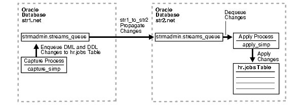

Figure 18-1 provides an overview of the environment.
Figure 18-1 Simple Example that Shares Data from a Single-Source Database
